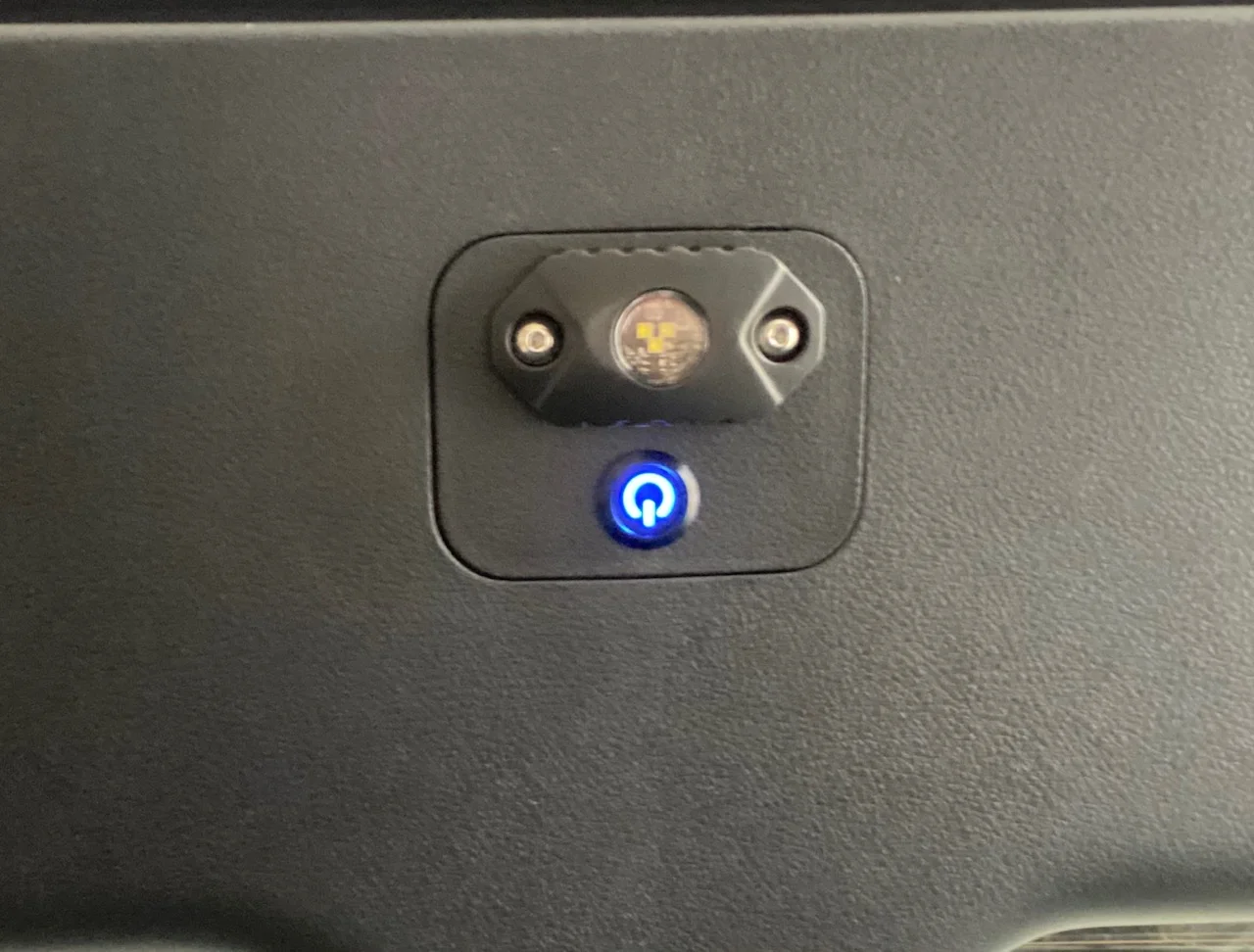

My first mod that I was able to find in stock came all the way from Australia from a fellow forum member @Brendan. He makes a light kit for your rear hatch shown on other threads.
I received it from Australia in a couple of weeks. 2 Minute install, no splicing plug and play. Worst part was scraping my fat hands fishing the wires into the hatch. You could probably build something like this, but it was worth the cost for the time savings and to have the unit set up with correct plugs already mounted to the access plate.

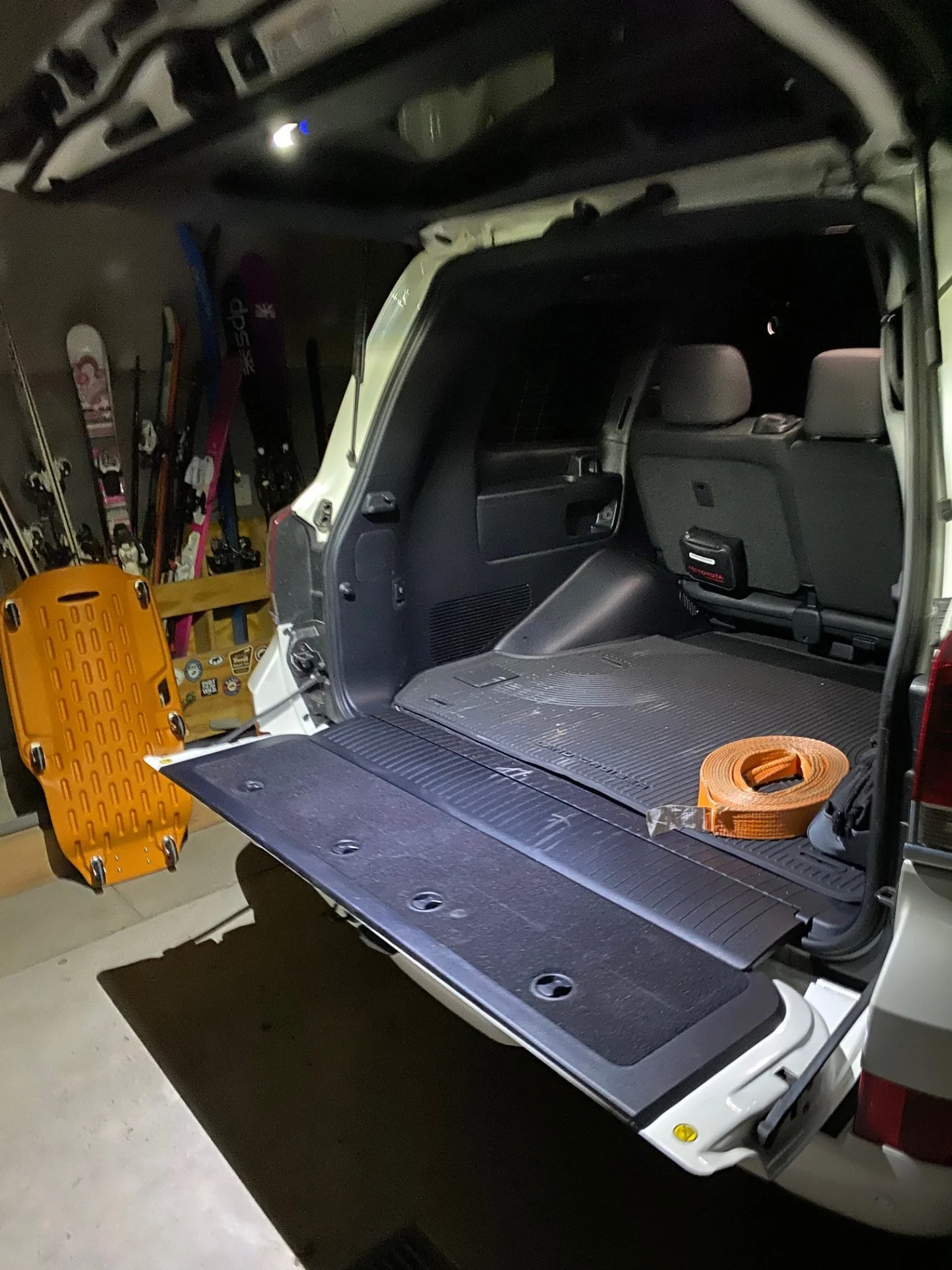

Light really lights up the tailgate area and is really handy when hooking up a trailer too.

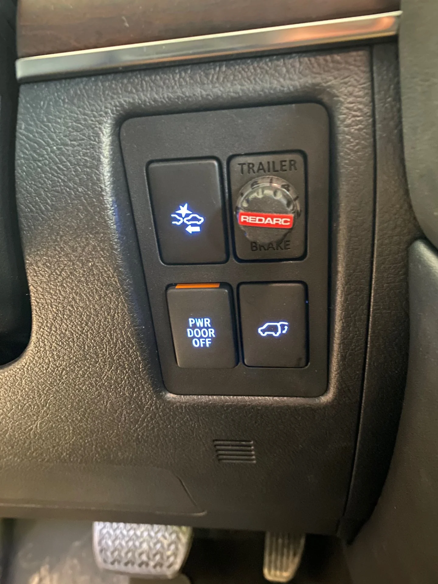

Also was able to get the trailer brake controller kit and switch blank from Redarc. Install was quite simple. I installed on the right side of the steering wheel because that is where it has always been in my trucks. But i had to use the only switch blank there which i hoped to use for additional USB chargers, so I guess I'll have to figure out something else for that.

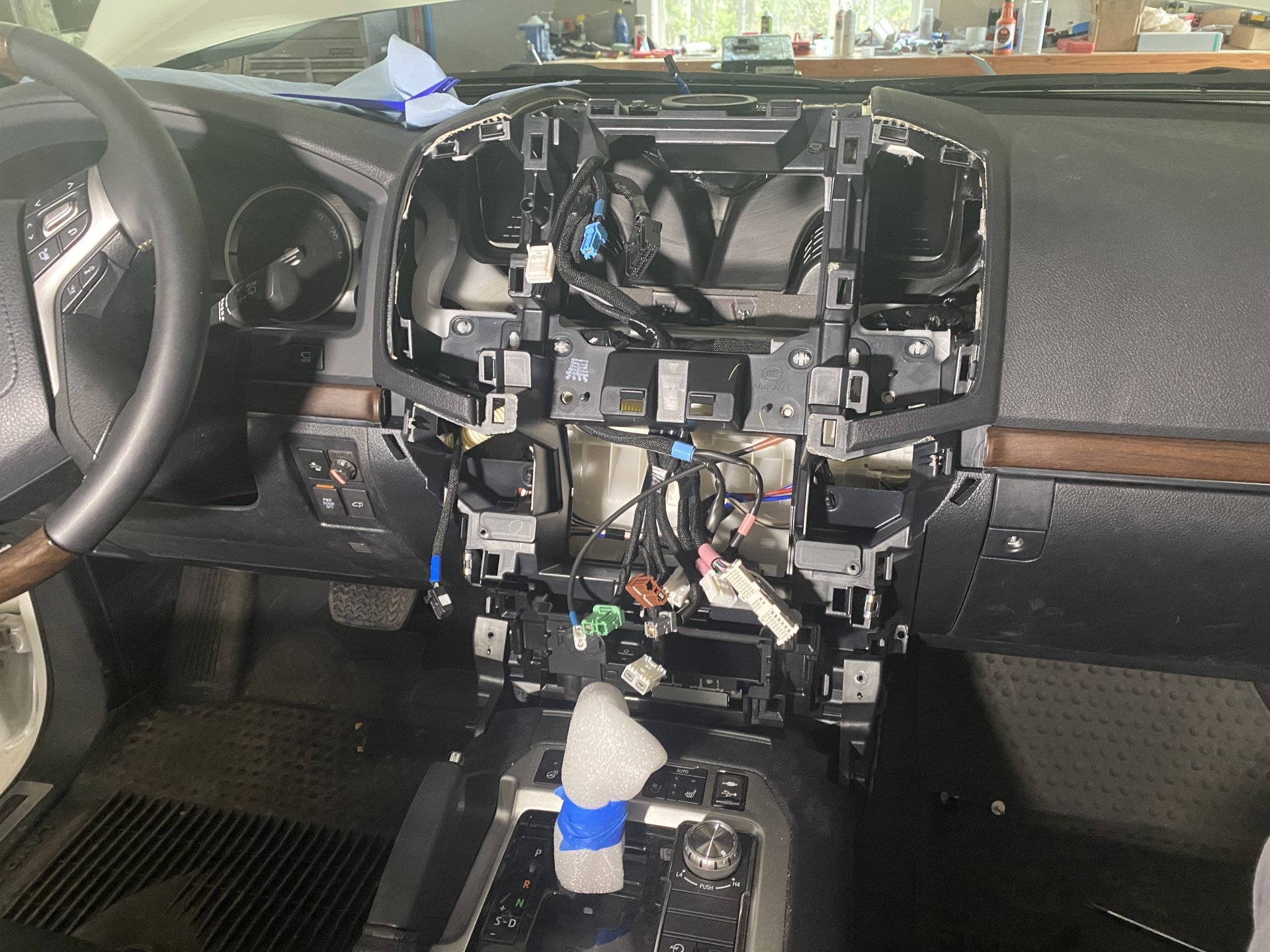

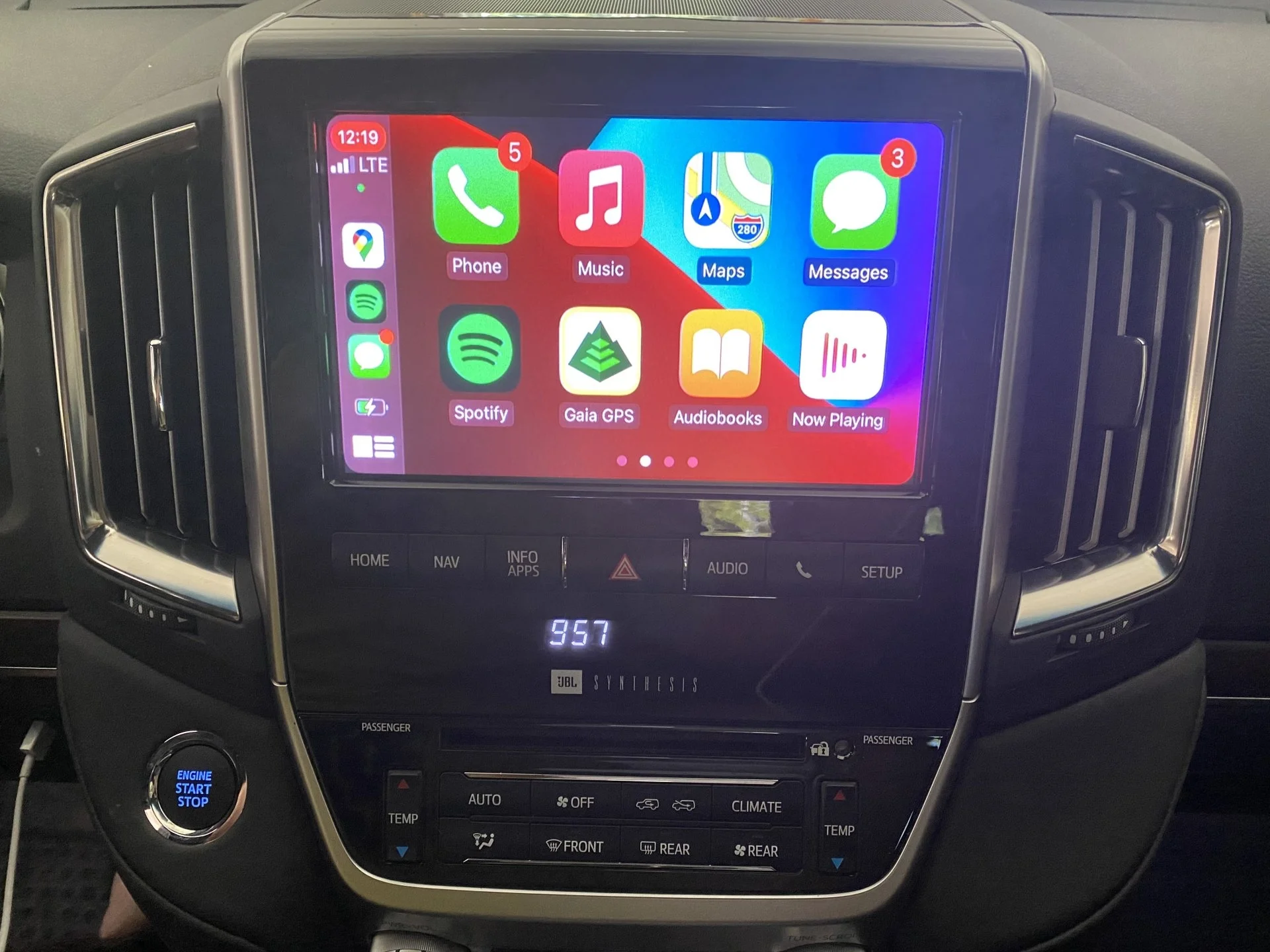

Installed a Naviplus unit with steering controls and wireless add on. Installation was pretty straightforward and it seems like everything works. One bummer is that I had to move my red arc trailer brake controller to the left of the steering wheel so that I could use that blank for the USB port required for wired CarPlay.
I was pretty intimidated about running the mic up by the rear view mirror like I have seen done, it actually was pretty easy using to panel pry tools to pry and stuff inside the headliner. Overall no big deal, but a time consuming install. I like the simplicity of CarPlay for communication and use of Spotify so I’m glad this kit was available. It will be cool to have Gaia maps on the big screen too.

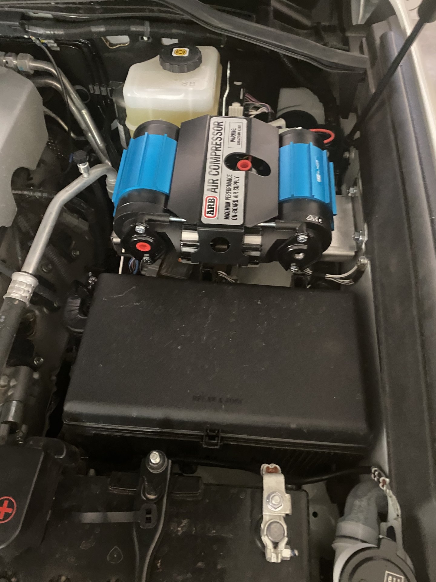

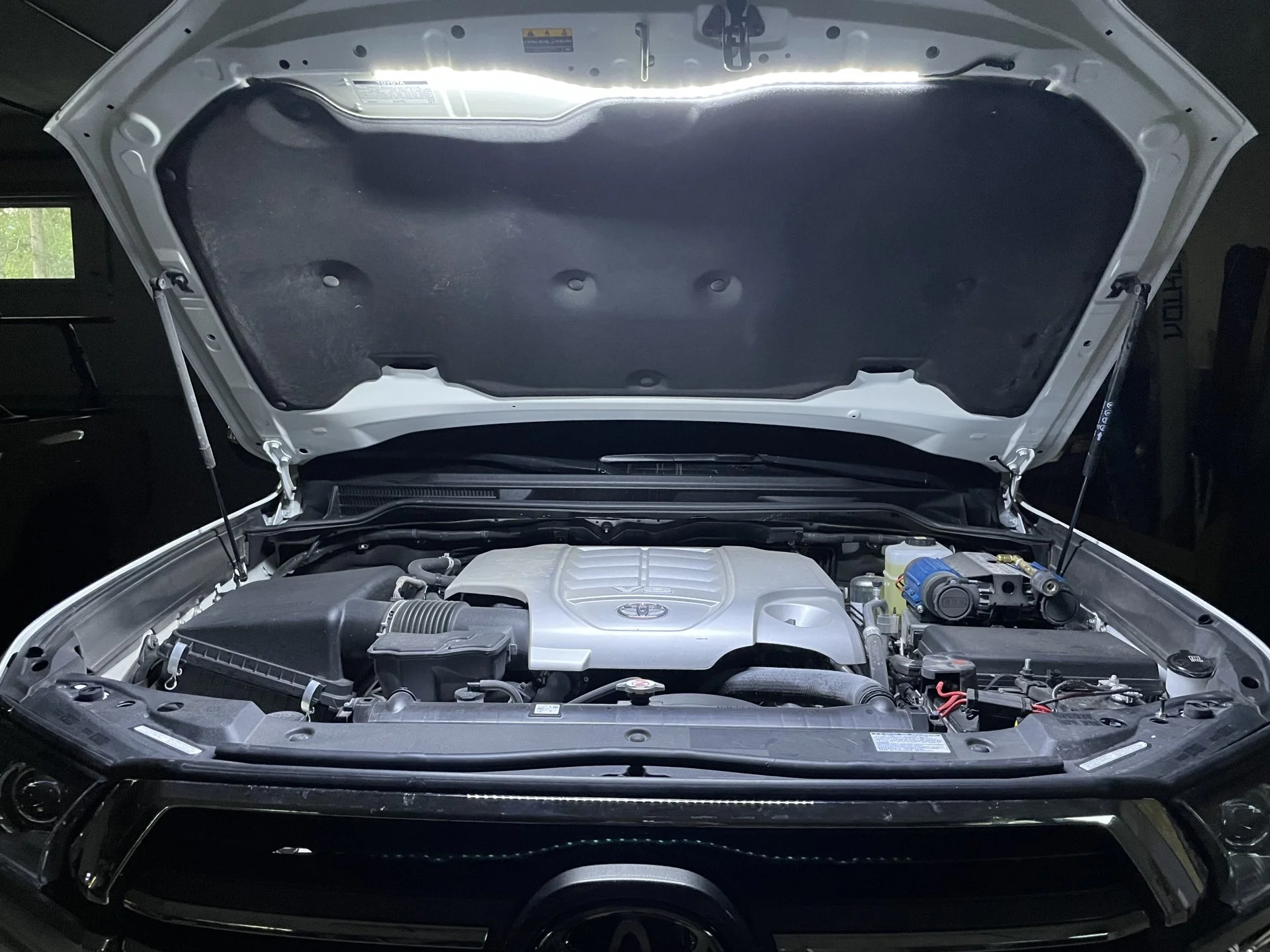

Finally received my compressor and Slee mount. Installation was a lot more time consuming that I expected as there is some fine tuning that had to be done to get the correct clearance around the compressor to not rub against other components and still allow you to remove the fuse box cover. Wiring next.

Friendly advice: double check that you have good clearance around the SAIC controller wires, and the diagonal brace of the Slee compressor bracket, and if not, adjust the bracket that holds them (it has some wiggle room). I’d also recommend wire protection sheathing. Several of us have had the wires wear through and damage the SAIC controllers. Slee said they made changes to help avoid this, but I always figure that an ounce of prevention is worth a pound of cure.
Thank you, yes I was concerned about that. It’s a tight fit down underneath, I’m not sure how, but it seems that lower bracket coul have been designed a little different to make sure no damage happens. I just installed that this morning and planned to check in on it to make sure it doesn’t shift. I almost bagged that mount to look for something else.

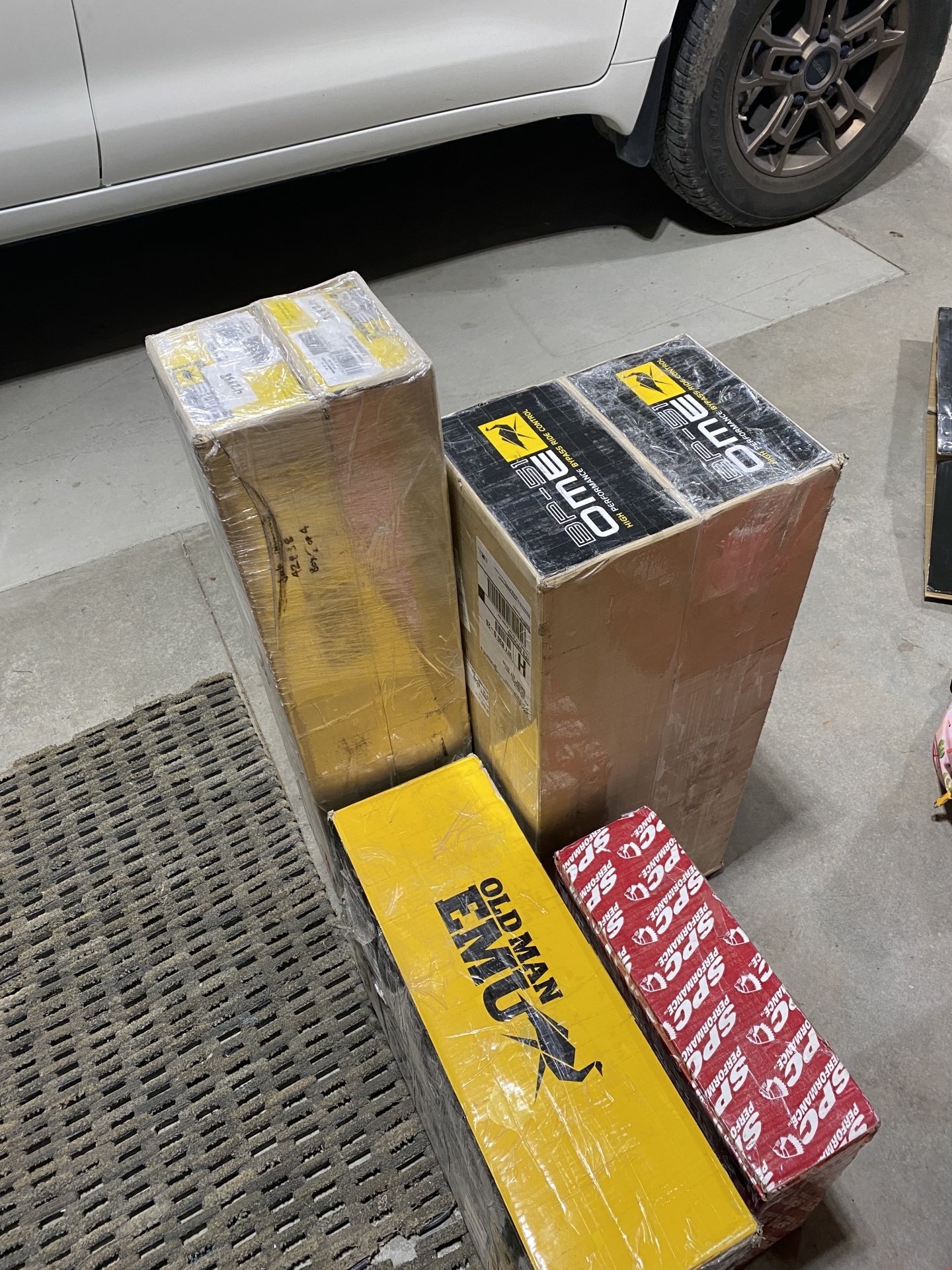

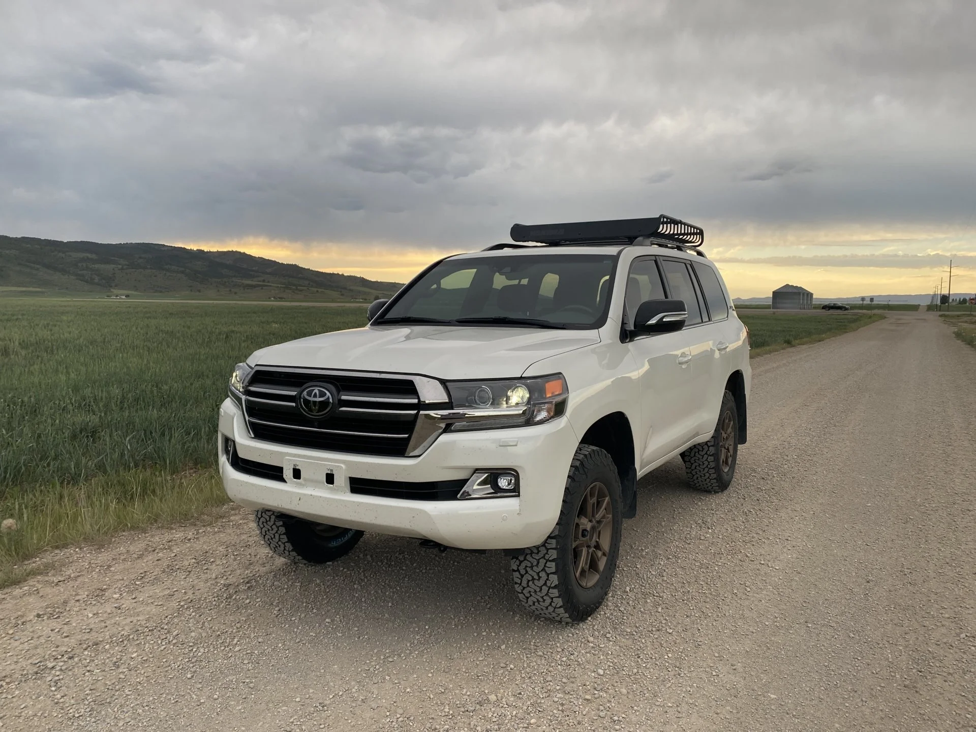

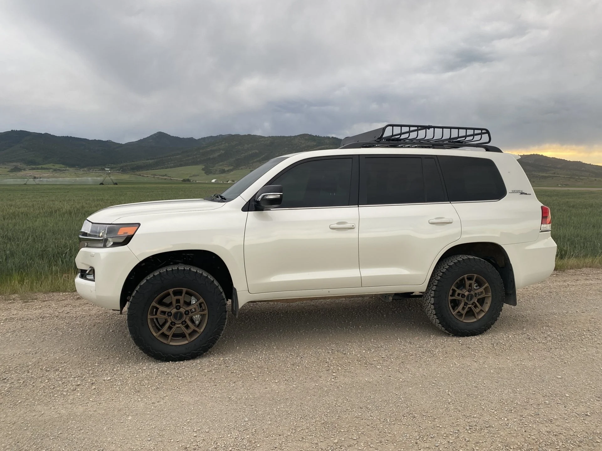

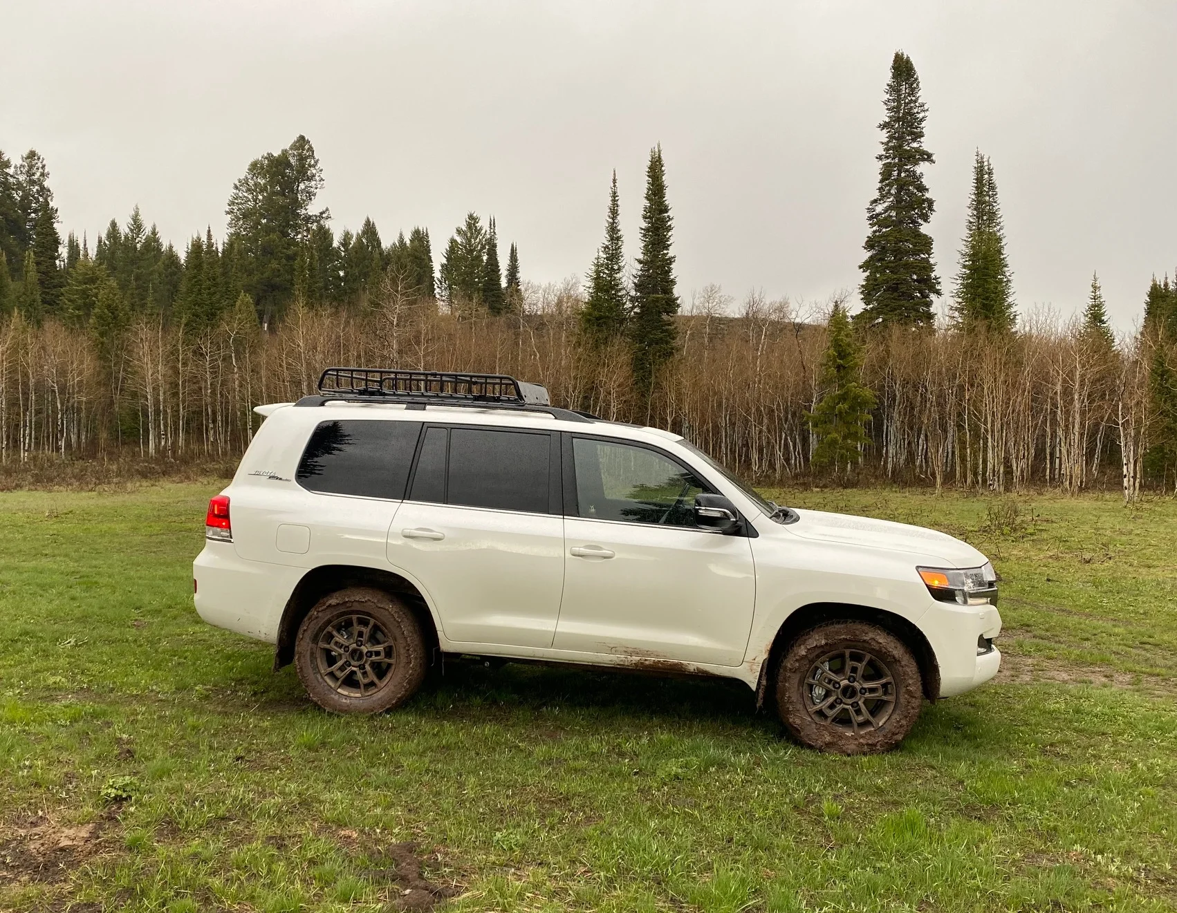

BP51 installed with 275/70R18 BFG K02. I had ordered spacer for the rear from @cruiseroutfit, but ended up installing without. Sitting on 2721 rear springs. I wish I would have remembered to take some measurements before the install to compare with after, but I forgot. Feels like the front is 4" higher than before, rear maybe 1/2" to 1" gain. Looks much better in my opinion.

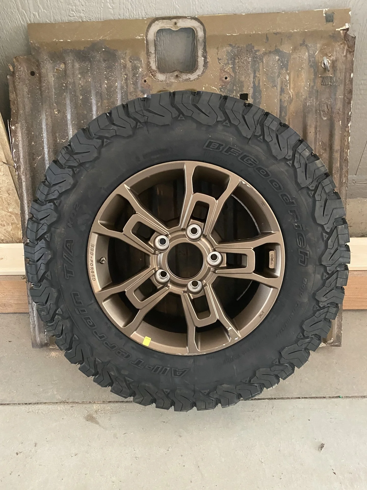

If you need OEM toyota parts, Brandt at Phil Meador Toyota in Pocatello Idaho is your guy. (208-238-1300) He's helped me with a lot of things over the years, but while the lift was getting installed he brought in a matching 5th wheel for me. Kinda lame the HE comes with a base model wheel for the spare. And yes, that is my old rusty rear floor from my '79 FJ40 in the background.
Beautiful pics and nice looking Cruiser! I also own a Blizzard 21 HE and have been debating about what to do with the front suspension. I think I am going to just do the OE spacers for now. Any alignment issues with your set up?
Thanks! I also used the SPC upper control arms. Installer said they made it super easy to get aligned. I've only had it lifted for a day but so far no alignment issues. Congrats on your new cruiser. I suspect you're loving it like I am mine. I debated just doing the spacer too but ended up doing the lift for several reasons.
Any chance you'd be willing to measure from the ground at the center of the wheel up to the middle of the top of the wheel well on each tire on yours? Are you still on stock tires? I forgot to measure mine before taking it in, just curious how much lift I ended up with.
What preload did you set the front at?
I left the front the way it came from OME which is supposed to be set up for bumper and winch which I hope to have soon. The front definitely rides a little stiff and I don’t like it, but hopefully the bumper and winch weight resolves that.
