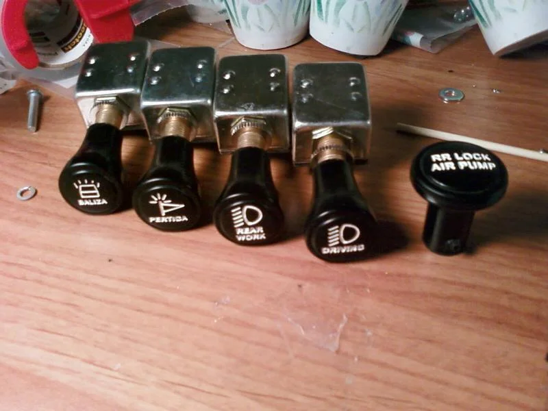

here are mine using a lacquer stick
attachment.php
attachment.php
