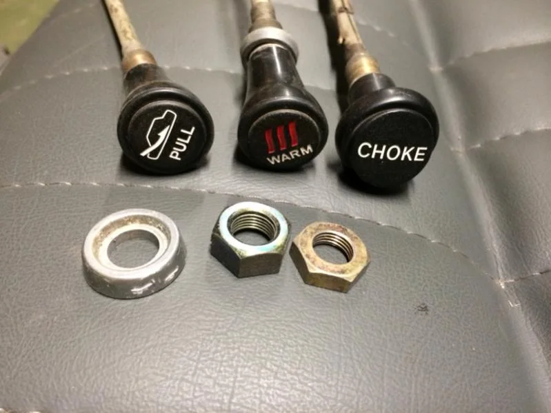

Anybody know the size of nut that holds choke, warm and vent cable to dash? And are all cables supposed to have small chrome bezel?
I will answer my own question in case anyone else looks for this info in the future.
The nut used to hold cable tight to the dash is M11.
Knowing this is an odd size I searched M11 on ih8mud and learned that driveshaft nuts are same size. So I found one laying around, tried it and it works.
You can use a 17mm wrench to loosen then nut and then loosen them by hand afterwards. Just make sure to hold on to the nut as you feed the cable out so it doesn't fall behind the heater. Also make sure you put the beauty ring on and thread thru the nut with the indented side towards the dash to make it easier to thread back on.

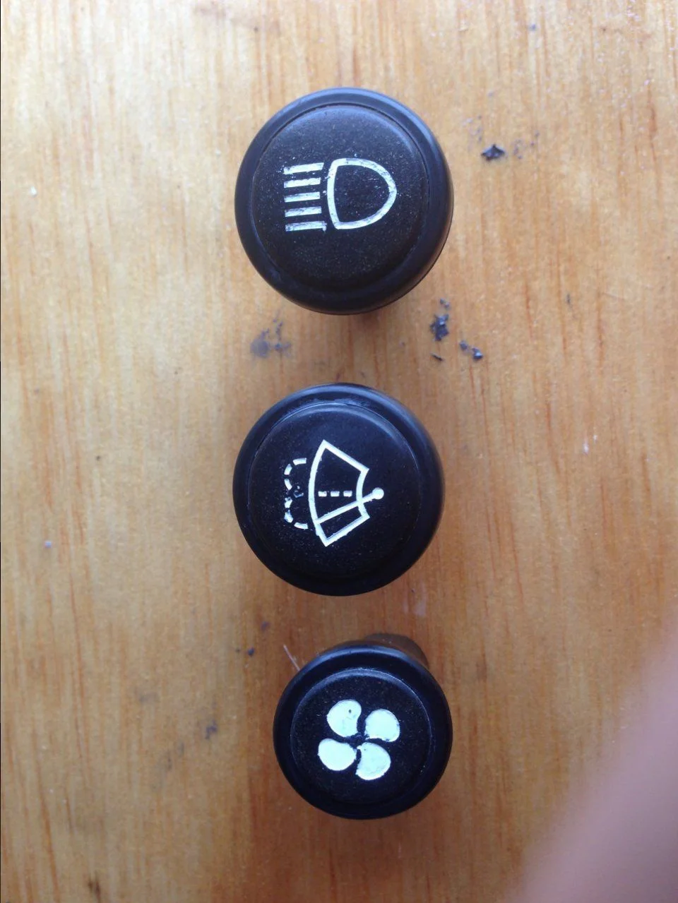

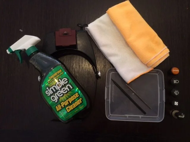

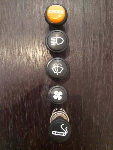

Thanks VERY much for this tutorial. It was basic, easy to execute, and very satisfying. I did five knobs (I am going to ignore all the knob polishing jokes 'cause, while awesome, are just too easy) and they all came out great. The face of the cigarette lighter knob was slightly pitted so took some extra ooomph and has the tiniest paint left over on the face but you have to use magnification to see it and if someone is looking at my Troopy that closely and it's not me, we've got other issues.
I posted the pix of the progression and tools I used below. In getting them initially clean, I found that a small metal pick and plastic spudging tool (I use mine to do repairs on really fine electronics) was very helpful.

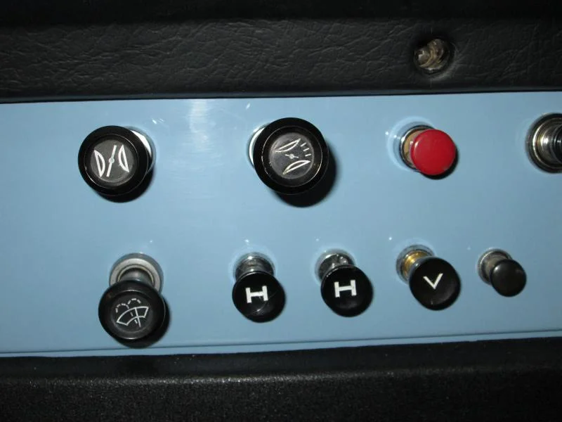

Did mine a couple of days ago, the lazy way - I didn't remove them - I did them in place and - I wasn't trying for perfection - just wanted to be able to read them again - and being colorblind, I did it all in white - using a white Sharpie.
Just slopped white on, used MEK on a soft cloth to wipe off the slop - repeated until I was happy with it - not the best picture (I'm not the pro photographer that Blake is) - next step is to get them all 'aligned'
