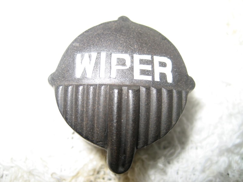

Start with an old switch:
Remove the old knob:

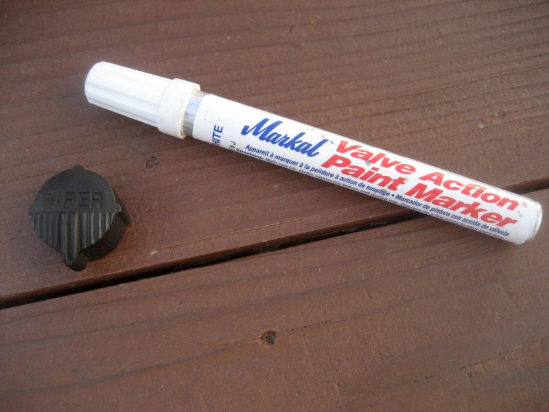

After the face is done move to the sides and edges. I usually use a fingernail behind the towel for the ridges and edges. These clean up pretty easily but with a little patience and doing it over and over your results will improve. Once you're happy with the cleaning process be sure to let it dry thoroughly. I used a white paint pen. Others have mentioned success with white crayons but I've never tried it.
After the knob is dry apply a good amount of paint on the knob. Be sure to fill the letters completely. Remember that any extra paint outside the letters will have to be rubbed off...
