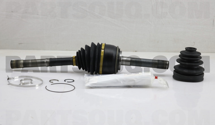

Boot kit part # is 04427-60120
Not a difficult DIY if your are somewhat mechanically inclined.
Just grab a beer, friend, and have a movie playing in the background. It's a little tedious.

Some shop changes the boot that leaks only even the boot kit comes with both inner and outer boots. I would find out what is covered in the $350.

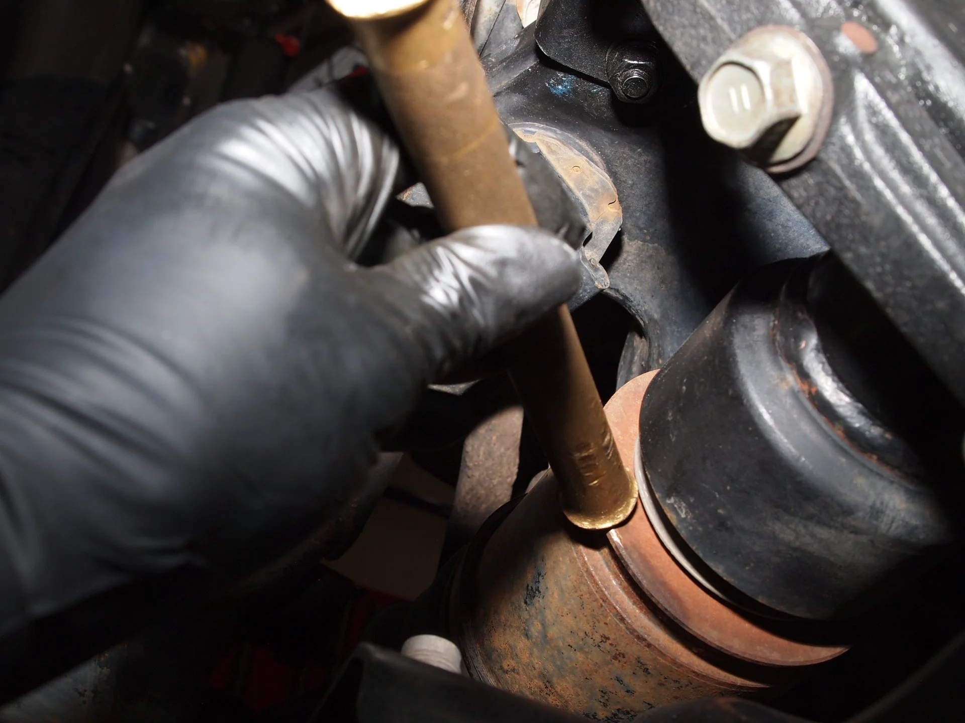

Anyone ever have the axle get stuck in the diff on a high mile truck?
I've seen some very hard to "pop-out", seem stuck. I use my 5lb sledge hammer.

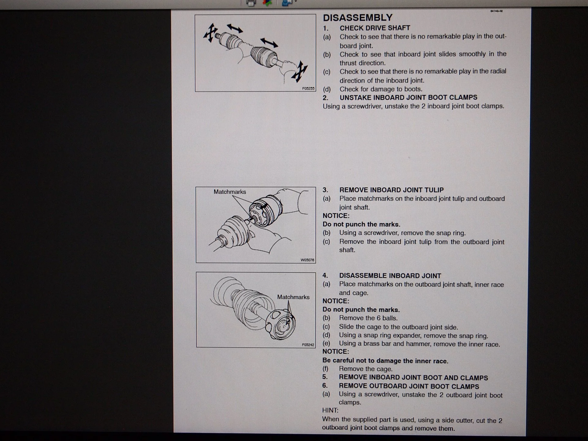

Watching a video, I did see, it is possible to disassemble outer tuple. But not easy and need snaping that don't come with kit.
Money is better spent on new OEM FDS, rather the reboot labor. If FDS does pass rigorous inspection.
FWIW, The 80 series birfield snap ring fits the 100’s center shaft where the outboard inner race goes on. But simplest and cheapest approach for rebuild is to just buy the outboard kit. Rarely is the inner joint compromised.
