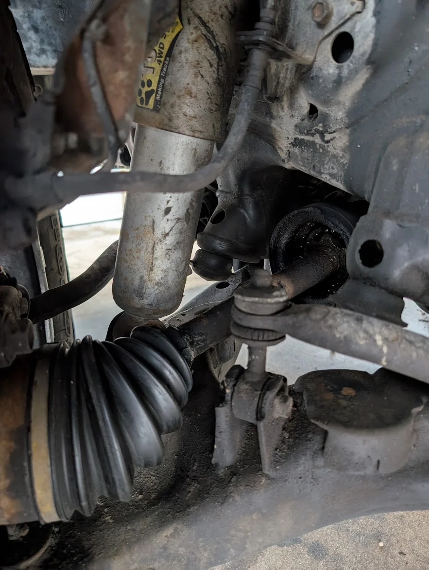

I rebuilt my 1999 LC's OEM front CV Axles with fresh OEM Toyota boots and grease about 30,000 miles ago. Since then they both have had a boot failure. Most recently my Driver's inner boot went KAPUT. The truck has an approximate 2.5 - 3 inch suspension lift and no diff drop. Really, pretty normal stuff.

Dang the entire inner boot is gone.

The amount of lift you have with no diff drop is prob factoring in to the boot failure.

I would say that with a 2.5-3" lift and no diff drop that is your issue. Angles are just too great.
Some of the taco guys will do a boot stretch on the inner boot to help with rubbing. You cut off the small end from the old boot and mount it in the original location. Then set the new boot more outboard. YMMV
