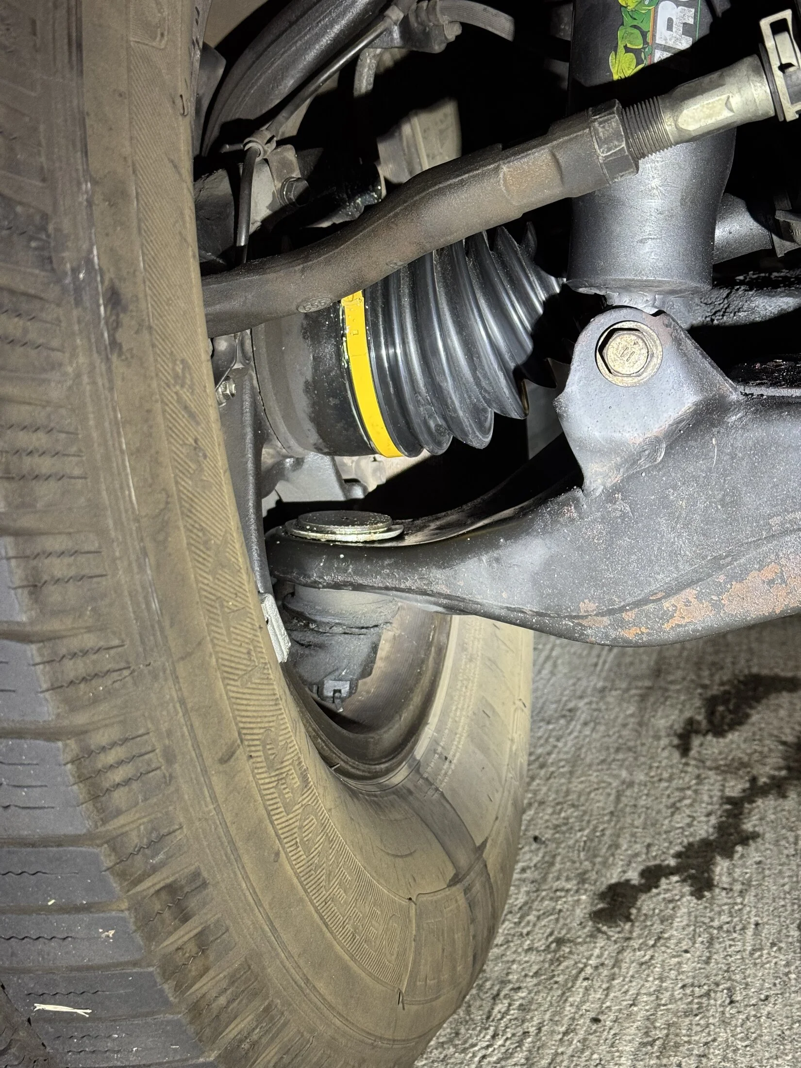

Opinions on a leaky cv boot.

Hi Mudders, I just got my CV rebooted with OEM boots. I noticed small amount of grease seeping through on the passenger side. Is this normal or do I need to put on new clips?
No that's not normal. Need to tighten clamp or remove and replace with McMaster carr smooth worm drive clamps
How long has it been? The reason I ask is, could that be a little grease that was on the boot seat area that squeezed out during clamping?
