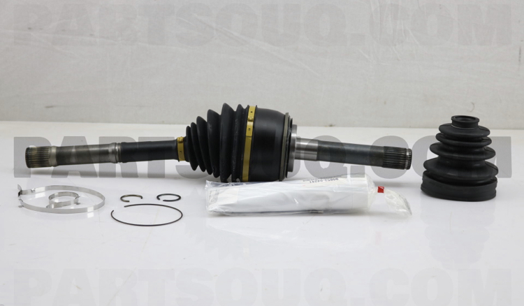

FWIW, The 80 series birfield snap ring fits the 100’s center shaft where the outboard inner race goes on. But simplest and cheapest approach for rebuild is to just buy the outboard kit. Rarely is the inner joint compromised.

I agree about kit. I had asked about these outboard from local Toyota parts dep, about 5 years ago. I was told no longer available. I've since found overseas, but yet to order any.

FWIW, I’ve bought a handful of them from Toyota parts places here in the states for $180-195 per kit. Can usually get two kits shipped for $50. The most recent pair I bought was from cheapestfactoryparts.com, where I got both kits ($185/kit) with shipping for $420 total. So for $30-80 less than the price of just one new FDS, I rebuilt two OEM units.

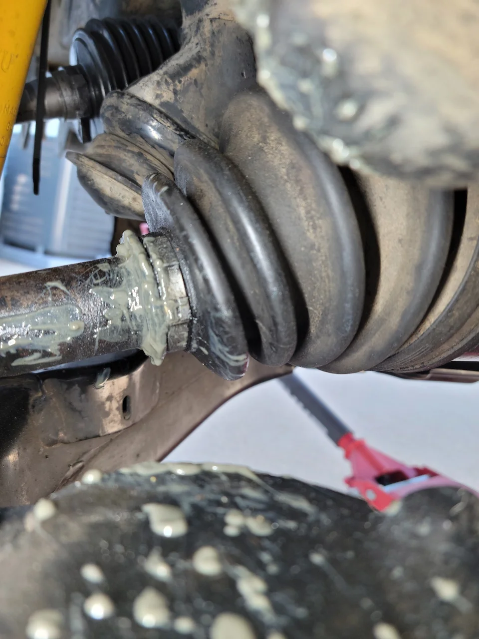

Just installed brand new OEM CV axles about 6 months ago and the driver side inner boot is slinging grease as of last month, now passenger side is starting to sling a little grease. No rips on any boots, I’m assuming it’s just the clamps getting loose? Currently have a Slee diff drop and 2.5” lift.
Would it be best to just regrease and reclamp? Or replace with a longer CVJ red inner boot for more durability?

Replace the clamps with McMaster-Carr smoothband worm drive clamps.
Thank you for this and I have already purchased 2 of them. I’ll swap them out. Have you had problems with the worm drive clamps ripping the OEM boots? Been hearing mixed reviews about this.
As long as you got the *smoothband* clamps, you won't have an issue. The edges of those are rolled to prevent cutting into the boots. If you did not buy the smoothband clamps, then yes, the normal clamps with sharp edges will cut your boots. Also, the torque spec on these is really low (26-35 inch-lbs), so don't overdo it.

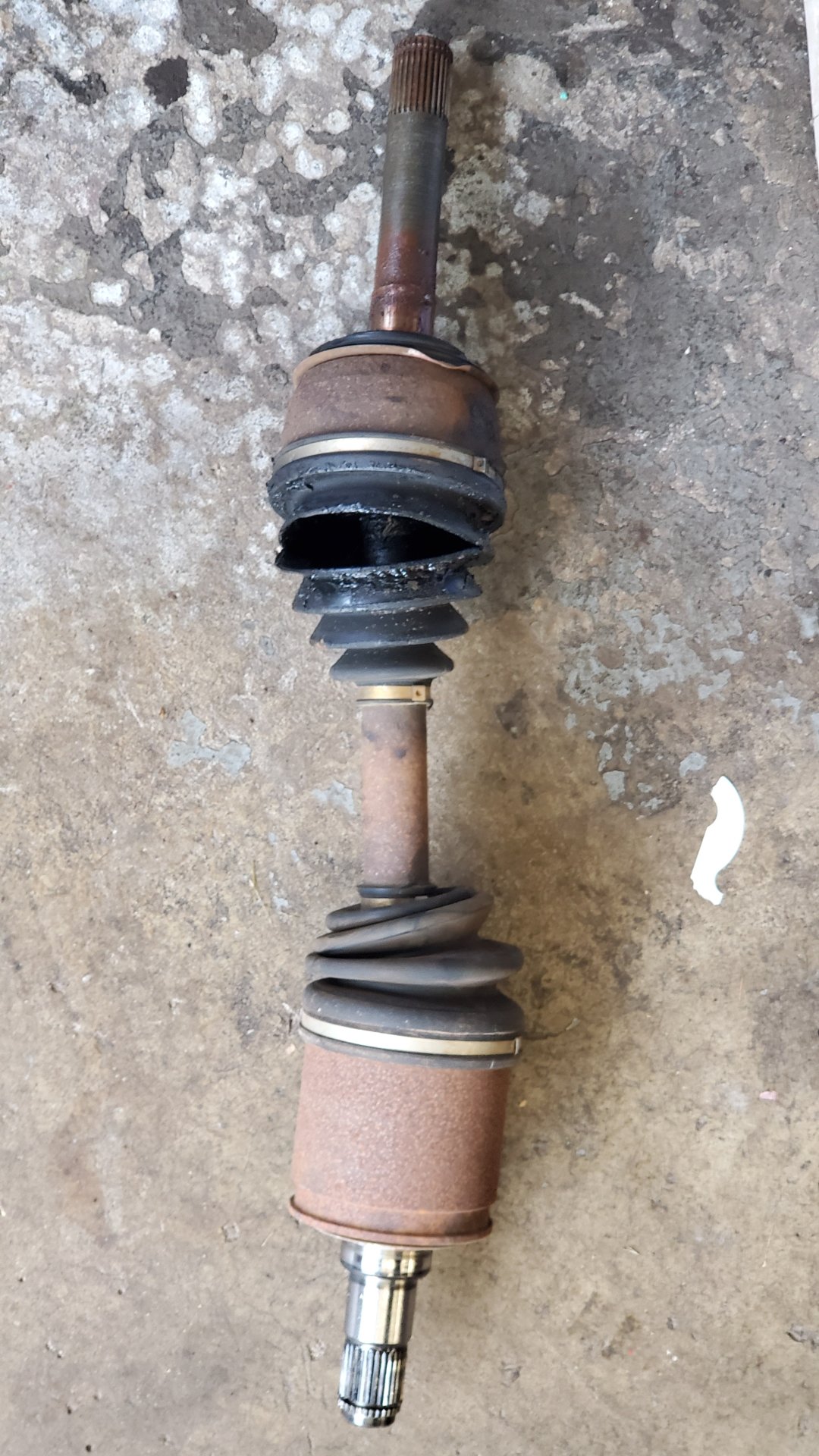

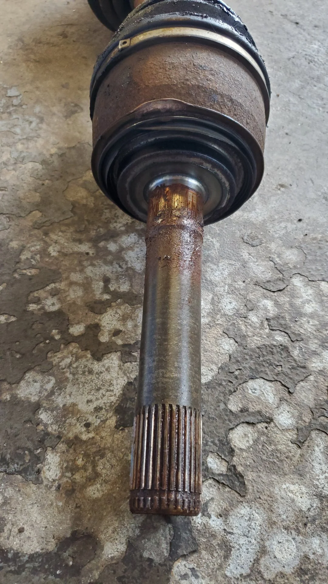

Hi guys,

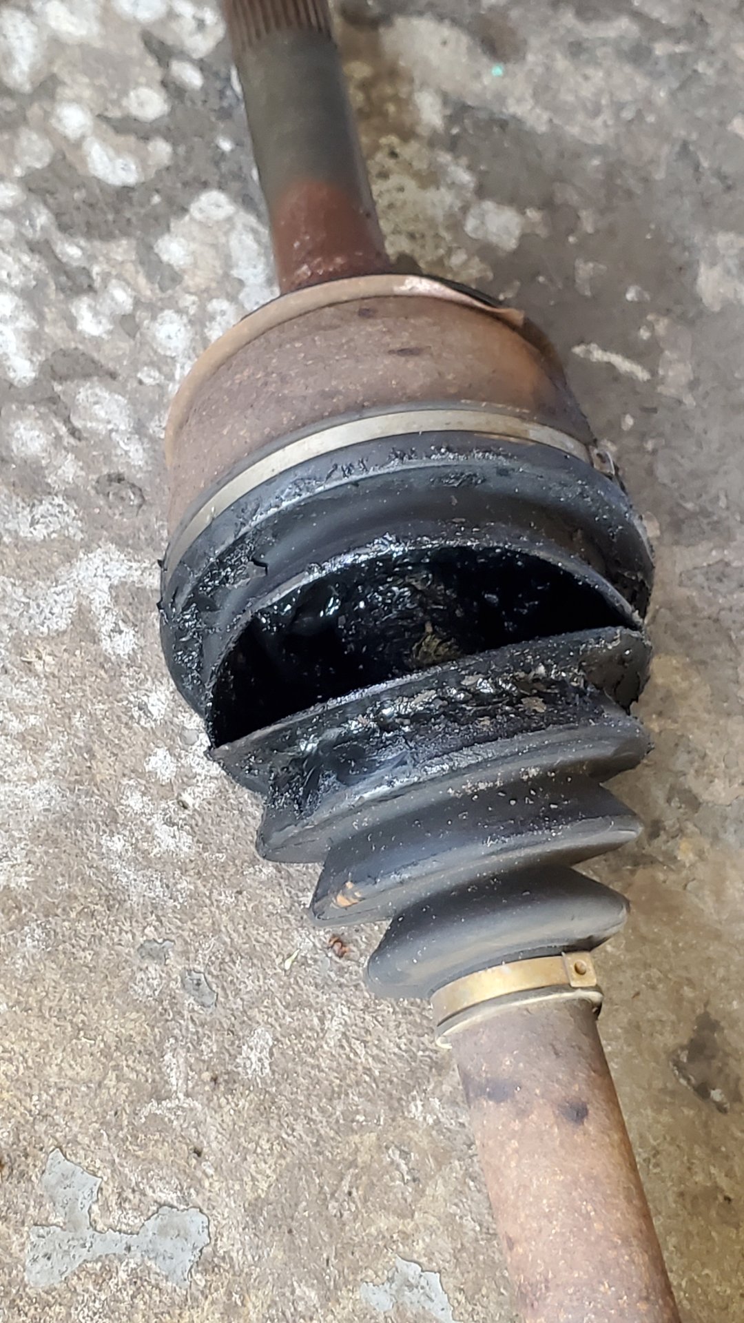

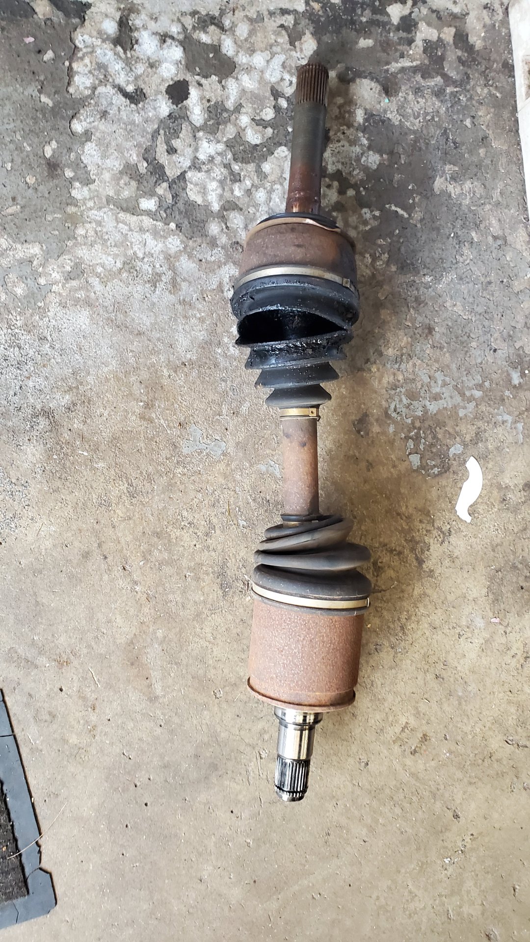

From all the suggestions and knowledge you guys put into this thread, I decided to change the whole CV Axle. Here are some pics of the old axle and you can see the rip on the boot.

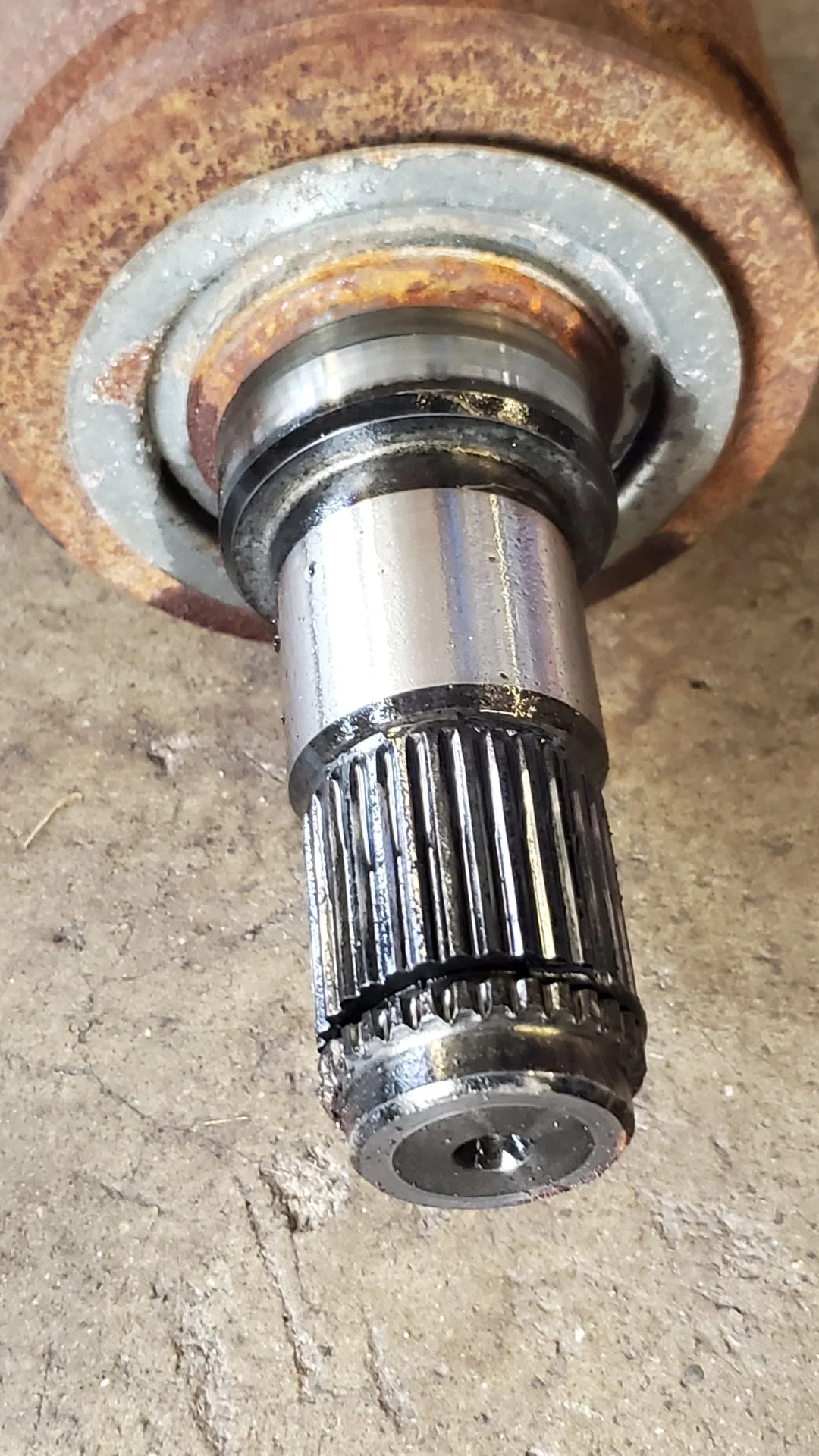

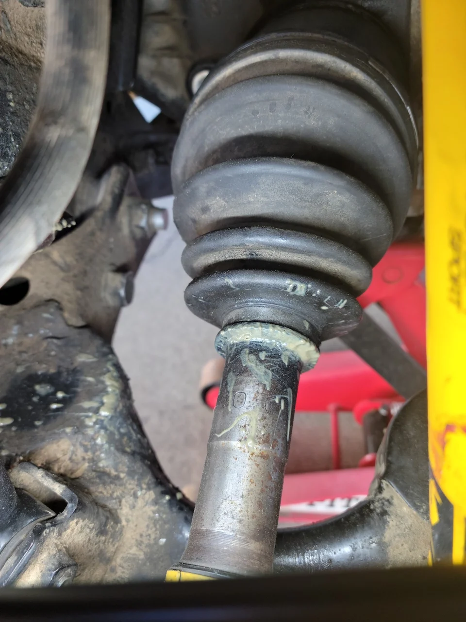

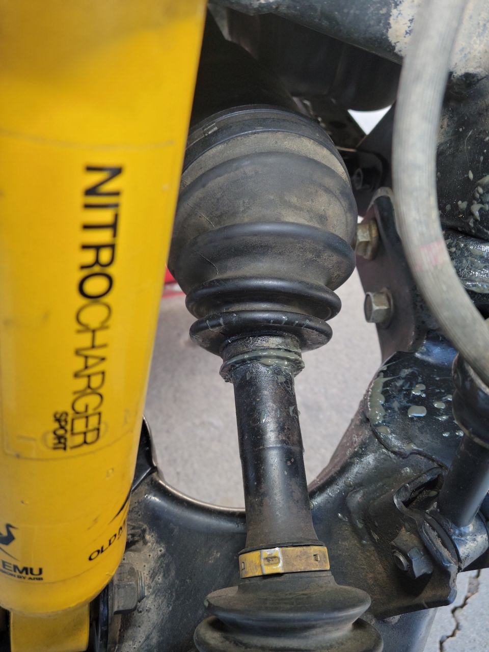

I noticed grease all over the wheel on the drivers side yesterday and pulled the front wheels off this morning and saw this on the drivers side. 3rd picture is the passenger side. 282k miles, I know the drivers side axle was replaced before I bought it last year. I just replaced both inner axle seals. I will pull both axles today and see if they are a complete replace or just a reboot. I do have a diff drop to keep the angel from being so sharp.
I View attachment 2950175View attachment 2950176View attachment 2950177
You just need a re-clamping of small inner CV boot clamp. NAPA carries them. Just ask for small CV boot clamp. 30 minute job.
If you've lifted rig. Slee diff drop always a good idea. But diff drop or not. Lifting done on broken-in front drive shafts (AKA CV). The inner CV tends to fail in time.

If inner CV fails, it will give plenty of early warning usually. Clicking in turns!
BTW: NAPA has the crimp tool, for the clamp. No need to even pull wheels off to re-clamp. But really helps make easier, to put front end on jack stands. Chocking the rear wheels for safety.
Post very clear pictures of grease seen in wheel well and points where boot leaking from.
Most just need re-clamping. Others have ripped boots.

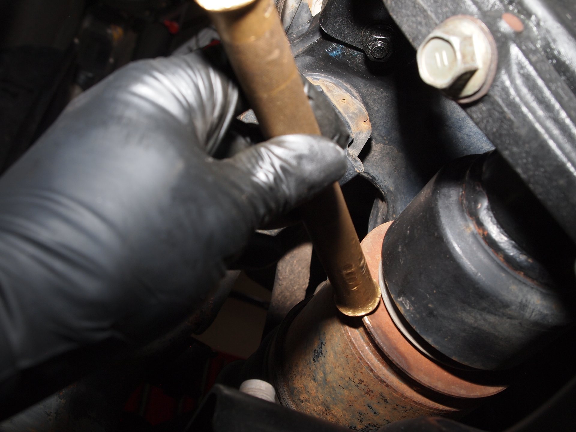

If boot ripped open and you lost a lot of grease. Which grease is very sticky and hard to wash away. I'd test front drive shafts very closely. If any question as to its health, which also includes condition axle splines. I'd opt for replacement of FDS, over reboot.View attachment 2819904
I've seen some very hard to "pop-out", seem stuck. I use my 5lb sledge hammer.
that drift with the assistance of a hammer makes getting the cx axle easy in and out. Don't just use a hammer

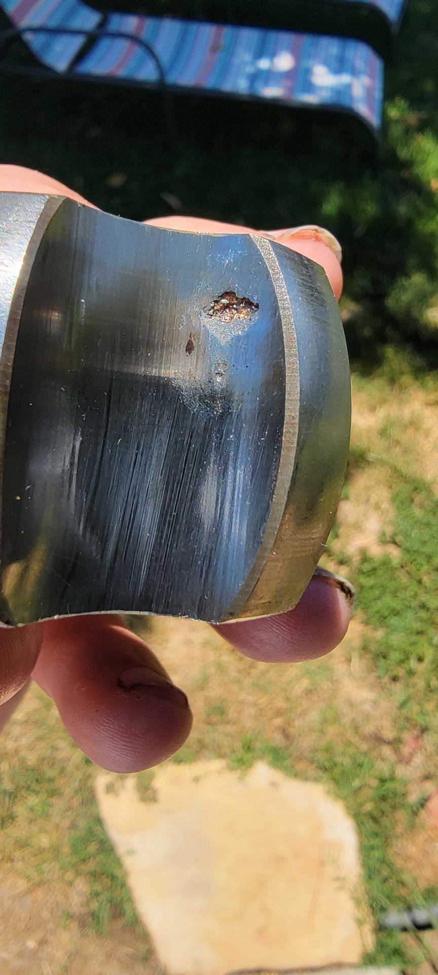

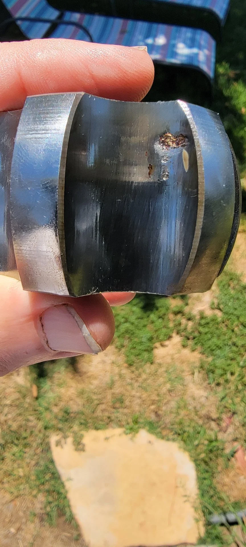

So I'm in the middle of rebooting. Is this something I should be concerned about.
The gouging is in the same location on all six sides.
Ditch it. You need a new joint. Is that inner or outer? If outer, you can get a new outer joint + tulip + boot assembly for $200 from Toyota. If inner, then you’ll need a new cv axle assembly.
Its the inner.
What harm can I do if I run it as is. The balls look ok.
