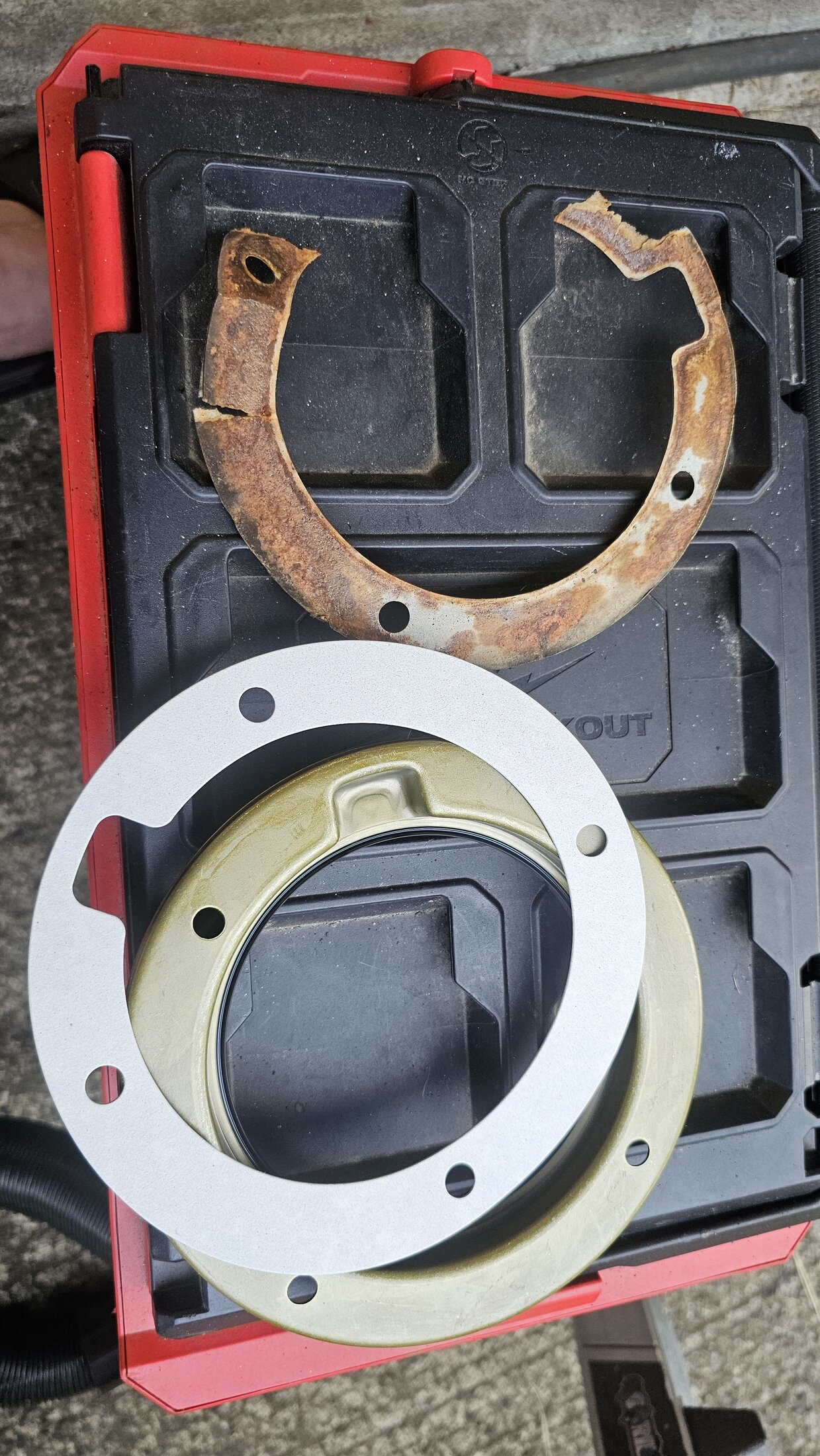

Next quick question, the old paper gasket under the large dust seal did not appear to have any gasket sealer on it. When I install the new paper gasket, should I use gasket sealant (permatex ultra black) or should I leave the paper gasket dry?
No, there is no lip that prevents driving in too deep. Measure the original and drive in the new to match. I used a 3/4” wooden dowel from Home Depot. @2001LC has a YouTube video of him using the same dowel shaped a little on the bottom. If you have time I believe @cruiserpatch sells the factory service tool for driving these seals in. The SST allows the installer to drive both seals in care free. The tool prevents under and over driving of the seals.
I’m pretty sure the driver’s side has a lip.
I just brushed both sides with a little red grease.
