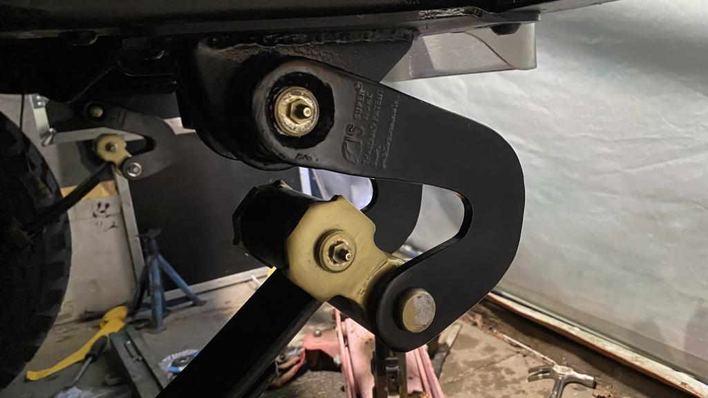

I've made them. I built them with two sections of steel bar, and a short piece of square tubing welded in between them (H-shaped). The parts were precision-sized on a milling machine, and I precision drilled them on the milling machine as well. Then, I welded the three pieces together. I found some Grade-8 bolts that would fit thru poly bushings, and secured them with flat washers and nylock nuts. I currently question everything about those shackles aside from the mild steel bar for side plates.

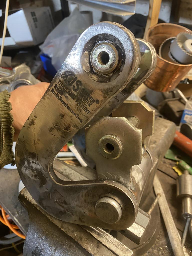

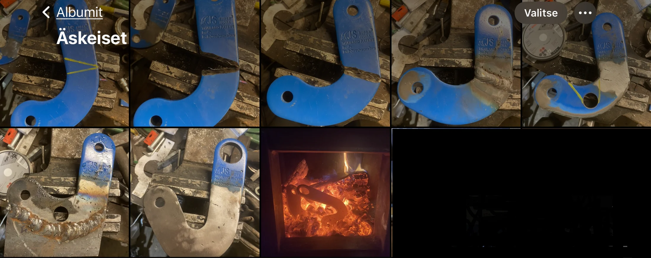

I did my custom shackles (modified from chinese G-shackles), but without a plasma cutter (only with a mig and an angle grinder). Ball bearings, double shackles.
