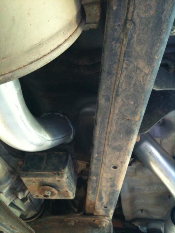

Got cruiser back from shop last night and it is night and day difference on ground clearance from tucked out of way cat and over frame piping. And NO CEL on dash!!!
First couple pics are factory exhaust and pics after those are are finished Single 99306HM cat and rerouted pipe.

Looks good! You might want to wrap the section that goes up and over your frame rail with header wrap. I had to as the exhaust heated up the floor board and created bad smells inside the cab.
Okay. I didn't think of that till someone mentioned a few posts before also. Def makes sense. Thank you

Good to see this thread is showing some good ideas! I am happy with the hi-flow cat I welded to the factory Y-pipe. I kept the O2 sensors in stock location. The clearance is not stellar at the muffler (stock), but hugely improved at the cat. Pics of what was, and what now is are below...
I left my welder at a friends house and he ran it out of argon, so I had to use fluxcore wire. Gotta love the spatter. It was easier to weld after I put the truck on its roof though!:hillbilly:
