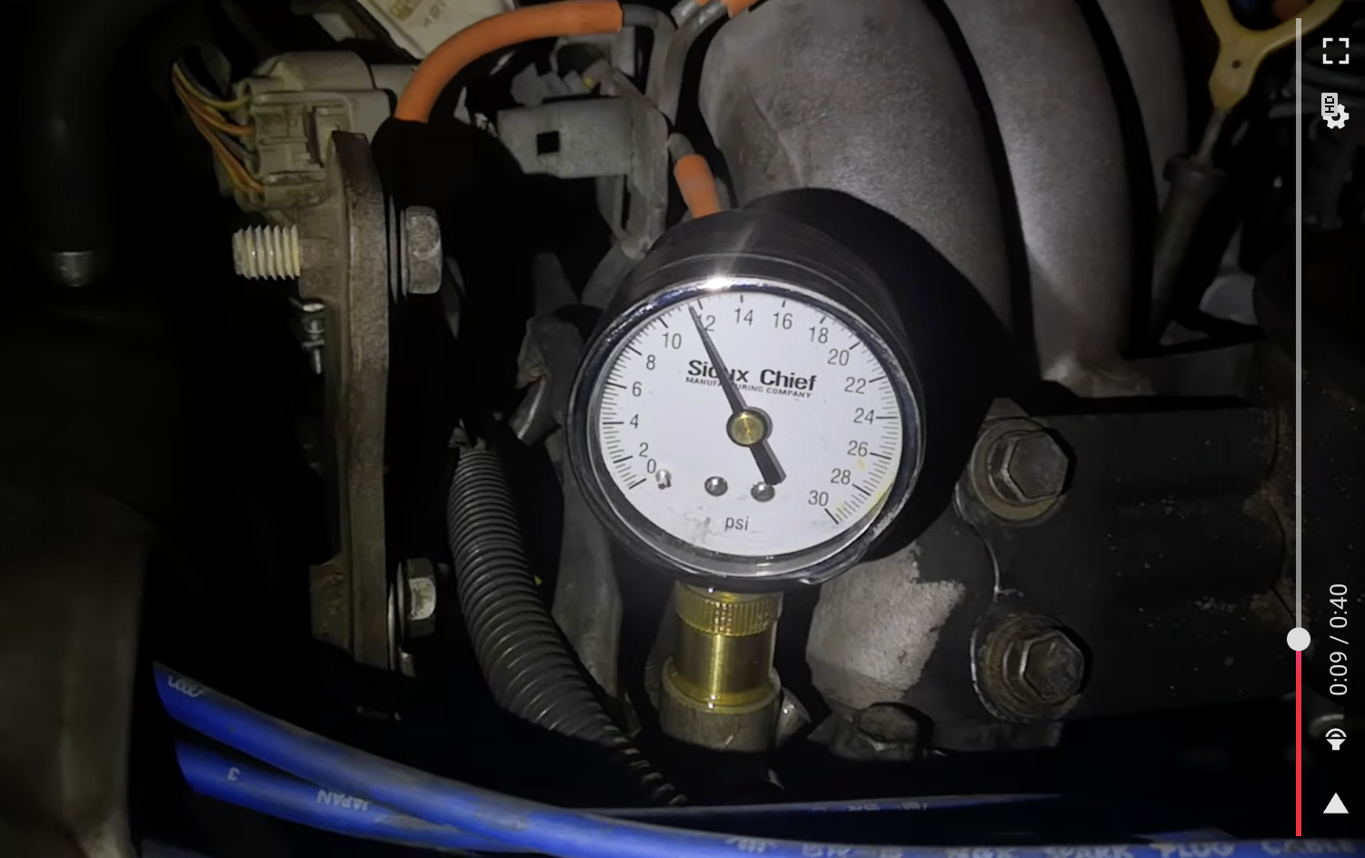

Not having this, a while ago in a pinch I removed the FPR and jerry-rigged a pressure gauge directly into the rail. Allowed me to confirm that my fuel pressure was way too low.

Edit - not sure if it's a good idea to do this if you're not already fairly certain the pressure is too low. I don't know what happens if the pump is actually working correctly, but the FPR isn't there to limit the pressure - maybe a hose may blow off somewhere?
Yeah I could see doing that. I just wouldn't want to run it for long without it regulating my fuel pressure. Seems like you could tell if the pump is weak.
