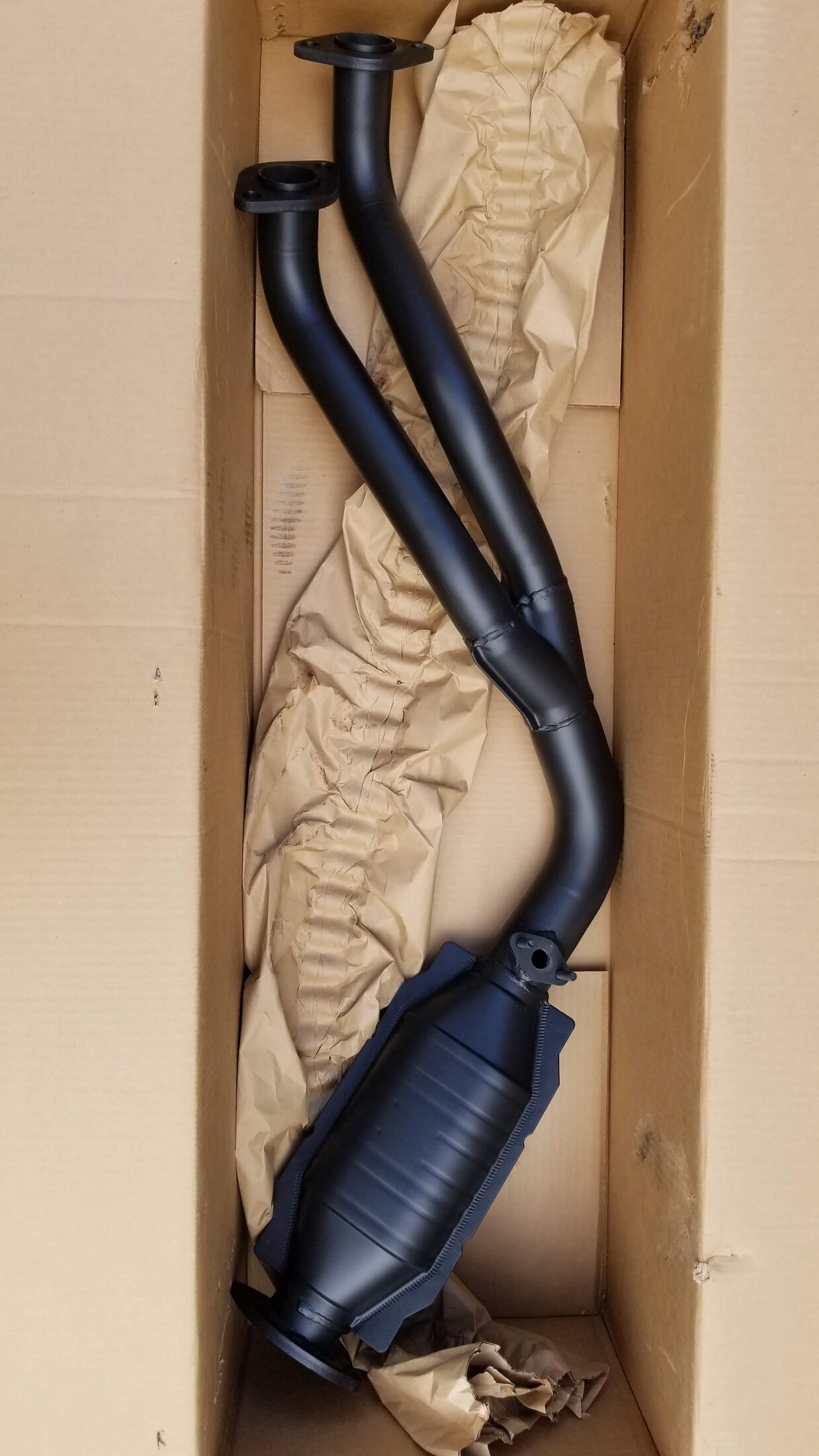

I had the Magnaflow ceramic coated, the shop cut what they needed to make the muffler fit properly, and all the rest of the piping is T304 stainless.

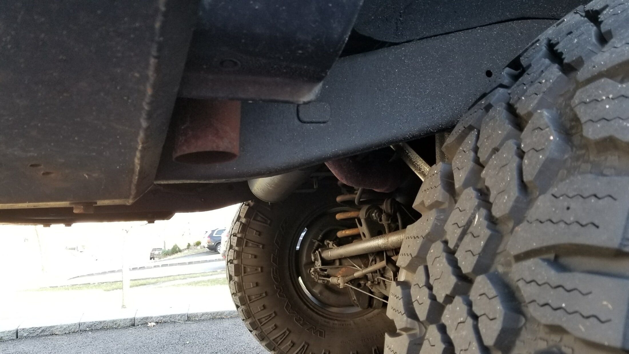

Cleared out the entire right side, and everything is tucked up high and tight. The Brexhaust muffler is a smaller diameter than OEM so less of a chance of catching a rock. Exhaust exits behind the right rear tire and is cut slightly higher than my rear bumper.

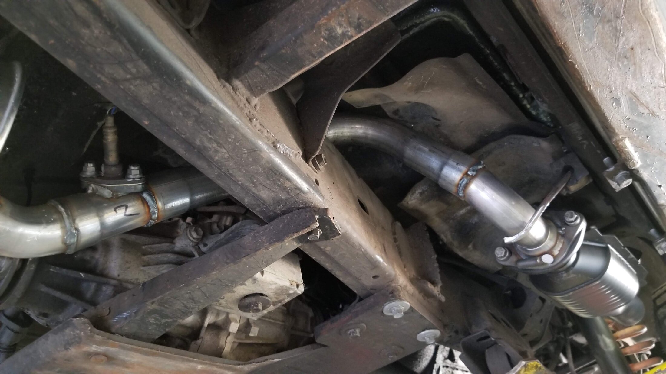

The first attempt using regular pipe. The routing is the same, just using T304 and OEM hangers. 2 additional supports have been added that I don't have pictures of.
Ceramic coated Magnaflow
Over the frame routing.

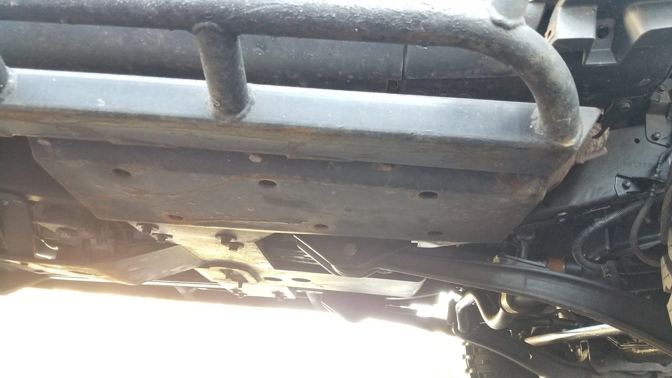

Cat skid plate bolts to the slider and frame.
Exhaust exit
Exhaust exit
