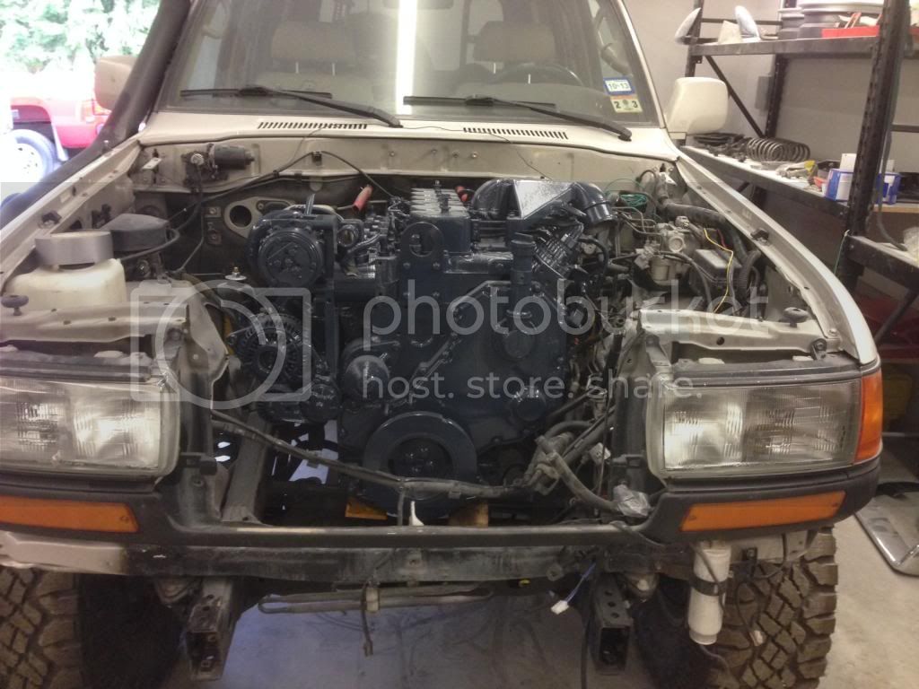

I should have another round of photos with an update this week. Talked with with the shop last week and they said its been real busy with all their projects so things have been moving slow but progress is getting made.
Engine is painted and sitting temporarily in the engine bay. I really like the Kubota grey paint Jonesy's used for the engine.

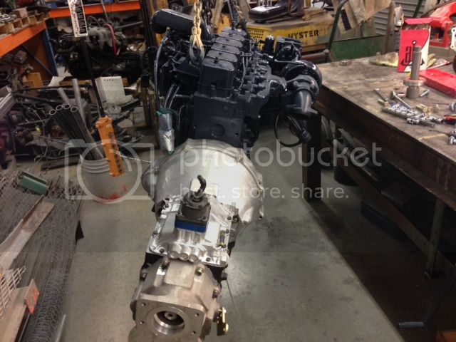

I am going to do the same exact swap! very excited, have contacted jonesys, they told me they weren't going to offer a kit, they do all the work...? I almost have everything I need, however the T-case adapter is killing me. anyone know where I can find one? or where jonesys got theres?
I Aint gonna jack your thread or whatever, just beyond stoked! Subscribed!
And also, how'd the trans fit/locate? what shift plate did you use?

dieseladapters.com
full conversion kit is susposed to be out this month
We are not selling a retail DIY conversion kit that maintains the stock auto transmission, if that is what you are talking about.
Contact diesel adapters for said DIY kit if you want to do the conversion yourself, maintaining the stock auto.
While we no longer support the DIY stock auto diesel conversion, we will soon offer a Diesel Conversion Kit that includes motor and transmission mounts for the Cummins 6BT and NV4500.
Otherwise, we do diesel conversions at our shop. :cheers:

Here is the latest photo with front grill back together. Getting excited to see everything start to come together. A couple issues that have slowed things down is my split case is getting looked at for shifting issues. It probably needed a rebuild anyway. Also the stock radiator was "iffy" with its age so it was replaced.
