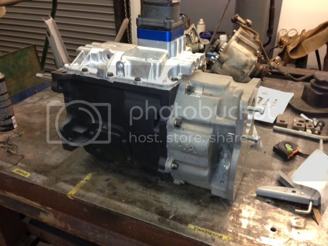

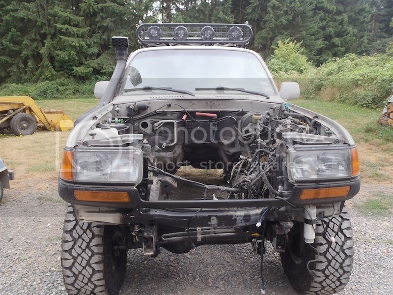

Conversion is officially started at Jonsey's Offroad. I got the first photos sent over this morning as they are mocking up the engine/trans. The factory engine/trans/transfer case will be pulled and sold. Here is a video of it running if you or anyone in the Portland area is in need.

I'm not a heavy foot driver so I think for me the axles will hold. The NV4500 manual trans was behind the 6bt from the factory so I'm not worried about that at all. I mainly chose the 6bt for better mileage and obviously more power. More power to me means maintaining speed on hills not 0-60.
