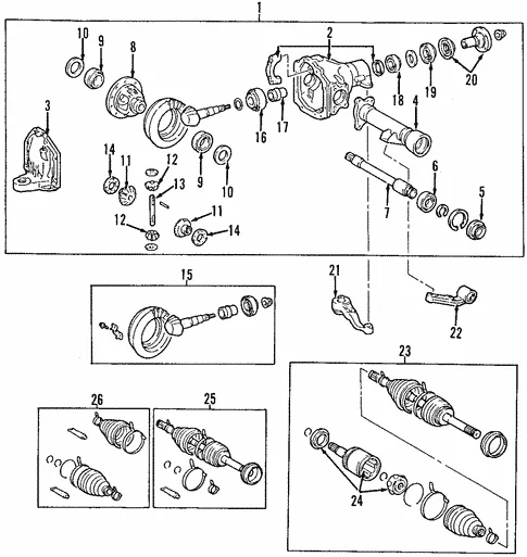

In the image below, parts labeled 8, 11 and 12 are the weakest point in the LC100 running gear. The ARB locker I used to rebuild the diff is both stronger and cheaper all told, unless you can find a used complete diff to swap out.

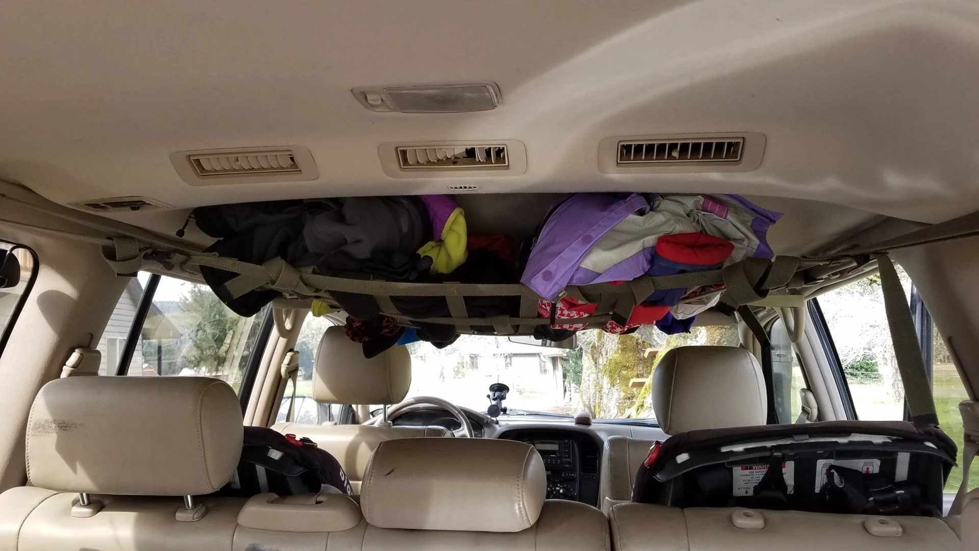

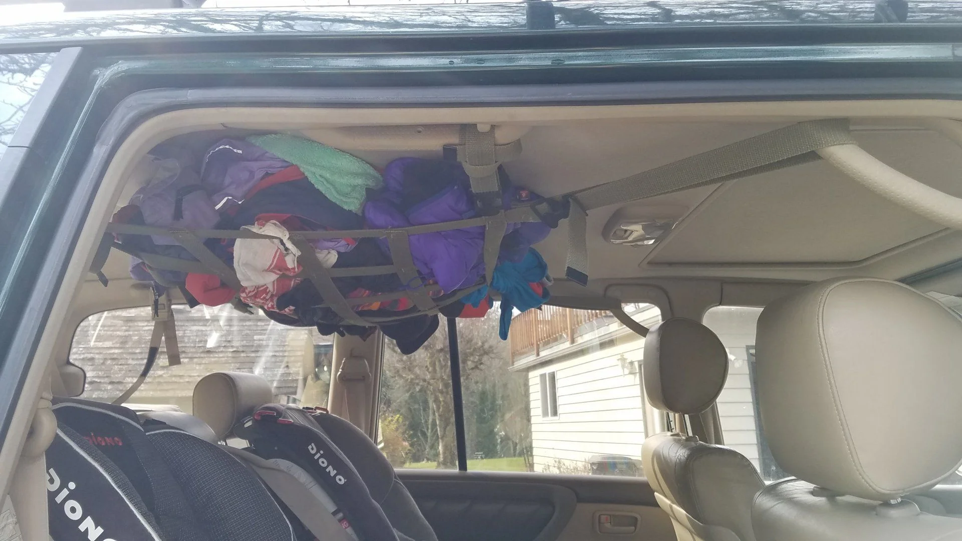

Another little mod I put in our Cruiser a couple years ago that has made life easier as we travel, is the cargo net above the mid row seats. All of our jackets go up there and are easily accessible.
Originally I purchased them from SPORTSMANSGUIDE.COM, but they are out of stock (This is unfortunate because they were $14 for 3 plus shipping). I did a bit of searching and discovered a few other suppliers:
Colmans | U.S. G.I. General Purpose Cargo Net - $14.95
Army Surplus Warehouse | Military Issue Cargo Net Securing - $14.95
