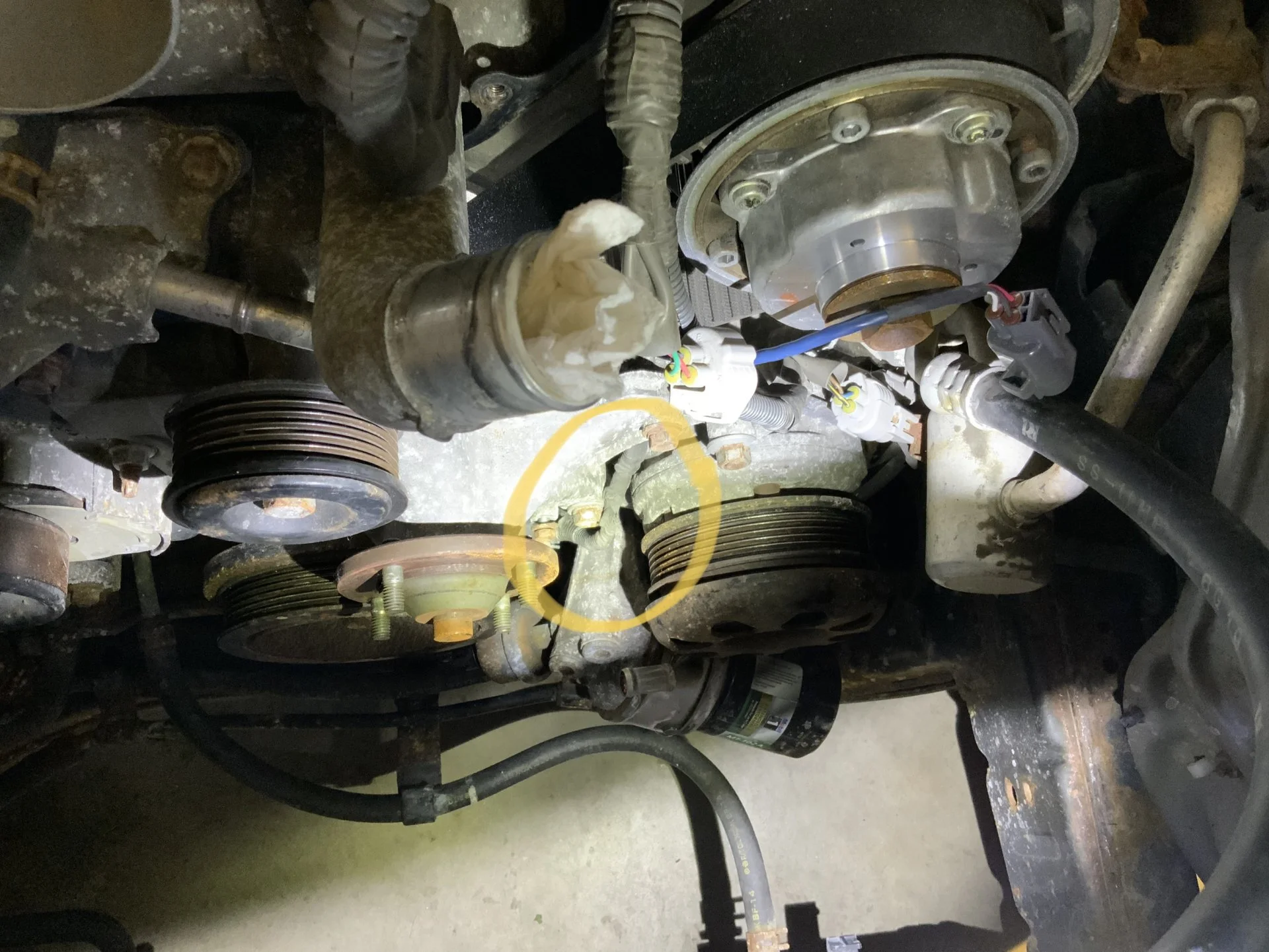

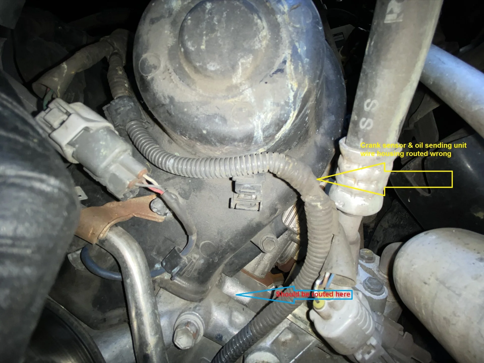

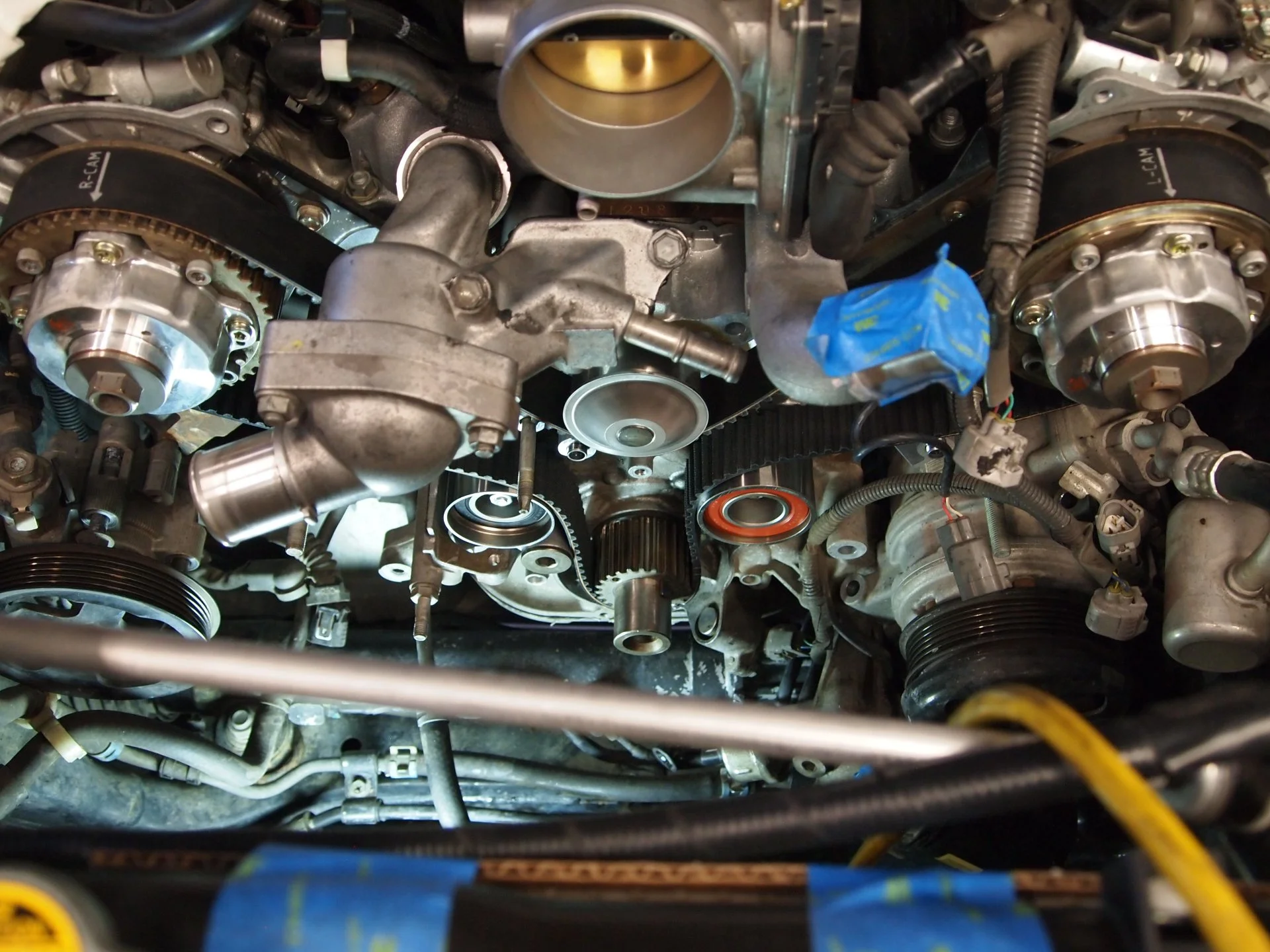

One thing I did notice last night was the wiring harness from the oil sending unit and crankshaft sensor transitioned from a black plastic wiring loom to black tape as it routed behind the water pump (see yellow circle in photo). Is this factory or could this be a fix by the PO? I didn’t want to pull the tape off and ruin the seal.

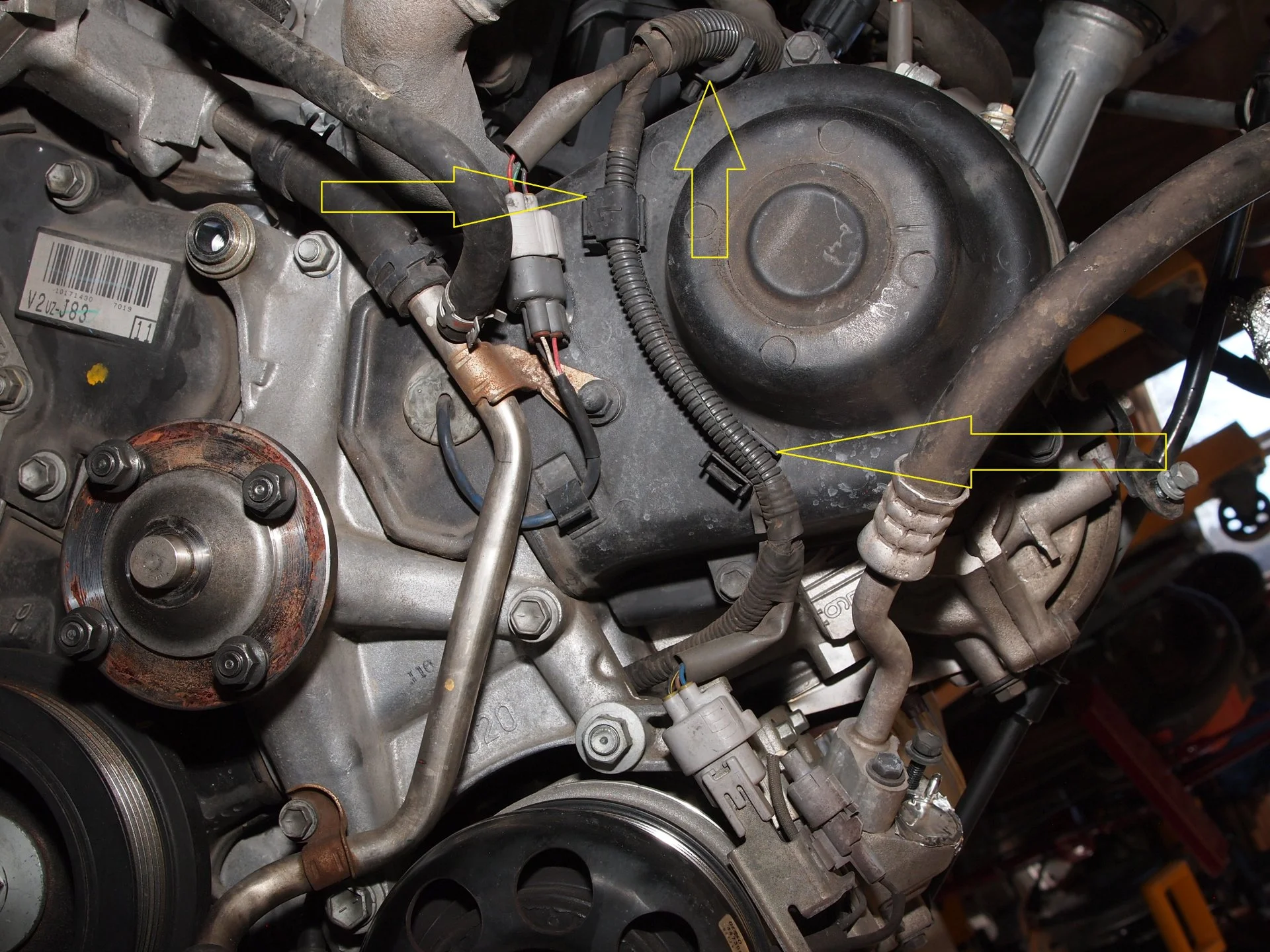

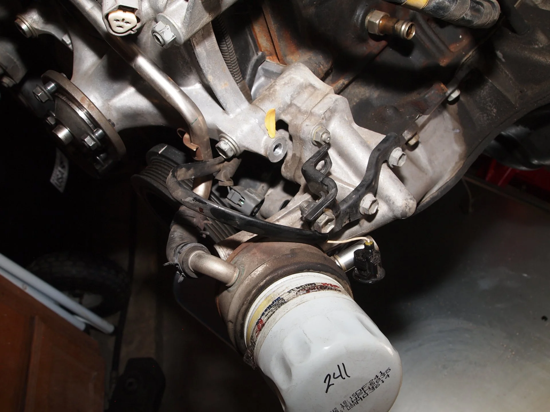

So crank sensor & oil sending unit wire is wrapped from factory, and goes behind the "fan bracket". Many call fan bracket a water pump, it is NOT! Provided housing/tape wire does not rub on drive belt, by keeping tucked in. I wait until day fan brackets is out, to properly route wires. I do hope you inspected that fan bracket closely while you were in there. I replace a lot of them.
Heater Tee hose clamps, use smaller clamp on the 2 lower (rear heater) hoses. I reuse all factory clamps and hoses 90% of the time. Except the first short 90 degree hose. That one I always replace. Being very very careful to not put excessive pressure on pipe it attach to (pipe coming up from rear water bypass joint).
@2001LC , thank you for the quick response and clearing up the wire wrap confusion. I also had a feeling after I typed “water pump” and submitted the post, I had it wrong 😂. I’ll definitely triple check the fan bracket when I get home tonight and take a video. Is there a diagram or photo that shows the proper routing of the wires? If not, I can try to post a video of how mine is routed and maybe someone can critique it?
@2001LC , Thank you for the photos for the correct placement of the wiring harness. I noticed on my timing belt cover, the tabs that hold the wiring loom are broken off. Other then that, the wiring harness follows the same path. Do you know if I can purchase the tabs separately or do I have to buy a new timing belt cover?

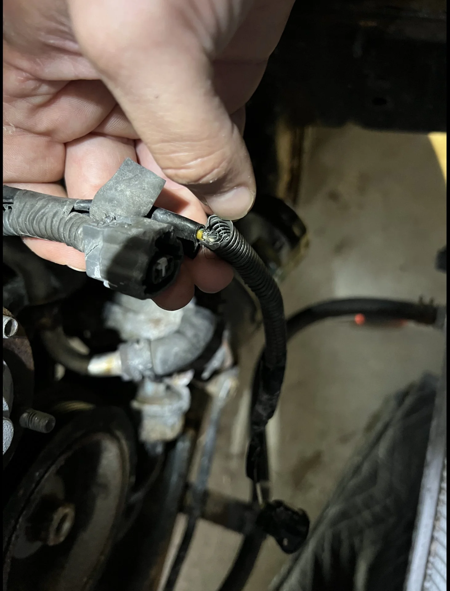

Getting back inside and removing the intake, serpentine belt, the fan, and shroud went pretty smooth and easy. While looking at the wiring harness, I’ve noticed there are two rips/tears on the oil pressure sending unit wire (see photo) so I definitely need to replace that section. Does anyone know if there is a way to pull the wires up from behind the fan bracket or do I need to take it off?
So you're asking is the can rout back in the proper path. It can be done, but difficult. You'll push one of the 2 wire housing block down the path behind fan bracket at a time. They will fit but very difficult to work in the area. Using forceps straight and curved may help. Removing wire housing block, by releasing pigtails will really help a lot.
But you can just tuck & tie them back in front of fan bracket. Then wait until day you doing a fan bracket replacement or timing belt job.

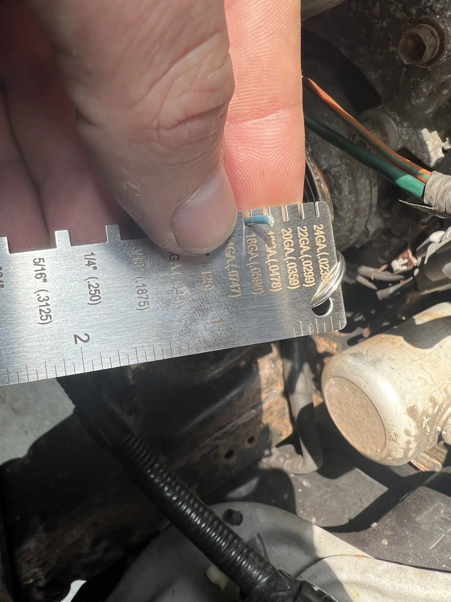

Use a wire gauge.

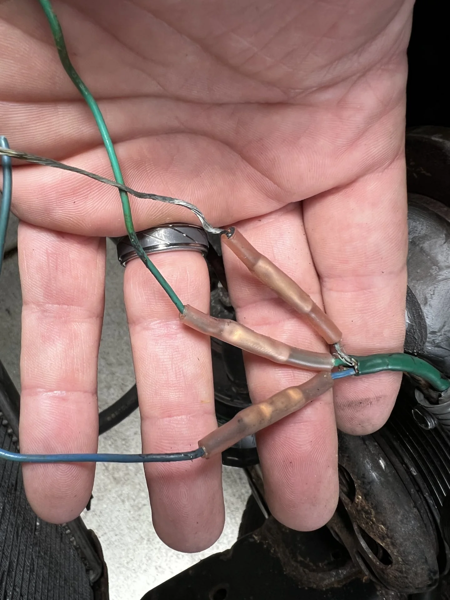

I picked up the plugs and pigtails (wire & pin) this morning. Once I got home, I cut the two wires from the Crankshaft Position Sensor plug and one wire from the Oil Pressure Sending Unit plug, which allowed me to pull the wires to the top of the engine. Side note.. for whatever reason, I was unable to pull the wires up to the top with the plugs attached. Once at the top, I was able to remove all of the electrical tape and wiring loom. I noticed there was actually three wires coming from the engine side of the harness with three butt splice connectors (unsure if that is the correct terminology) in between the engine and the sensor. This does not look like it is from the factory. There was a green wire and blue wire, which were initially connected to the plug but then there was an exposed wire (no sheath) that was wrapped around the green and blue wires with electrical tape, which looked very odd (see photo 1 and 2).
I measured the blue and green wires and found that they were 16 gauge. The pigtails for the new plugs measure are a little larger (see photos 4 for a size comparison). Even though Toyota recommended the wire & plug combo, does anyone think this will be an issue if I replace the 16 gauge line with the thicker wire Toyota gave me? And any idea where the third wire with no sheathing from the wiring harness of the Crankshaft Position sensor goes to or is it just a protective shell?
My “crank, no start” issue is pointing more towards the wiring repair done by the PO,
Edit. I picked up a heat gun and solder seal wire connectors to splice the wires together.
Edit. The wire from the pigtail that I picked up from Toyota is a 12 gauge wire.
This morning I finished the wiring and put everything back together. I drove it for an hour and everything appeared to be in working order. Time will tell on a hot day if the wiring fixed the issue. I’ll keep it updated
Great! I think you found it. High resistance potentially in the shoddy wiring repair probably done due to wiring routing fix before or after damage was done who knows.
