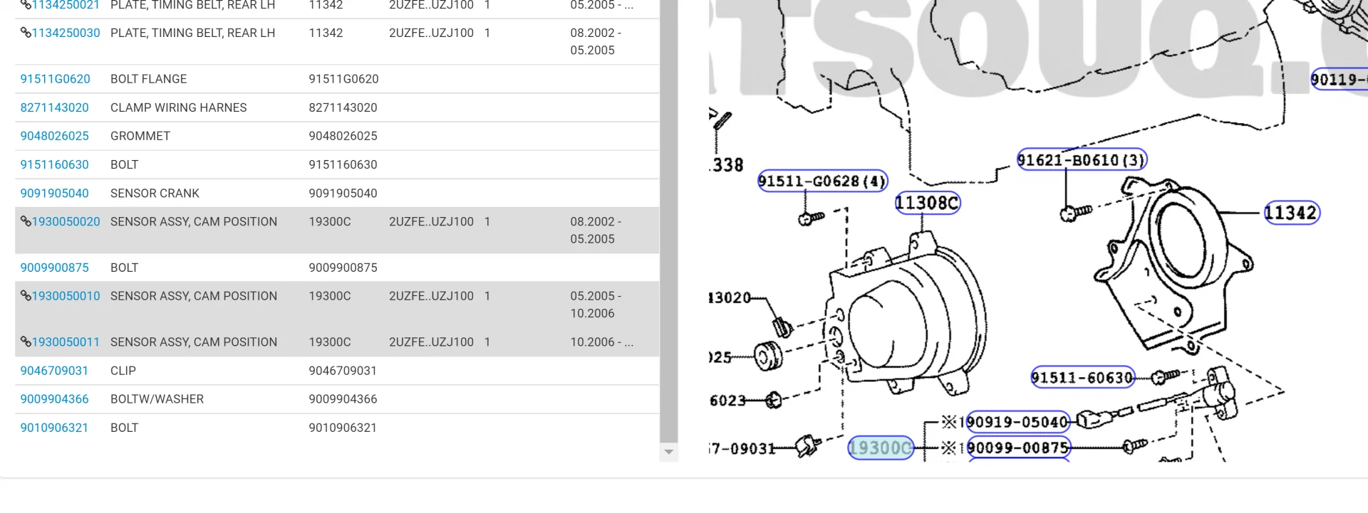

I ordered the Denso Camshaft Wiring Harness. It should be here on Thursday, just in time for this weekend‘s amateur auto repair. Today, I looked around the engine bay, getting familiar with everything that needs to be done for this Saturday. One thing I did notice was the camshaft wiring harness had blue wires like the Denso I just ordered (see photo). Is the OEM the same color or does it look like it was replaced by the PO?

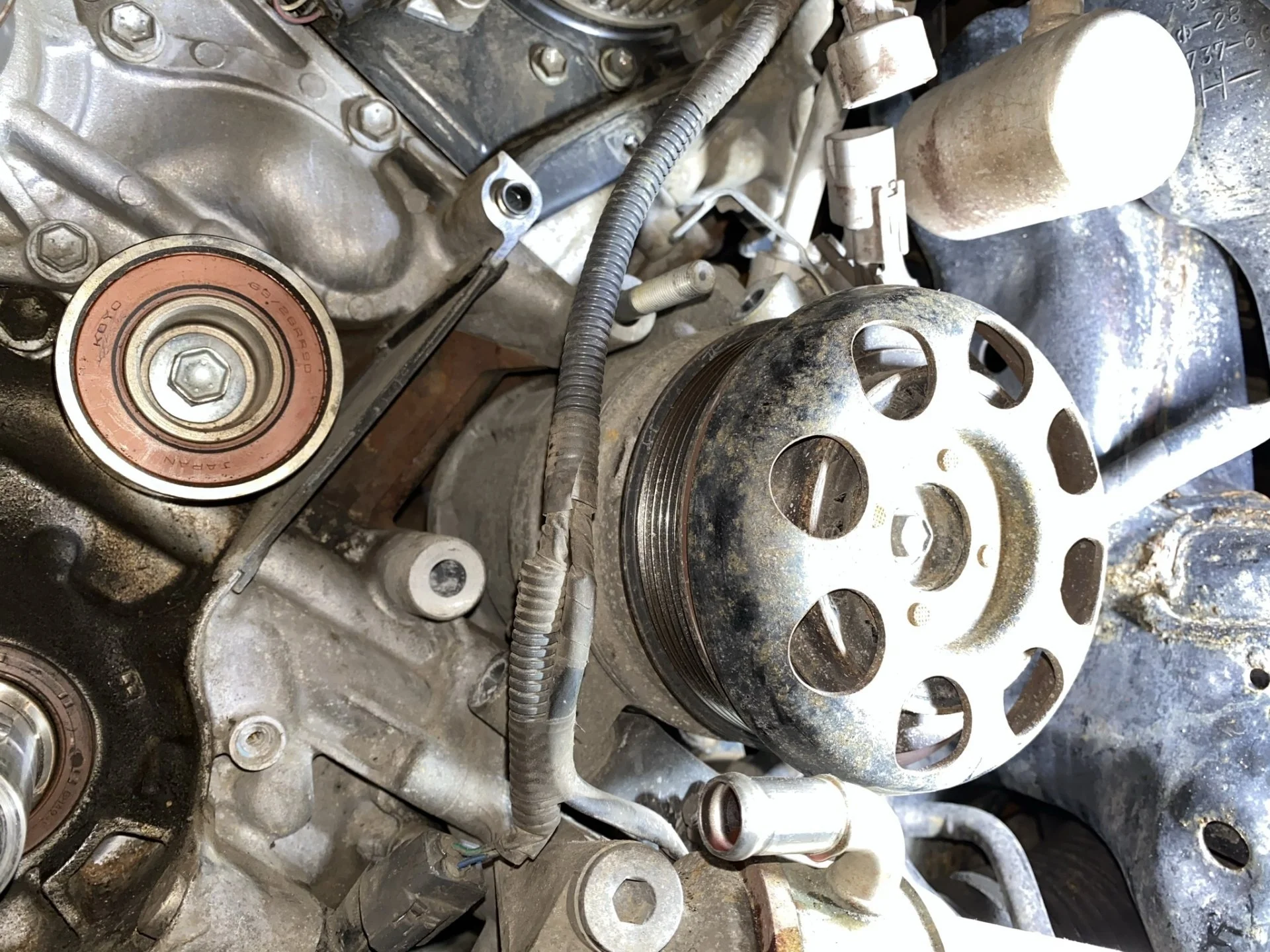

Also, while I was looking at the crank shaft position sensor, I noticed a black sludge on the piece next to the alternator (see photo). Any idea what that piece is or where the oily sludge is coming from?

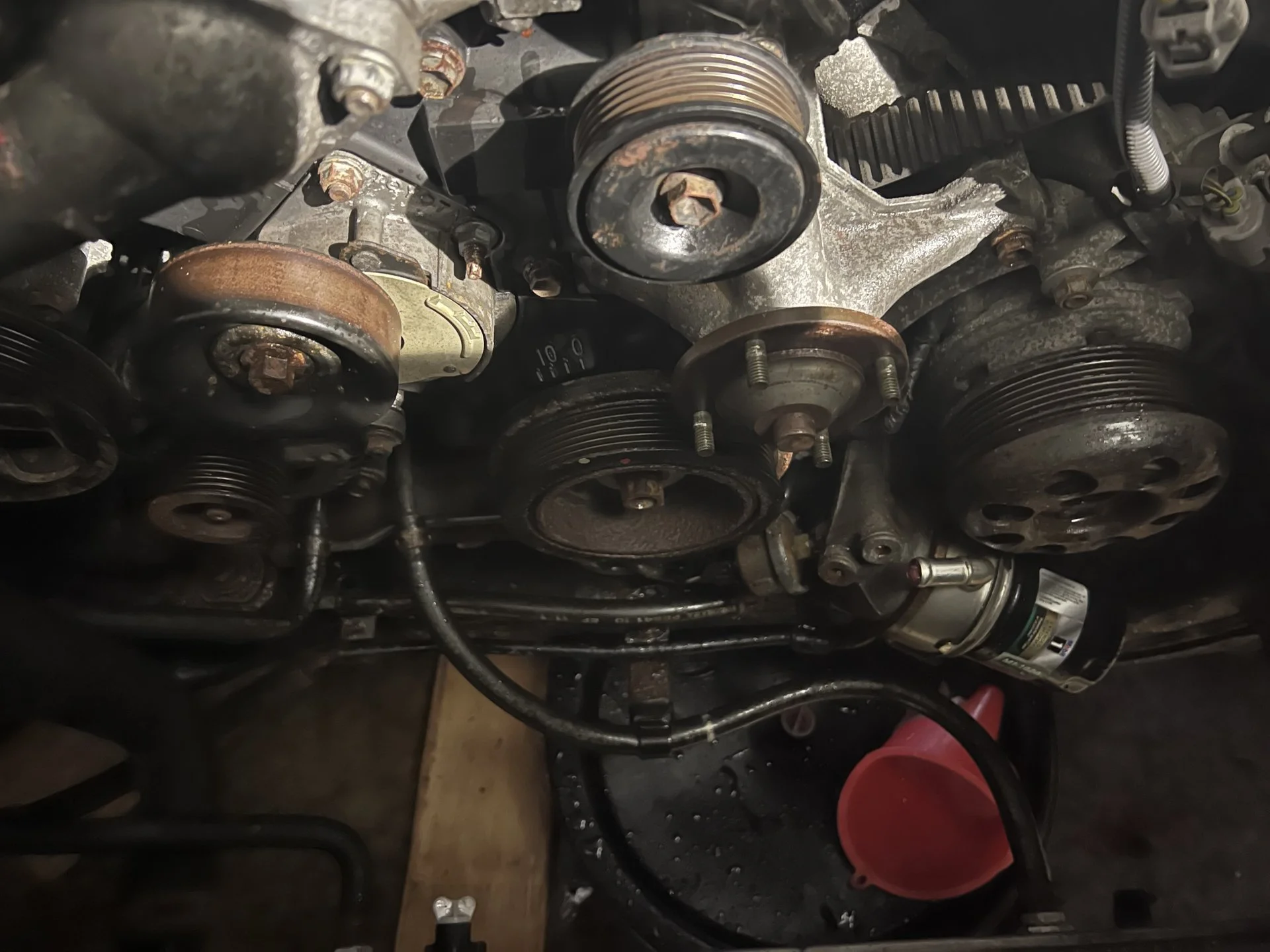

Today, I started working on Gracie to inspect the wiring for the Crankshaft position sensor and the Camshaft position sensor. I started by draining the coolant and removing the fan shroud and fan/fluid coupling assembly, which took far longer then I expected. Once I removed the four bolts from the pulley and the fan/fluid coupling assembly, I figured I was on easy street. I quickly found out the clutch was stuck to the pulley and no amount of pulling would set it free. A quick search on the forums led me to a post titled “HELP! Fan pulley and fan stuck on fan bracket” (HELP! Fan pulley and fan stuck on fan bracket - https://forum.ih8mud.com/threads/help-fan-pulley-and-fan-stuck-on-fan-bracket.1139803/). Per 2001LC’s instructions in that post, I went out and purchased a brass punch set, chisel set, and a pry bar. After a few hours of light tapping with a brass punch on the clutch and soaking with PB Blaster, it eventually gave a little bit. I then used a chisel and worked it around the area where the pulley met the fan until I had enough space for the pry bar. At this point, it took a a few minutes to walk the fan off of the pulley with the pry bar. @2001LC Thanks for the tips in the fan pulley post.

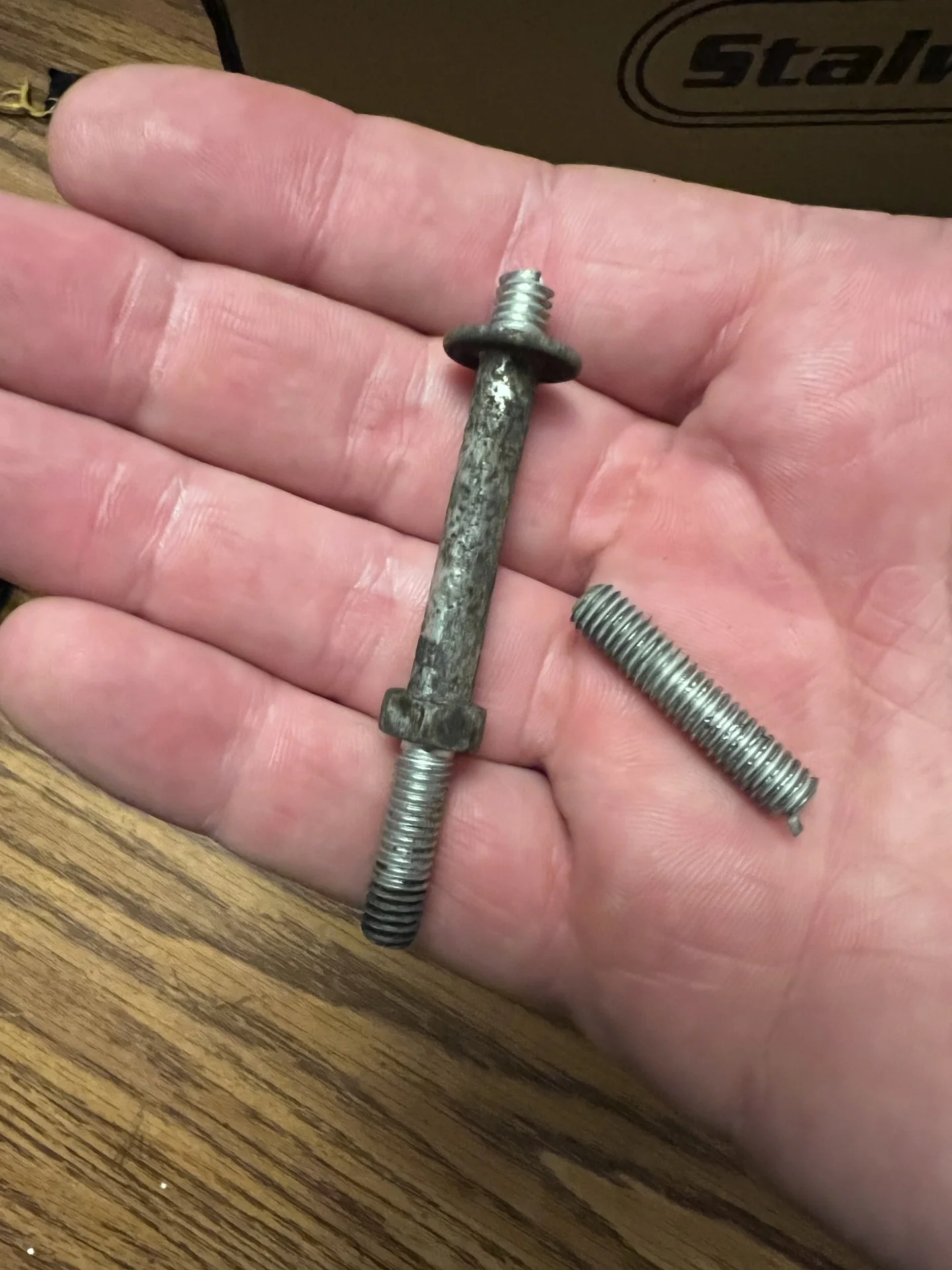

After getting the fan shroud and fan out, I had a ton of space to work with. I removed the No. 3 Timing Belt Cover and replaced the camshaft position sensor (AGAIN). When I reinstalled the sensor, I used a torque wrench set at 65 flbs on the longer bolt (see below photo) and snapped it. I soon discovered my tongue wrench was bad. Thankfully, I was able to easily remove the sheered bolt. I ordered the bolt from McGeorge Toyota‘s website so hopefully it will be here by Thursday.
I visually inspected the wiring as best as I could. None of the wires appear to be cut or frayed. I’ll take a better look tomorrow with fresh eyes. Since I couldn’t move forward with the sensor and I was still motivated, I removed the heater t’s and hoses, which I will replace tomorrow. I also cleaned the battery terminals and posts with a wire brush and used white dielectric grease on them.
Since I have the shroud and fan out, can anyone think of any type of checks or preventive maintenance I could/should do? Any help would be greatly appreciated.
The below photo is the mess I created.
