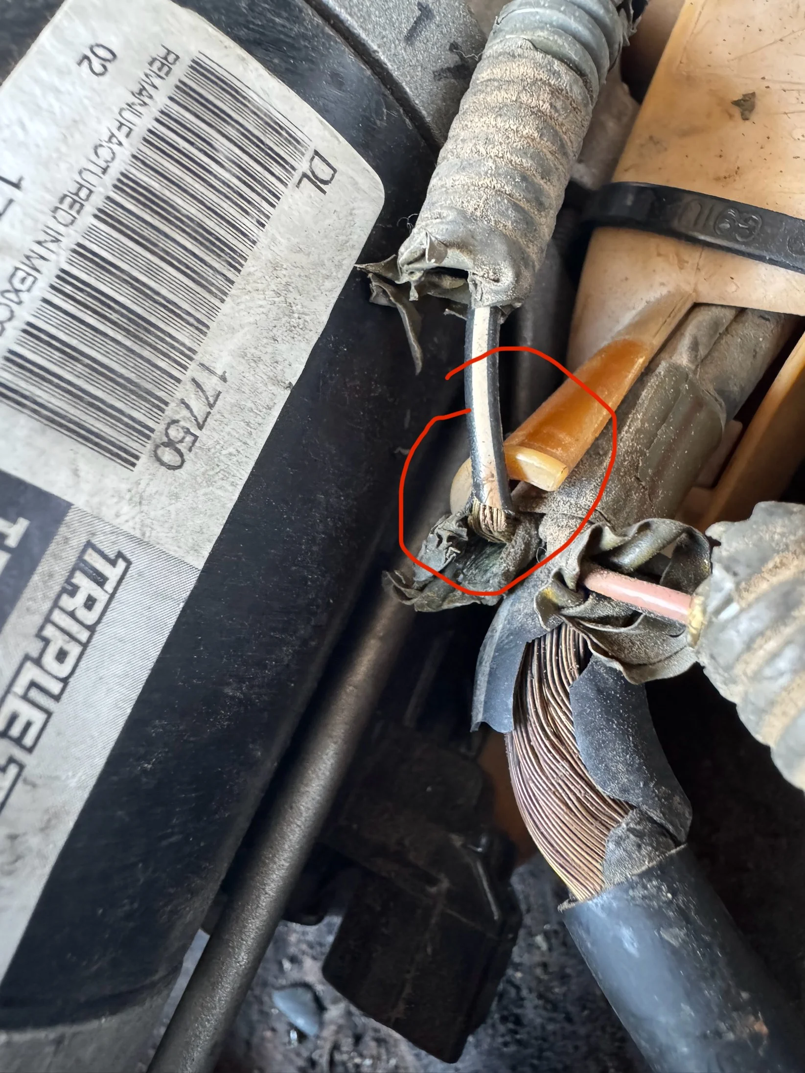

Short located and now fixed.

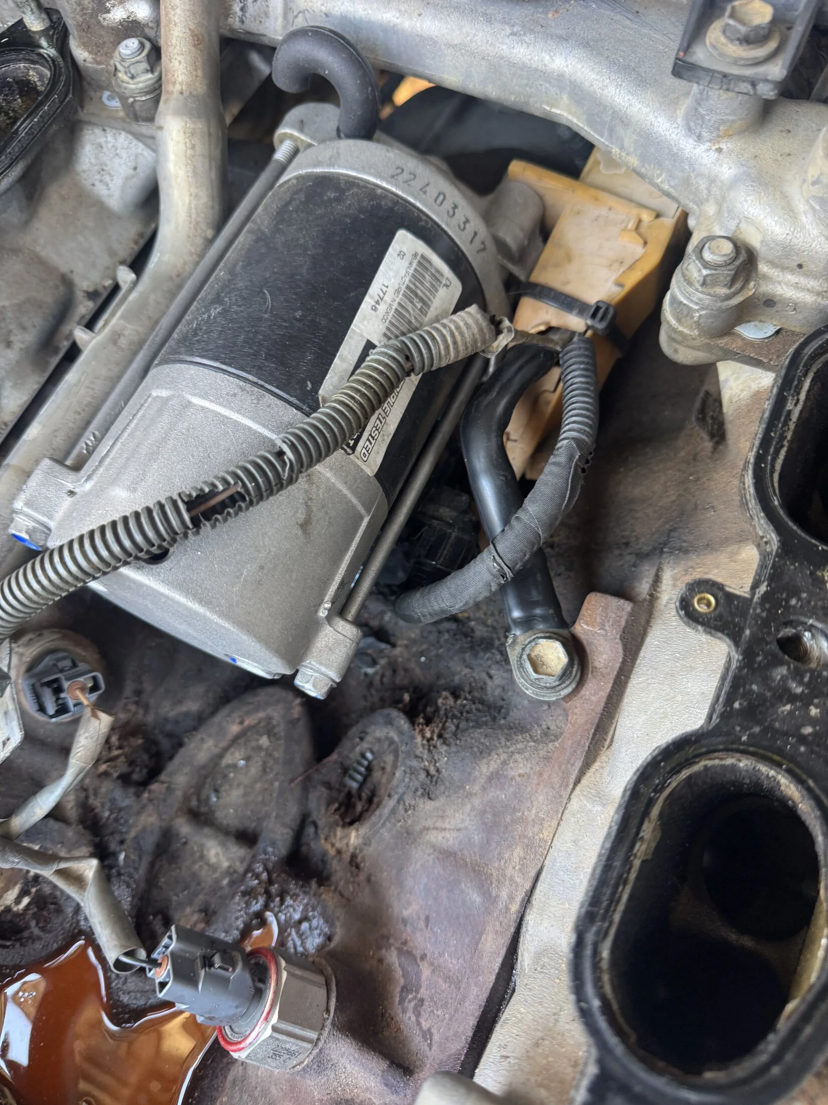

be extremely careful to clean the intake ports,
a good idea to stuff rags in the holes to keep foreign material out
I had rags in until just before this photo. I removed them before I tested the starter. I didn’t want them sucked down when the engine turned over. Right after this photo the intake was re-installed.
Good job!
