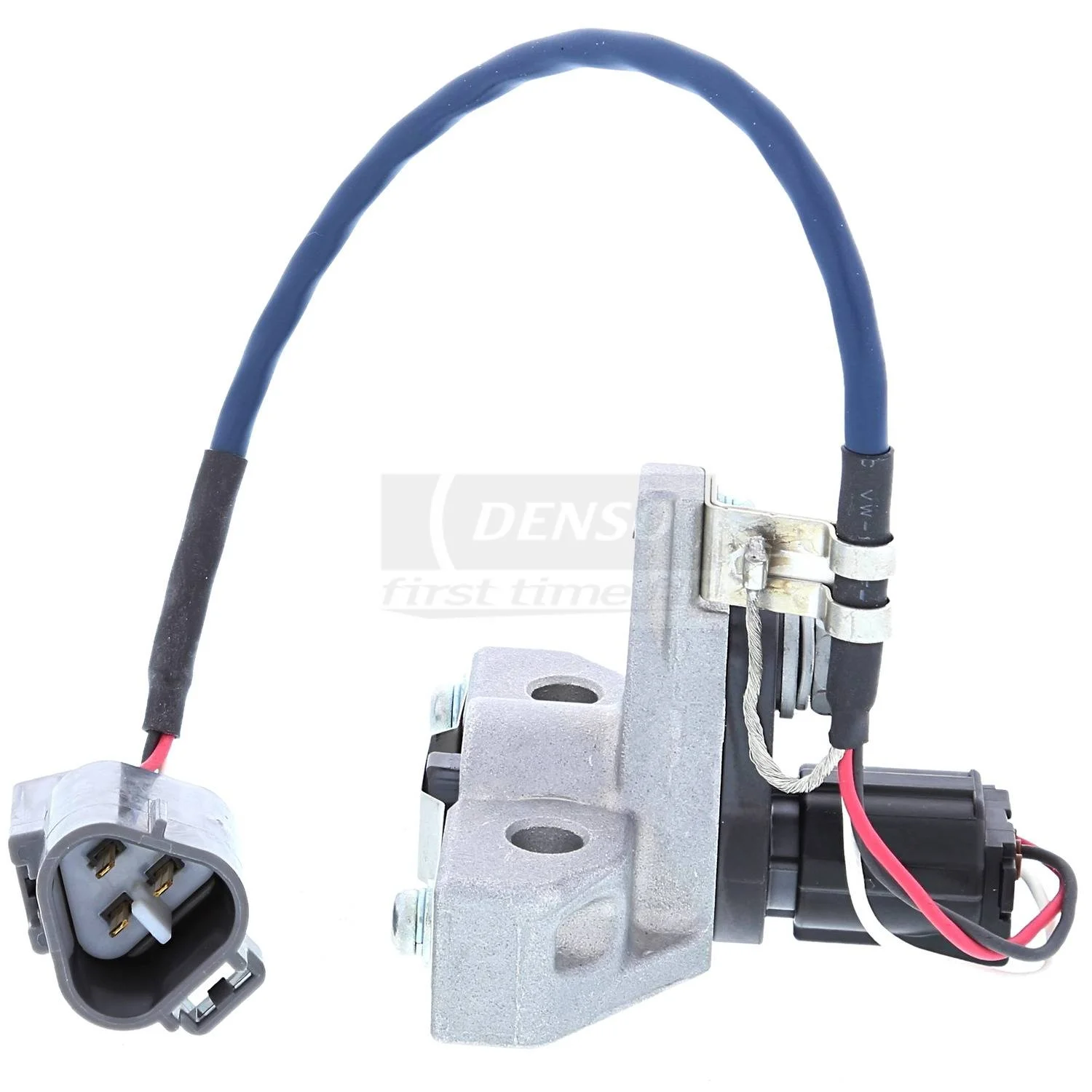

I took a look at the crank shaft sensor wire and it was difficult to see if it was damaged. Referencing the photos in Post #17 (page 1) by 2001LC, it seems like such a tight fit towards the top of the crank shaft sensor wire. I could see how easy it is for the wire to rub against the belt. I think to be safe, I’ll see about having it replaced tomorrow.
While trying to follow the crank shaft sensor wire, I did notice a separate wire coming from the sensor that is attached to the metal housing that holds the oil filter was frayed so that needs to be replaced. Any idea what kind of sensor it is and the part number for the wire? I’ve looked at a number of diagrams on McGeorge Toyota‘s website but to no avail.

both paragraphs, you said crank shaft.
the cam sensor is more easily damaged.
Oil pressure sender is the bottom cylinder with one wire in the video.
Those three items, oil press, crank position, cam position are all on one wire bundle coming down from the drivers side valve cover.
There are multiple sensors required for it to start, those are two of them.
There's an item in the book that talks about a ten second shut down on the cam sensor.
You said something about ten seconds, and in the first post you talked about someone doing the timing belt recently.
Hopefully if someone replaced the cam sensor itself they looked at the wiring that it plugs into.
I don't have an opinion on if it's worth it to pay someone to take it down that far to inspect all three connectors wires. Unless no one has touched them since the timing belt install.
On your own it might be possible to take the drivers side timing belt cover off and get a mirror down there and look up. You see any red black or white wires or the bare shield wire rubbed you'd know it was worthwhile to then pay someone else to do it all, or know that it appeared normal and the cam sensor wiring was not rubbing on the timing belt.
Even mine done at the toyota dealer for the first time before I bought it was a bit wrong.
Second timing belt by me I did find it rubbed for 80k miles and was halfway through the red wire. I just repaired it.
It could be just an intermittent connection. It's extremely easy to make a mistake there upon reassembly.
