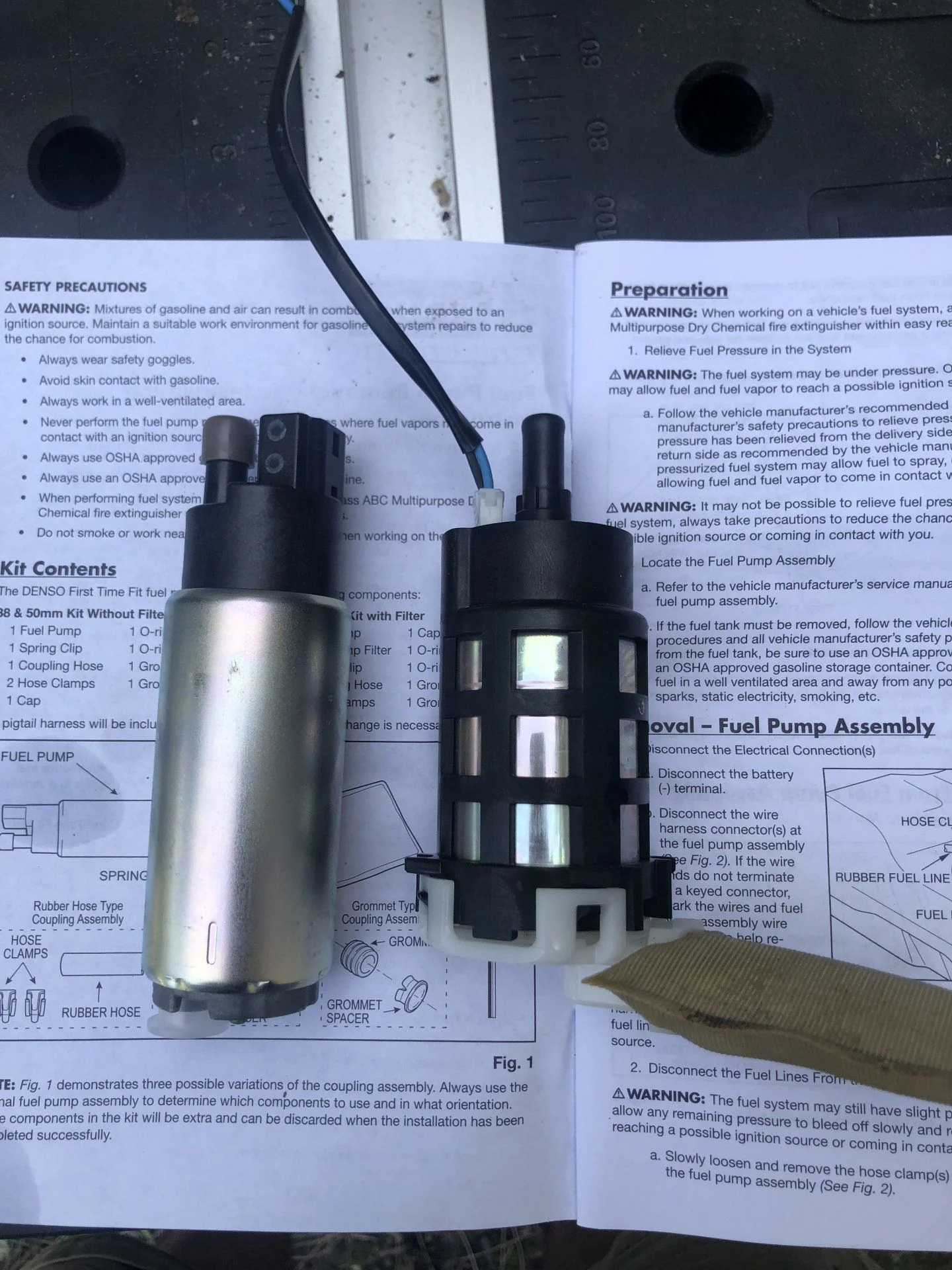

So I’m finally getting to replacing my fuel pump and ran into a problem. I purchased a Denso brand fuel pump but when I pulled the old one out, it looks like someone used an aftermarket pump so the wiring plug is different Smh. Nothings ever easy
