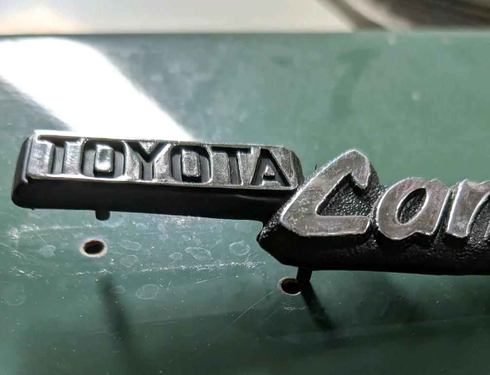

I purchased some fender badges off ebay a while back, now that I am assembling the truck, I noticed two holes line up but the others are off. The little pins on the back that go in the holes snapped off instantly. Does anyone have a part number for the correct badges for a 73 FJ55? Or the most reliable source for reproductions that fit factory holes?

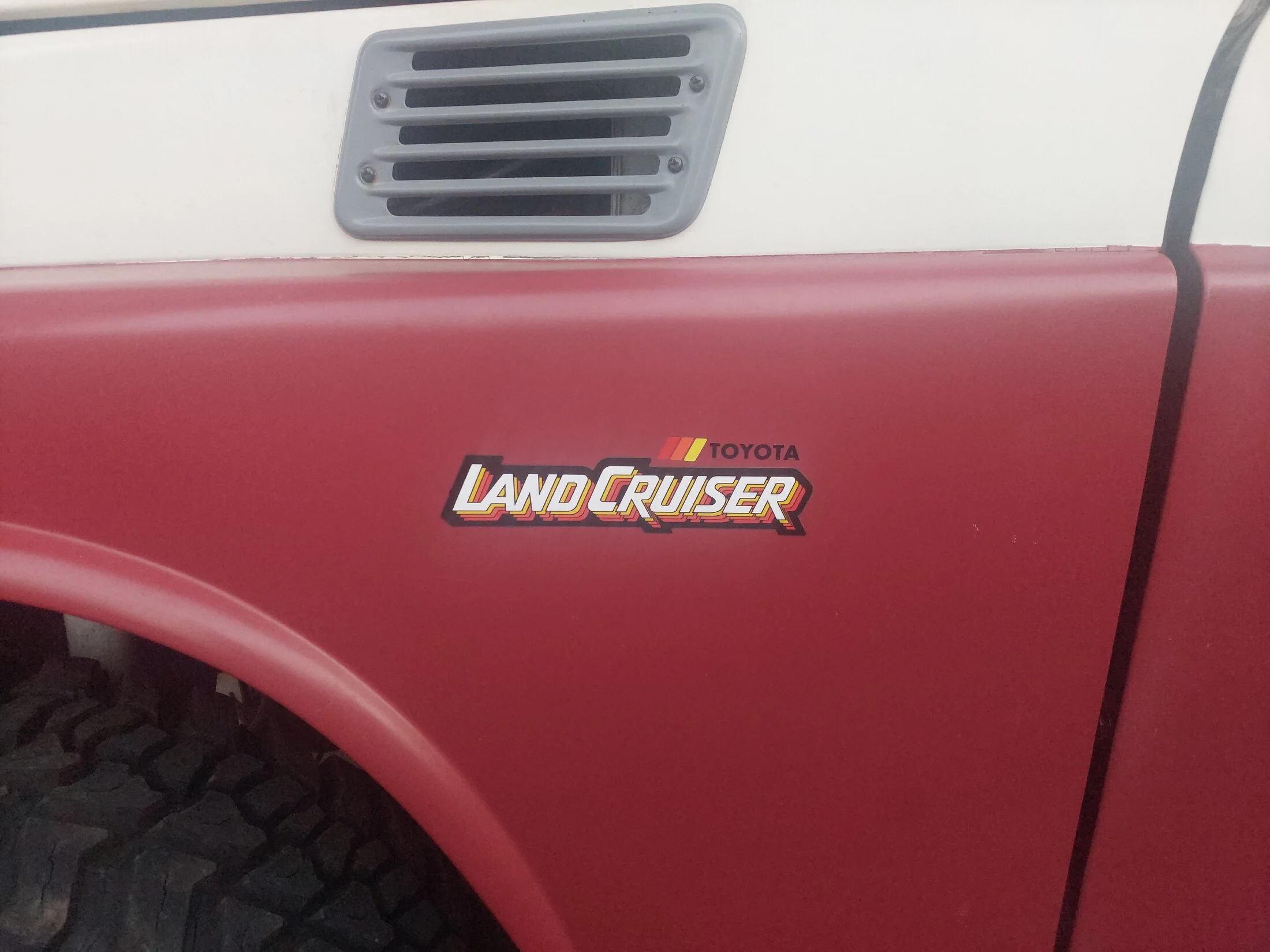

Some times you need to be creative , Show us a picture of your 55 ?

Like this? I started a return and it would cost almost a third of the cost for ship. so I broke off a pin and made them work till I get the real ones.

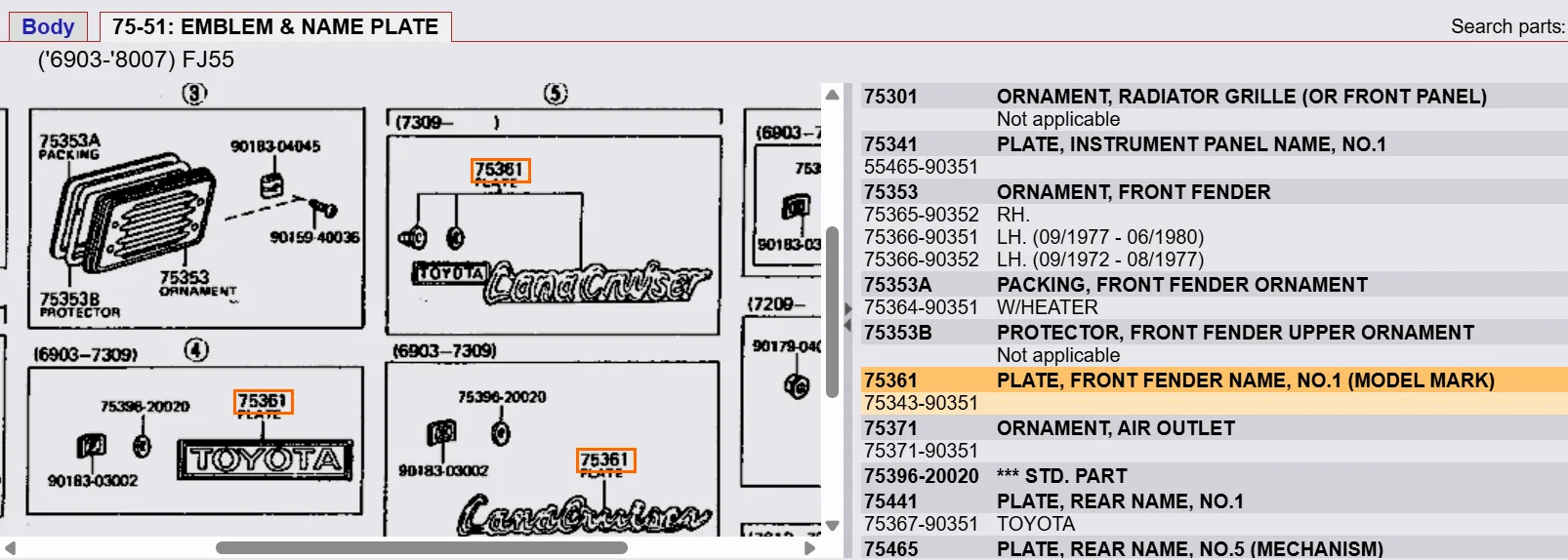

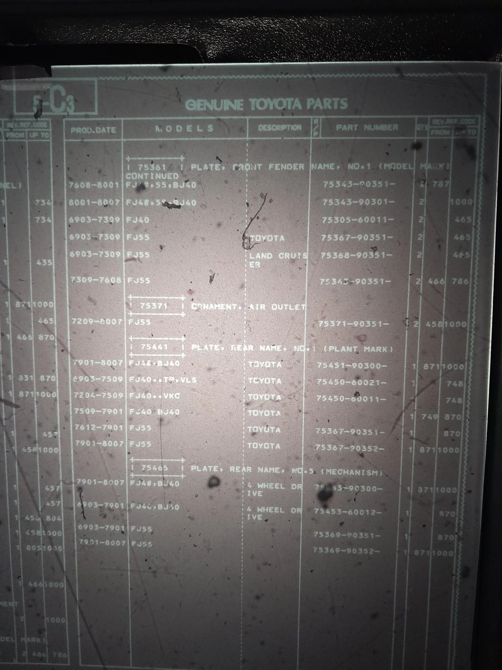

These pics are off of my microfiche set for the FJ40 and FJ55 for the US and Canadian market for the period from 03/69 to 07/80. I was able to get this set from a local Toyota dealer in the early eighties. I apologize for the poor quality, but these microfiche panels are over forty years old and well worn and my viewer is a relic from the past as well. Look at item "75361 Plate". Good luck with your search and project.

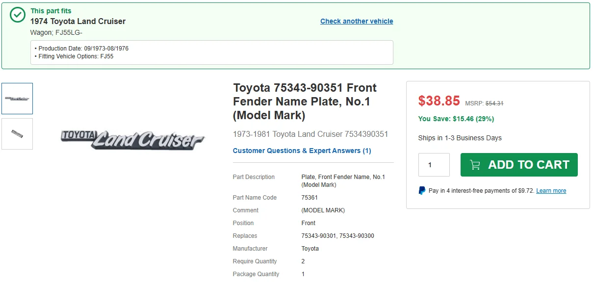

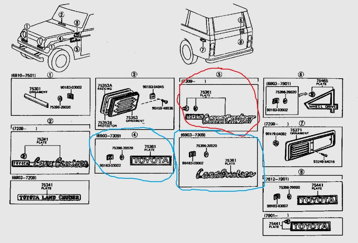

There seems to be some confusion regarding the 73 badges so maybe this information will help. Up to 09/73, the badge was two emblems as circled in blue. For what I assume would be a 74 model year (09/73) and later, it's one badge and, as @Dudleyfj40 posted, it's still available from Toyota.

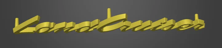

Edit: Here is the 3D of J Mack's STL. file. This helps, thanks!

No they are not close enough to mistake as one emblem. Looks like that file is for "Landcruiser" in the two separate badge variation.
And just to add to the overall confusion. As you can see below, the single emblem (09/73 onwards) and the two badge solution (03/69 - 09/73) have the same part number.
Your highlighted number is not the actual p/n. See my post above with actual p/n's. That may clear up some confusion.

So if it where me and I was just trying to get something on my fender that looked appropriate I would use the file I provided and get it printed in plastic and use one of the many inexpensive "chrome" looking coatings.
There are many but this is the first to pop up on my search.
If I wanted to have an ultimate cool badging for my show pig then I would send me a PM and I'll machine you some out of brass and send them to Ogden Chrome and have them do their show plate. Either way if one couldn't be found on the secondary market we have options to make them.
I forgot to add there are several places that will 3D print in stainless steel that can be polished to a bright finish again using the file I've provided.
