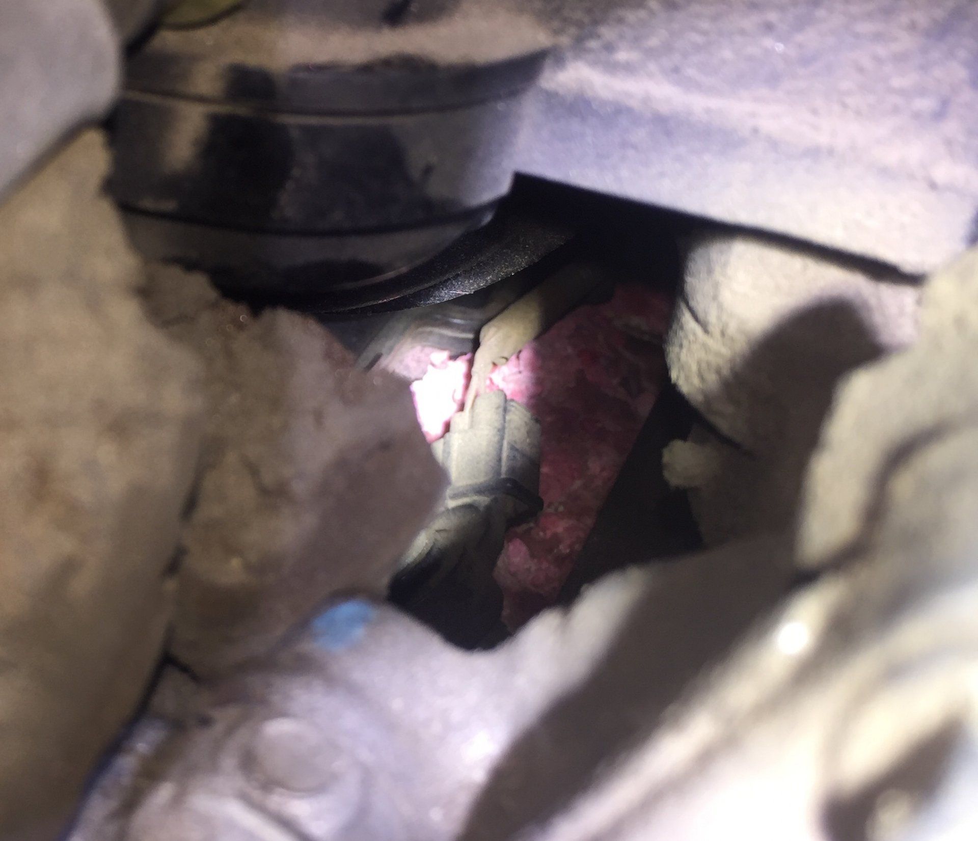

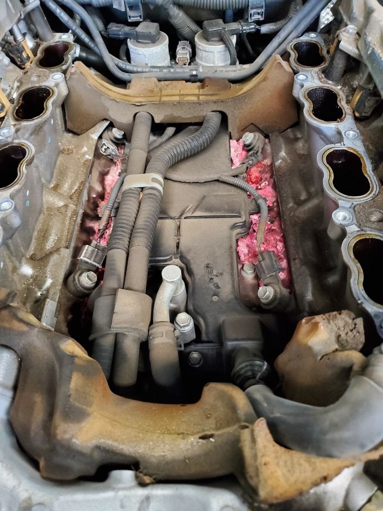

Got it! Although we won’t know definitively that this is the issue, it appears I have a hefty coolant valley leak. There is quite a bit of built of pink crust so my assumption is that its been going for some time and I’ve lost enough coolant that the temps can no longer stay controlled. Will likely incorporate a few other obvious coolant system updates while we’re in there but I think we can assume this is the primary culprit. Thanks @bloc for the tips on which foam to pull.
Damn. Yeah, this is a bigger issue than the radiators. Less common, way less likely to be spotted, and slow enough that people often don’t see anything on the ground or even smell anything.
Still, with those high temps get your coolant tested, or maybe send off an oil sample for analysis. They’ll catch coolant in the oil far earlier than you’d see sludge under the cap. IF you need a head gasket and it’s at that early of a stage you can often get by without any work to the block or head beyond a good cleaning.

At the risk of being the outlier here, and looking at your first posting, I think there is something else going on. The valley leak is messy but ultimately it is relevant only in that it reduces coolant available. "Rowing" through gears to 55 mph is not a serious heat strain on this motor. Down two quarts does not lead to a pegged temp gauge though I have never had that happen actually. So I think there is something else going on. I would drive it, monitor it closely, and expect to find something else. A collapsing hose would be my first guess. Good luck. It would be great if I am wrong.
If you have a known leak in your cooling system and you need to keep driving, then I would top off the radiator when it is cool and leave the cap loose a 1/4 turn open but still locked in place. The cooling system will not build pressure, just expand and contract with temp.
The location of the slow leak is low enough to create a void of cooling fluid that moves from the block to the radiator causing the hi temp spike when you get on the throttle that is connected to the water pump that runs out of fluid then gets fluid back after gravity returns the fluid level back to the pump.
This is the same thing happening when a cracks opens up on top of the radiator except that this leak is within the block.
Remember this method when out on the trail or away from service on any water cooled engine.
Good advice from 4gotalot. Coincidentally, a friend brought a vehicle by our place to use a rack to find a coolant leak just last week. It leaked badly. We could not really find it. He loosened the cap, thereby reducing pressure (lowering the boiling point and heat transfer capacity of the coolant) and the leak stopped. Permanent fix. Of course not, but it might get you home without damage.
