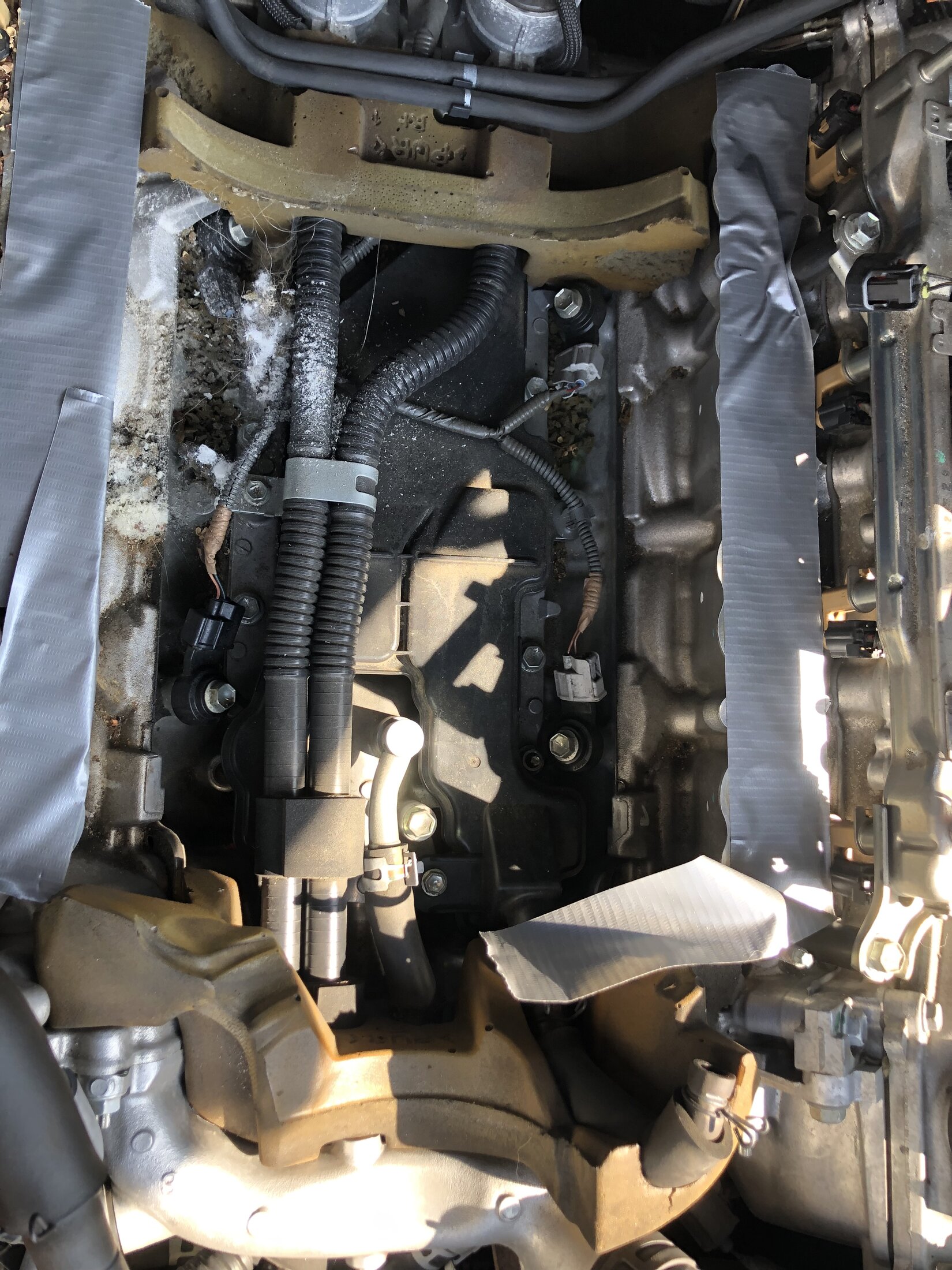

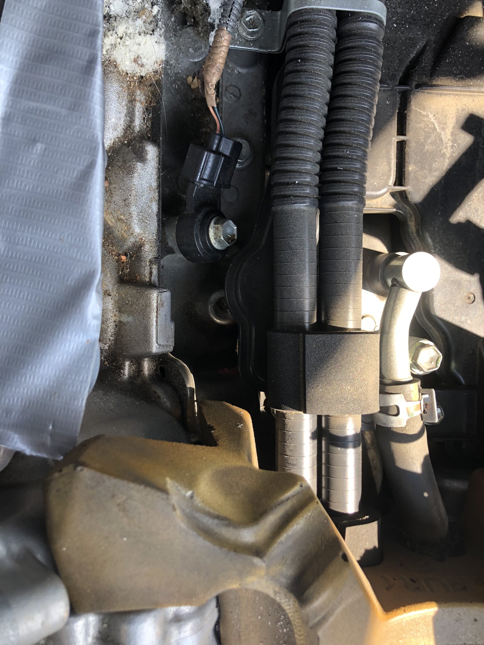

Manifold off, coolant spotted in the front section under the manifold, valley plate leak?
Definitely a small valley plate leak, and they are often in that specific corner.

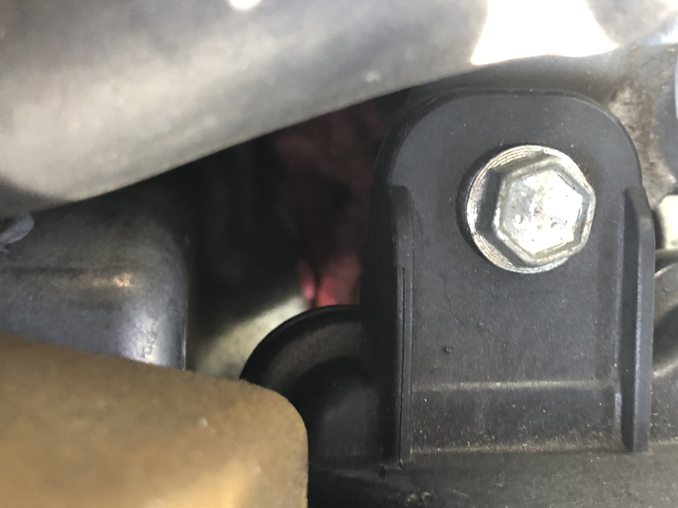

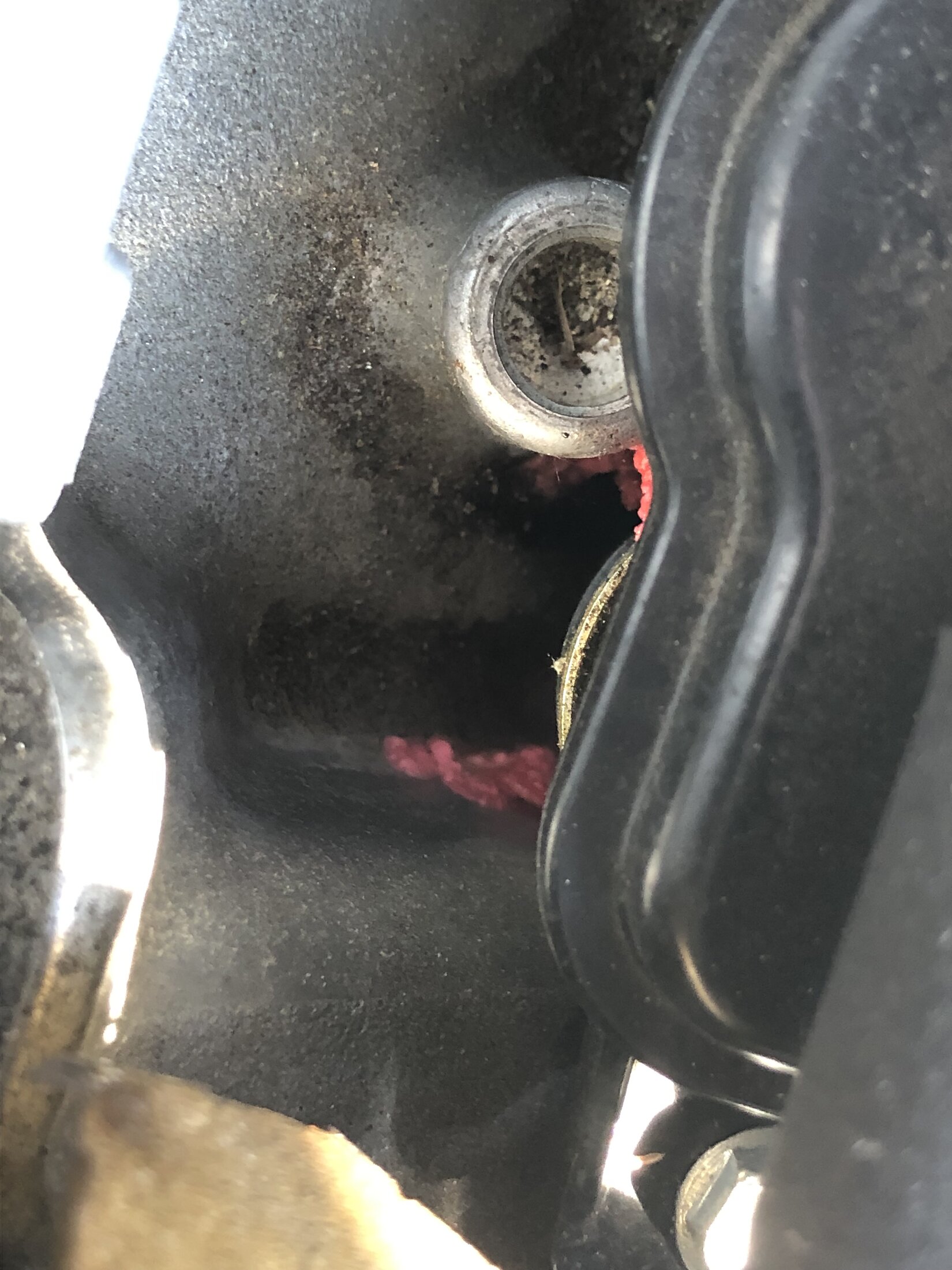

When you clean up the mouse nest inspect the wiring there for any chewing. That is a small, relatively cheap sub-harness for the knock sensors and easily replaced when you have the manifold off again.
