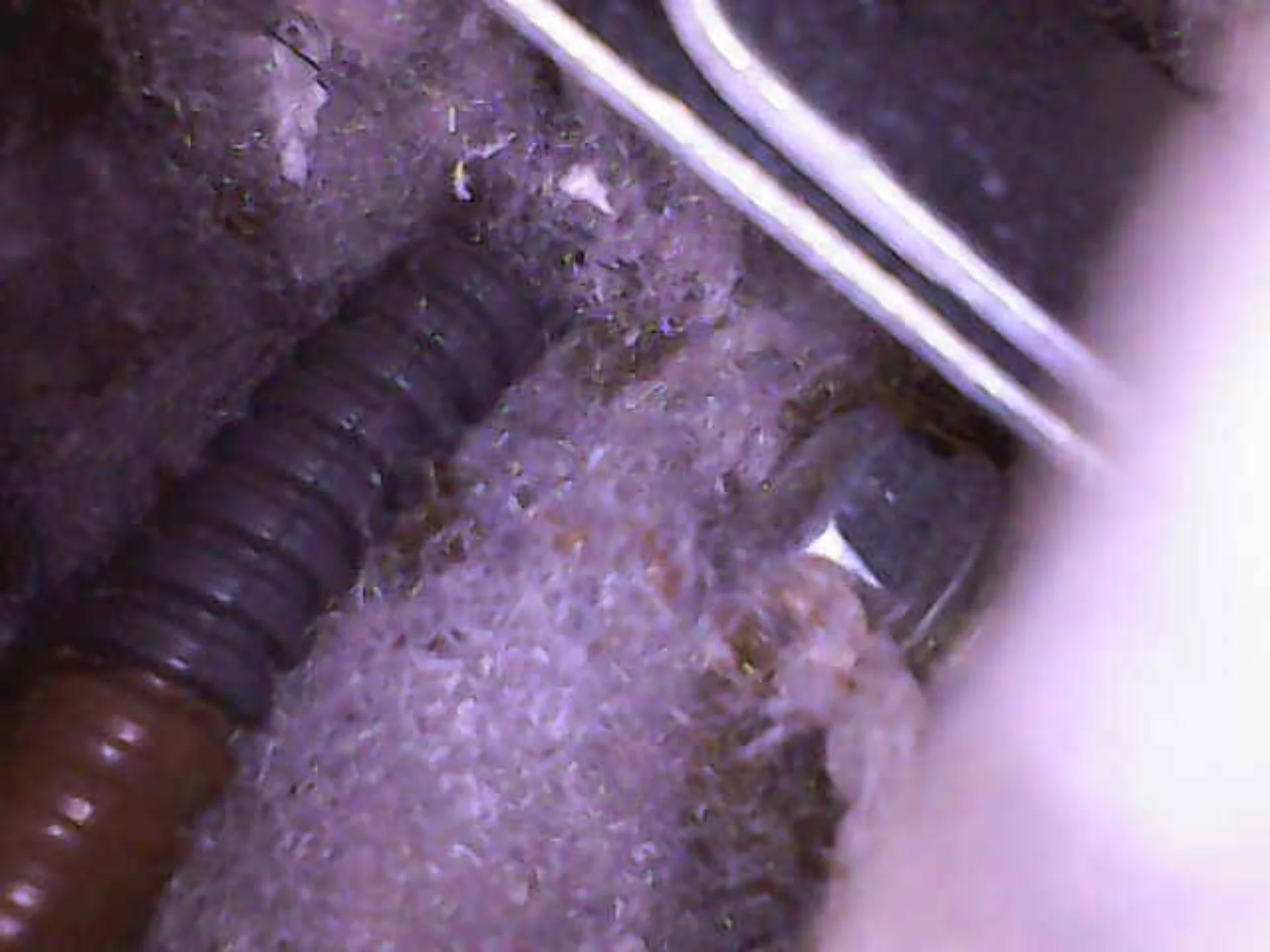

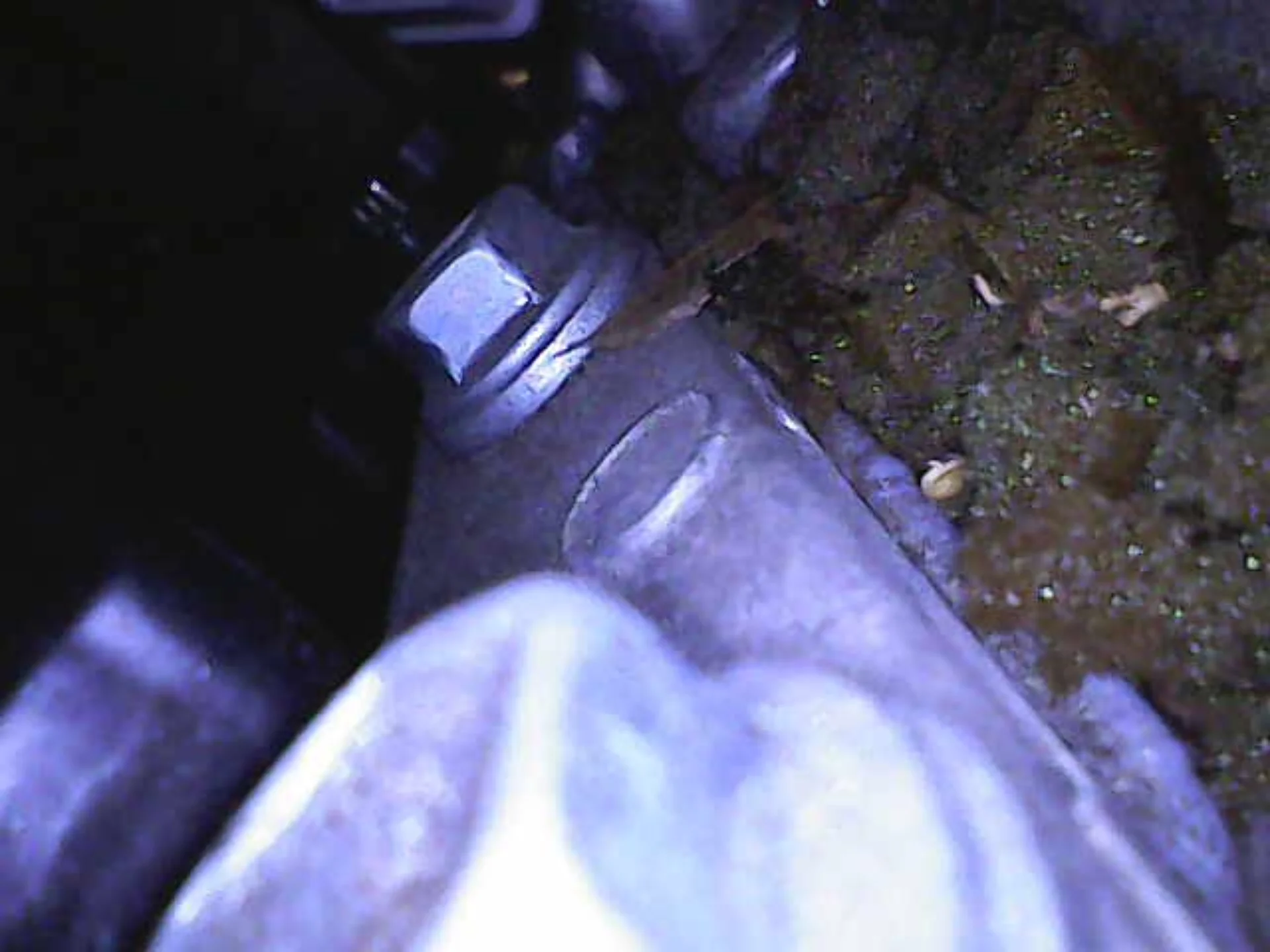

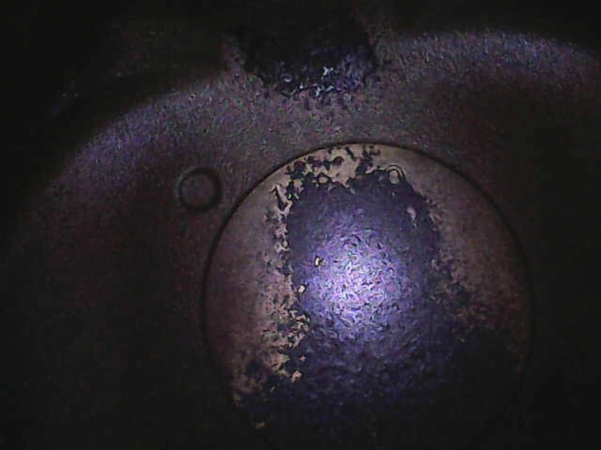

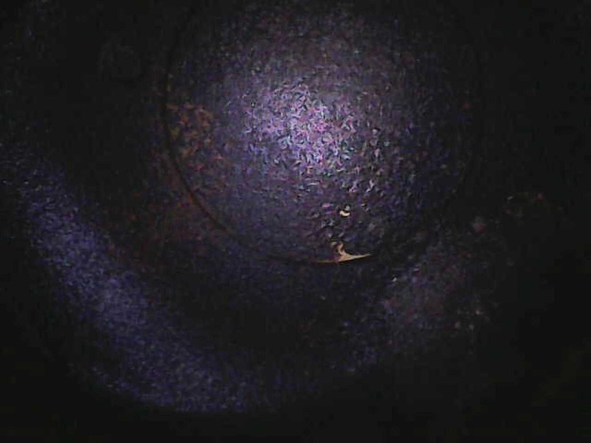

Here’s an update. Borescope pics if anyone has insight, piston 7 and piston 5 are pictured. I believe piston 7 is where the HG leaks typically exist. And a bunch of shots from under the intake manifold, not sure what to make of that? I can’t tell if that’s coolant or if that’s an old mouse nest? Would love to hear thoughts

That is a mouse house in the usual area under the intake
Pull a couple more plugs and scope the pistons to see if the carbon levels are about the same across the jugs.

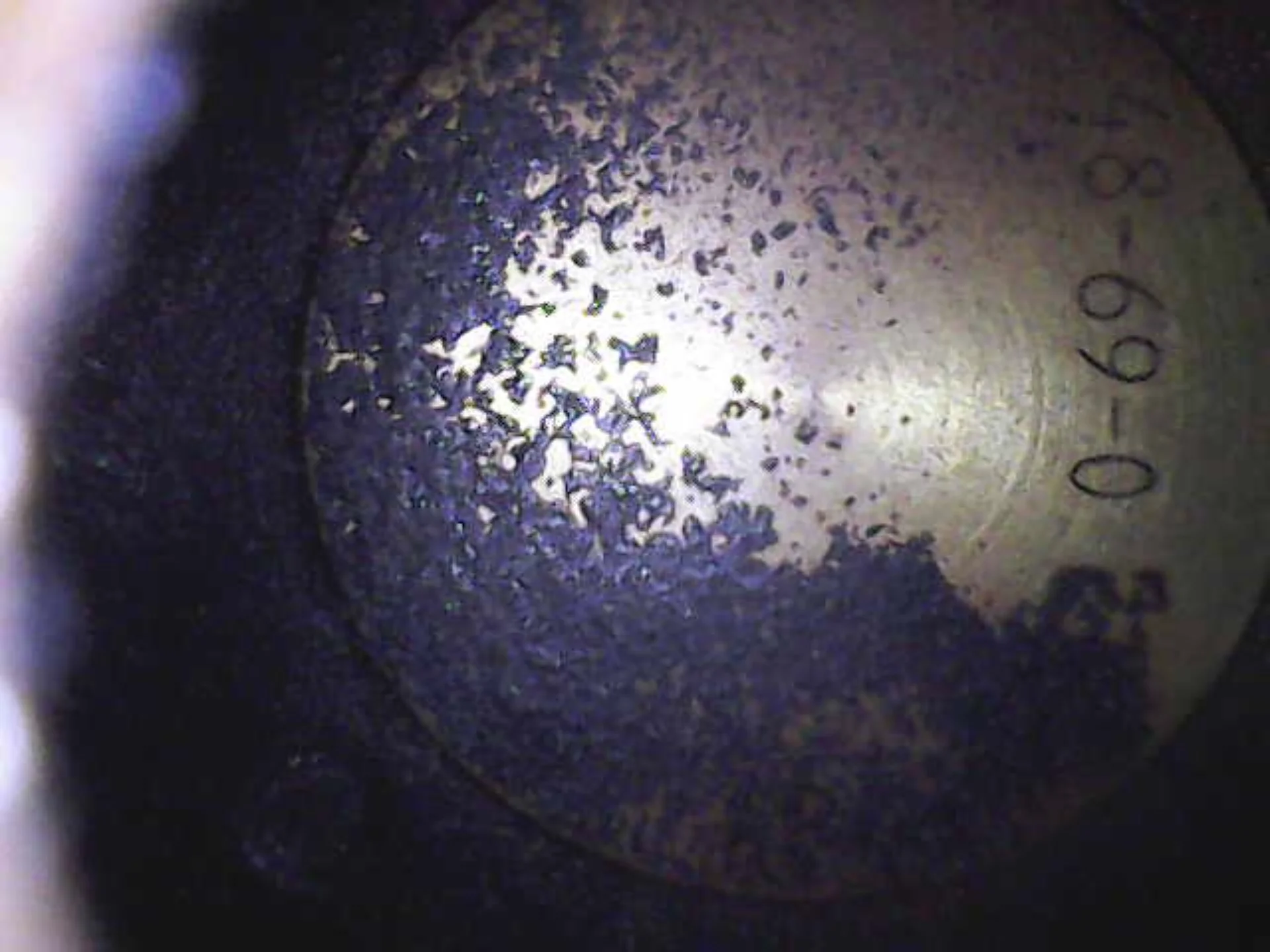

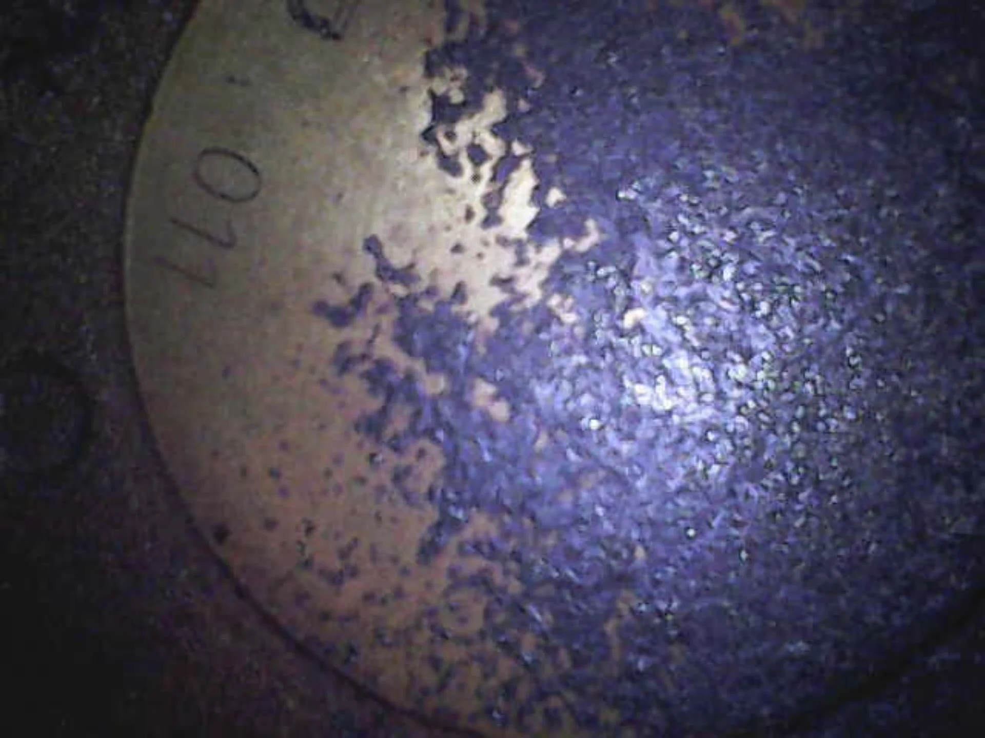

Cylinder 3 and cyl 1, that’s the whole driver side bank

Nothing super obvious from those photos IMO, though cyl 1 looks a lot dirtier and 7 the cleanest... You could also pull the passenger side plugs for more info (it can blow there too).
But it looks like you'll want to get the intake off no matter what to clear out the mouse nest to properly check for evidence of the valley leak.
Yea 7, 5 and 3 have some clean areas. One definitely the dirtiest. The pass side I have to remove the air box and whatnot to get to those plugs. I’ll try tomorrow and see how that goes. Would love to see pics of anyone else who scoped their pistons to see what they look like

Plan on a couple hours, order the intake gaskets and might as well get a new knock sensor harness. Pull the intake, put painters tape over the intake runners, then vacuum out all the mouse crap. Then you'll know for sure if you have the valley leak. Highly recommend you "armor" the new harness with extra loom and lots of high temp electrical tape before installing.
