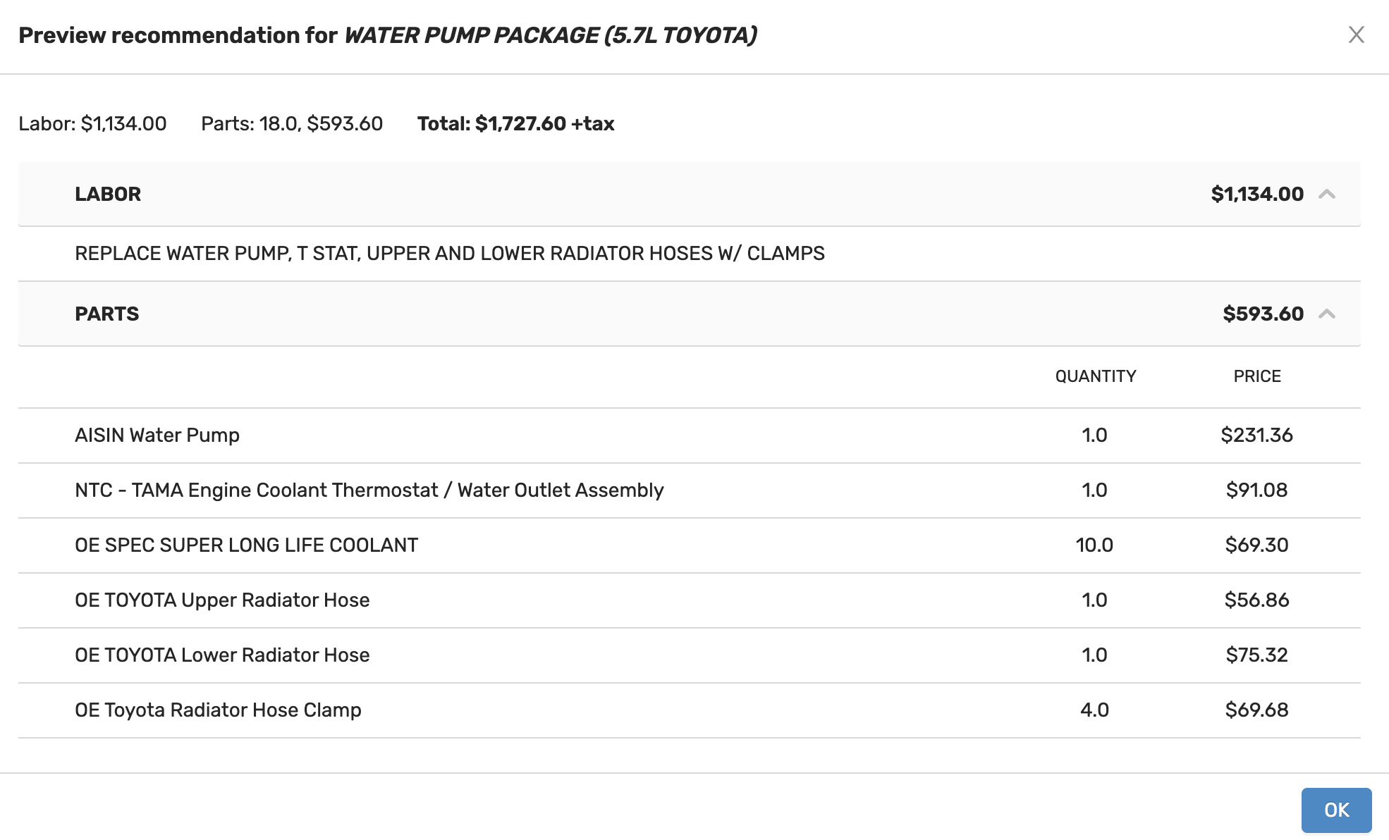

Looking at the estimate (and keeping in mind they have not seen the vehicle yet), it appears they are suggesting the following work below which totals $1,727 + tax. It sounds pretty steep to me, but they are replacing hoses as well which is good. Any thoughts if this seems fair?

I paid $1049 for the water pump and thermostat replacement including coolant at the dealer. No new hoses since mine were done a couple years ago. That price is nuts. Also there’s NFW they could use 10 gallons of coolant, so unless that’s in quarts that is outrageous

That has to be quarts because the extended cost of the coolant is only $69. Considering 4 quarts at full MSRP is only $27, $69 still sounds really expensive for 6 quarts. While I have generally had good luck with this shop, their prices have gone up 200-400% across the board since I started using them about 6 years ago. It's nearly impossible to find great work at a great price though these days unfortunately.

10qt sounds pretty excessive for a water pump. That’s more along the lines of a full radiator replacement.
