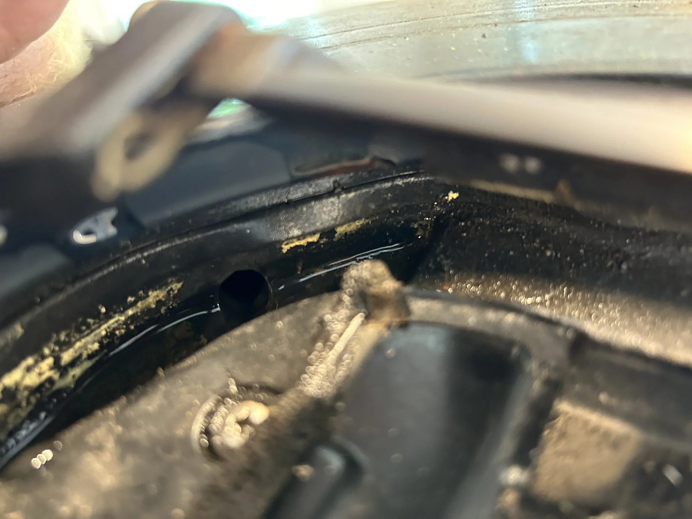

Driver front drain hole at sunroof:

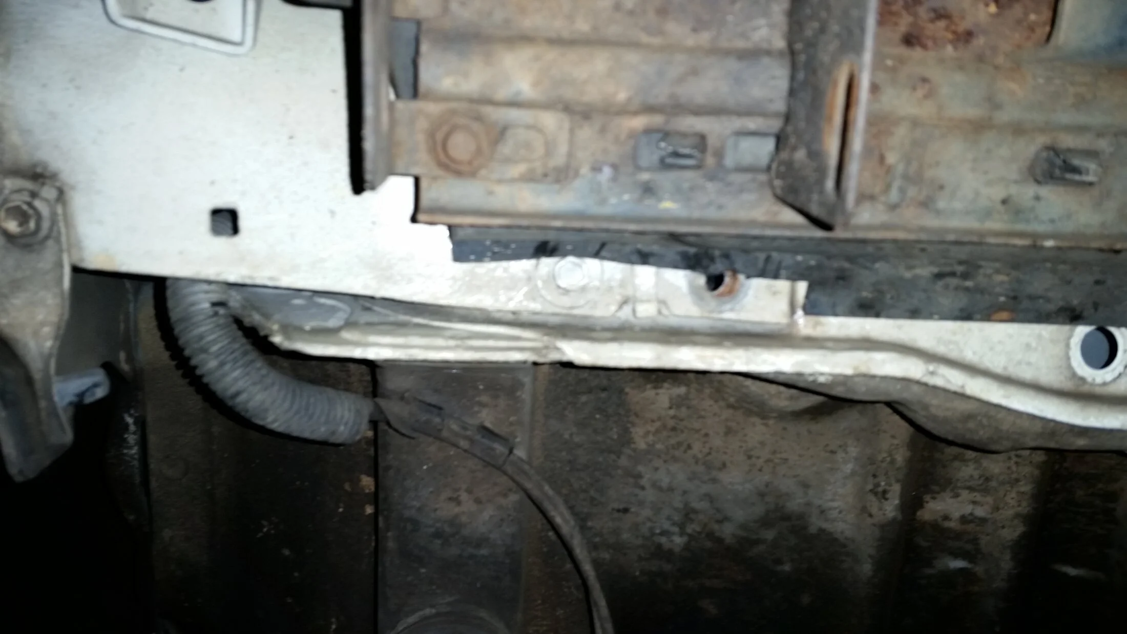

Example of pinch weld slot. I just jammed zip ties up there to make sure they were clear. I’ve got sliders. This is driver’s side.

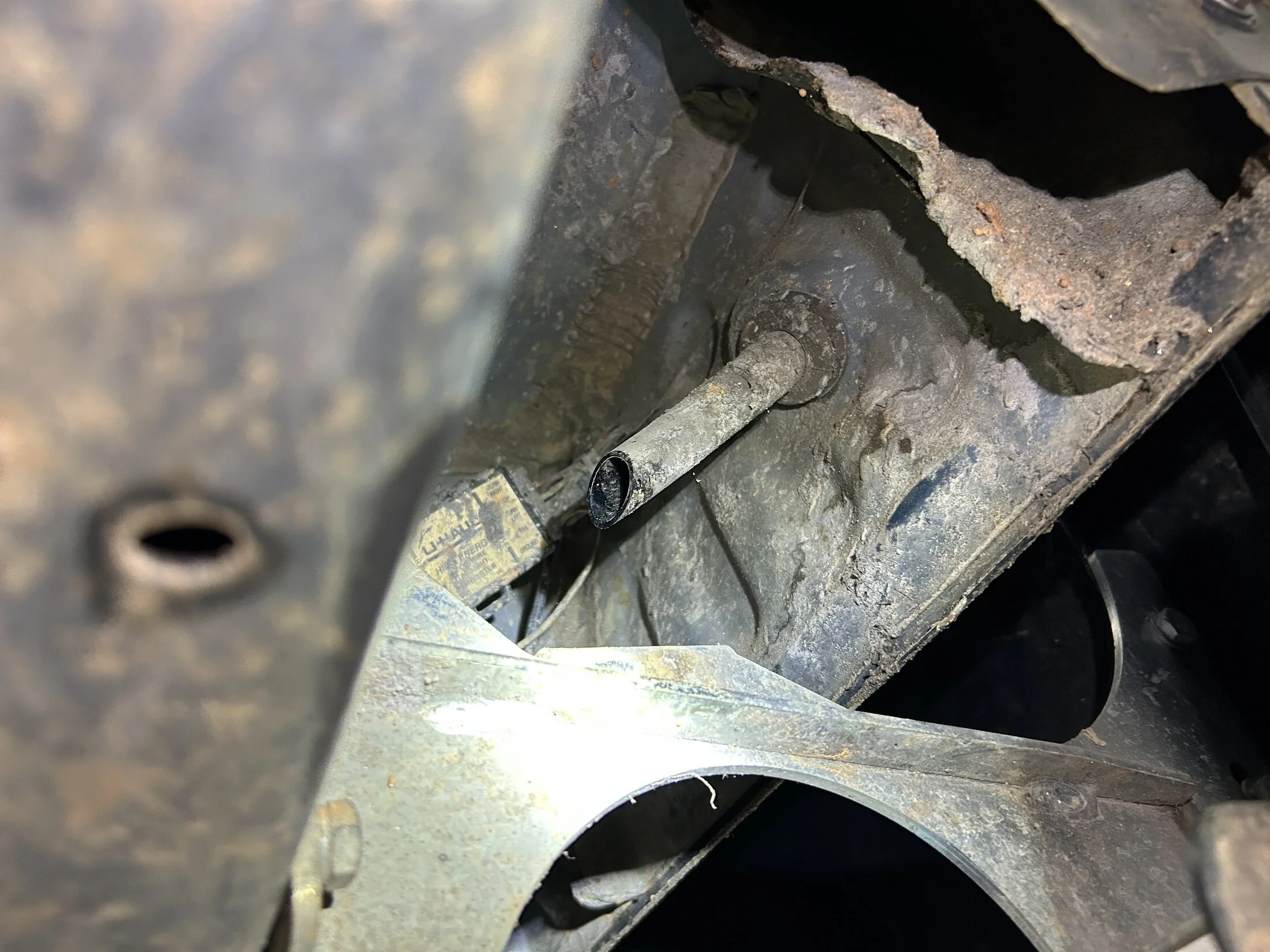

Rear drain hose. Also driver side. Look behind rear tire aiming towards factory spare location.

The one issue I did find, was that there was sludge/grease/dirt build up blocking the passenger front drain hole at the sun roof. There is a lot of debris/dirt/grease inside the sunroof channel. I'm going to need to remove my roof rack so I can take the sunroof out and really clean that out well. That will certainly help things.

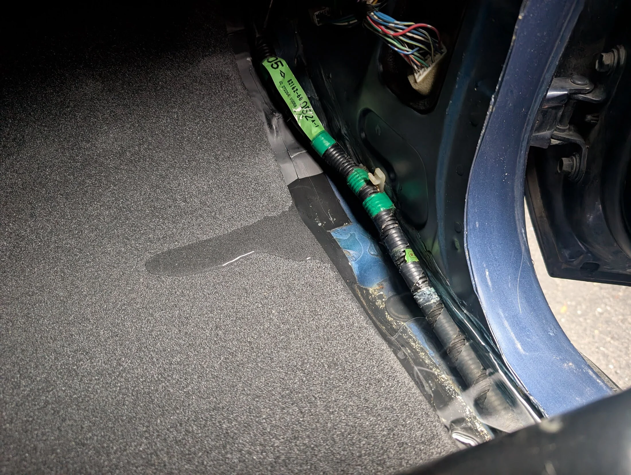

as i wrote in the "what did you do over the weekend" thread last weekend, i've found water on the passenger side floor. thought i'd solved it over the weekend with opening up the forward drain slit, but an big overnight storm proved otherwise
truck was pointed nose down again, to test the forward drain. hard to tell in that pic, but that is standing water in the harness channel.
while i could try and probe out that forward slit with a zip tie again, i'm not expecting different results. drivers side is bone dry, so i'm at a bit of a loss why the passenger side is filling up. the way i'm parked, the slits are uphill of the rocker pockets a good bit, so not sure why my drivers side is clearing itself but the passenger side isn't.
i tried to figure out where the hose terminates, and if anything is clogged in that pocket, but i wasn't able to tell. the hose is kinda flapping around in there, which i believe is normal. any tips on cleaning out that pocket? is the next best thing to remove one of those forward bolts? i have the inside plug out currently, but i'd prefer the water never even get into that harness channel and drain outside.

so my hypothesis is forward slit IS draining better than last week, but the heavy rain still overwhelmed the slit and it backed up into the cabin harness channel via the hole the loom clamp clips into, and then couldn't escape. yet the drivers side doesn't have the same issue, which has me scratching my head
