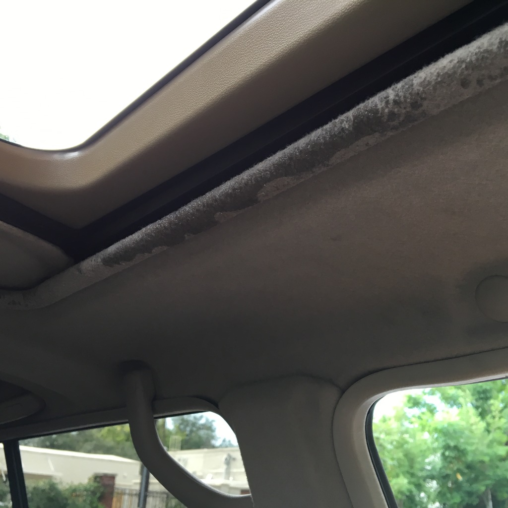

2. This is what my leaky sunroof looks likes

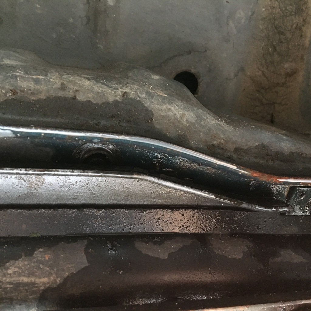

3. In the center left portion of this photo you can see a hole where I removed a rubber plug. When the plug was removed, I saw what looked to be the shrink wrap that binds a wire harness. Is this the plug that's supposed to be removed to help drain out the sunroof drains?

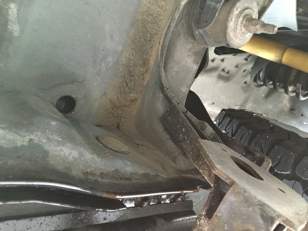

4. A few inches up from the center of the photo shows another drain plug found towards the rear of my vehicle. Is this the rear sunroof drain plug? (I have a 1996 LX450 which I believe I have seen others say has front and rear sunroof drain lines)
5. This last photo is supposed to show the underneath of my rocker panel and step-up thing. As you can see, all the water seems to be flowing out of this, and not from the hole where I removed the rubber plug. When I flood the sunroof drain area, the water on the passenger side slowly drips out from the underside of the step-up thing. It drips from about four different locations from the underside of the step-up. No water came out from where I removed the black rubber plug. I think I saw another small plug located between the step-up and the rocker panel. Is that the actual plug I'm supposed to remove?
