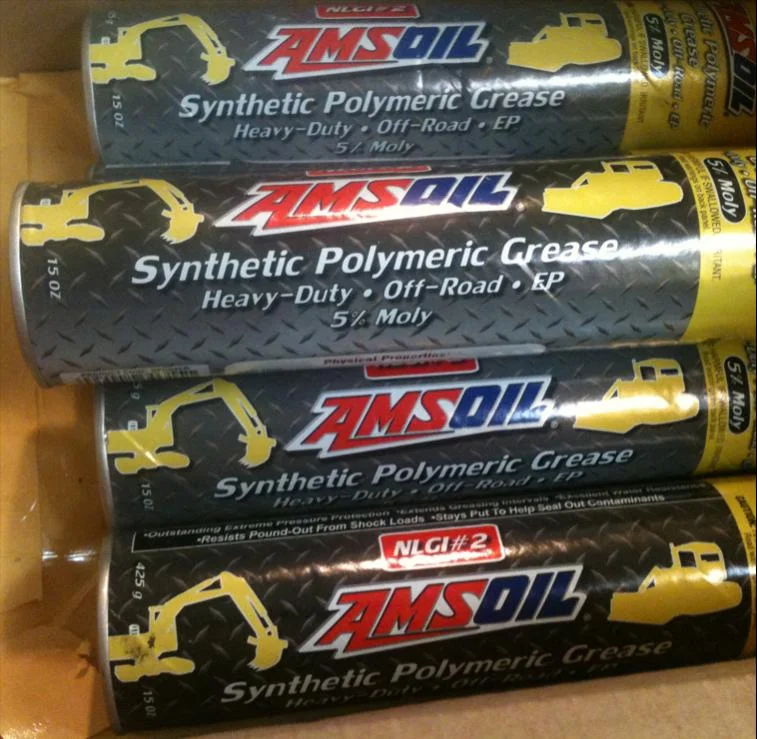

WhooHoo :D My grease came in today!

Well, I'm a bit bummed because today I talked with the Amsoil tech department. They no longer offer the GHD-CR (by the way the "CR" just means cartridge) or any other sizing of GHD anymore. They also don't have moly in the grease they now recommend which is the NLGI#2 "GLC" grease. And, they don't recommend the polymeric stuff for anything other than extremely heavy equipment (in fact the tech told me that it wouldn't work well to use the polymeric stuff and it isn't rated for wheel bearings). SOOO, I've got some research to do to find something that will work well. :meh:
No moly in Amsoil's NLGI #2 GC-rated greases anymore? Bummer. I'll bet they did this to save manufacturing costs and thereby still keep their profit margins up for their multilevel-distributor business plan. Multilevels don't do well in depressed economies. And I'm definitely not ready to go with calcium-based greases yet - too many downsides. I agree Turbocruiser: time to start researching greases again.

Yeah, I am not sure I like the calcium base in this Amsoil GPOR2 I just got, I do like the texture/consistency of it though. Ideally I think it would be best to find a synthetic, lithium based, 5% moly grease that is rated for wheel bearings. I may just have to settle for a non-synthetic in the end.
The aluminum based greases seem to be pretty good (according to the BobIsTheOilGuy.com website). If all else fails, maybe I will try that instead. :hhmm:
