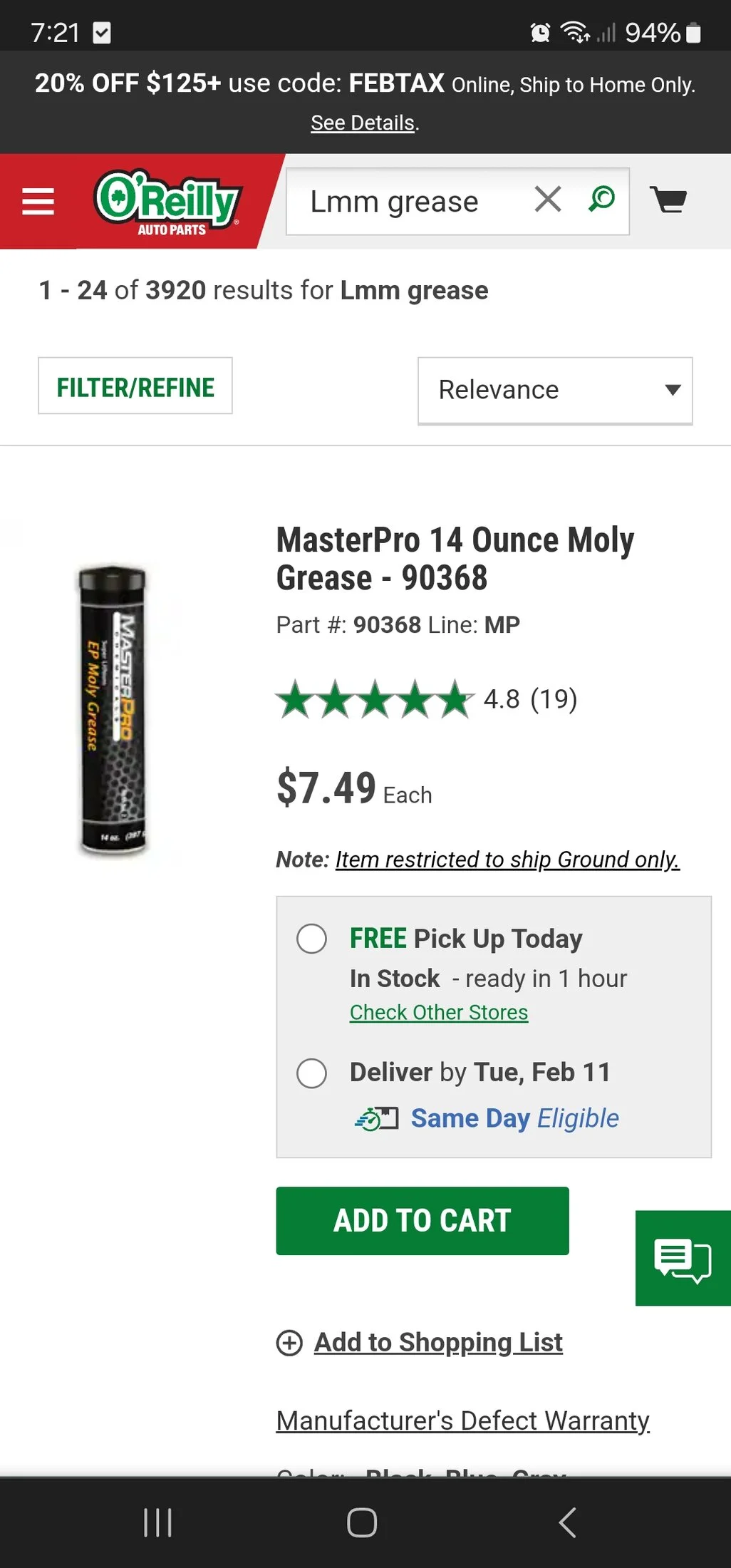

Search for "LMM Grease" at Oriellys shows two products at the top of the list
