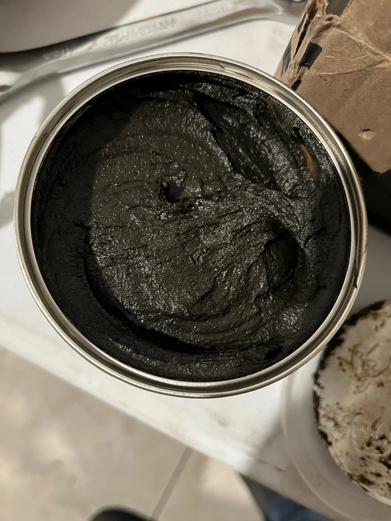

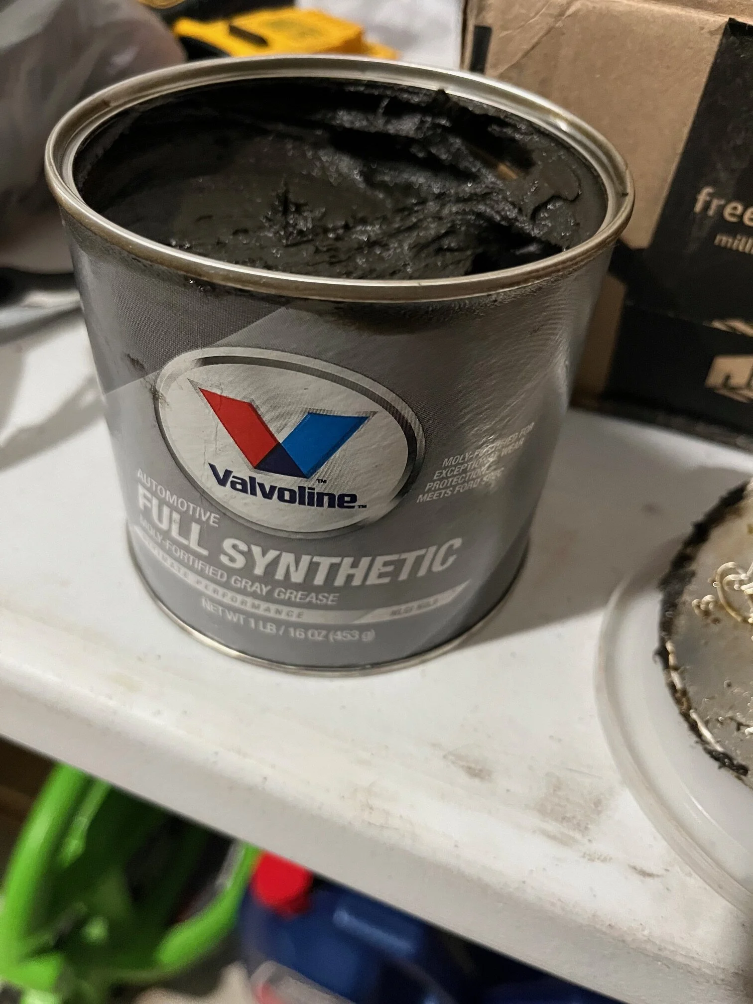

This is my first time doing birfs and I bought 4lbs of the same grease you linked. I have never seen a grease this texture before, it seems very thick and almost like it is rubbery? Is this normal and ok to use? When watching youtube videos it is hard to tell if it is the same texture as I received. I was also wondering if there is a reason you used the Lucas Red Tacky for your wheel bearings instead of the Valvoline as well? (it says it can be used for wheel bearings on the tub.) Any guidance is greatly appreciated!

Yours has the same texture? Don't know why but it makes me nervous lol. You back your birfs and the housing with this? Already have everything torn down. Just waiting to figure out the grease and then put it back together.

That grease will work fine. It does have a thicker and different texture than non moly. If you are worried you have old grease or a bad batch or something just buy one more tub or canister and make sure it is the same. I use a non moly red and tacky on the wheel bearings. I understand that your moly grease says OK for wheel bearings but I would rather have a dedicated wheel bearing grease.

Yes it does have the same consistency. I have used it several times. Always looks like that. It is fine.
@NoMoreXJ : If the texture bothers you Valvoline makes another Moly fortified grease called VALVOLINE PALLADIUM sold at NAPA stores in the US. It's considered a premium grease by Valvoline, has a smoother texture (FWIW) and very good specs including 3% Moly (more Moly than in the Synthetic).

This is absolutely exactly what this grease should be like, rubbery. The Amsoil synthetic Moly grease is the same as rubbery texture as well.
