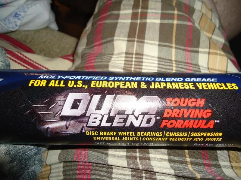

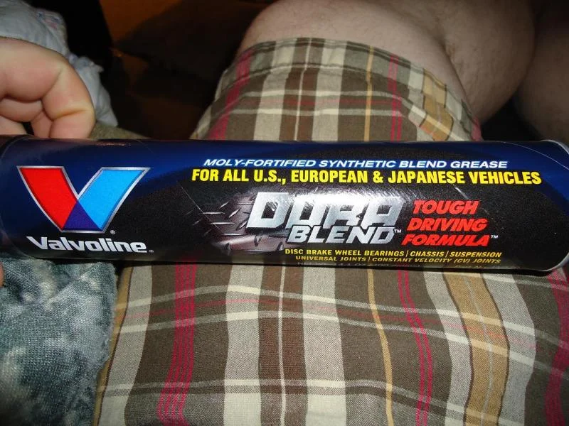

I got this stuff, looks like it meets the requirements. Will these work?
Valvoline Palladium (what many Mudders use) has EP additives plus 3% Molybdenum and appears to provide more protection then the Durablend. As mentioned previously it's available from NAPA stores; if they don't have any in stock they can order it.
Yep, have used it a bunch, works just fine.

DuraBlend is also an EP heavy-duty automotive grease.

Looks pretty good. I checked their website, but they don't specify what the thickener is, is it Lithium?
Cheers!
Yes it's lithium. In an effort to follow the FSM I found it at a good price, so I went with it. When I rebuild the knuckles I surely will search for the best grease I can find.
