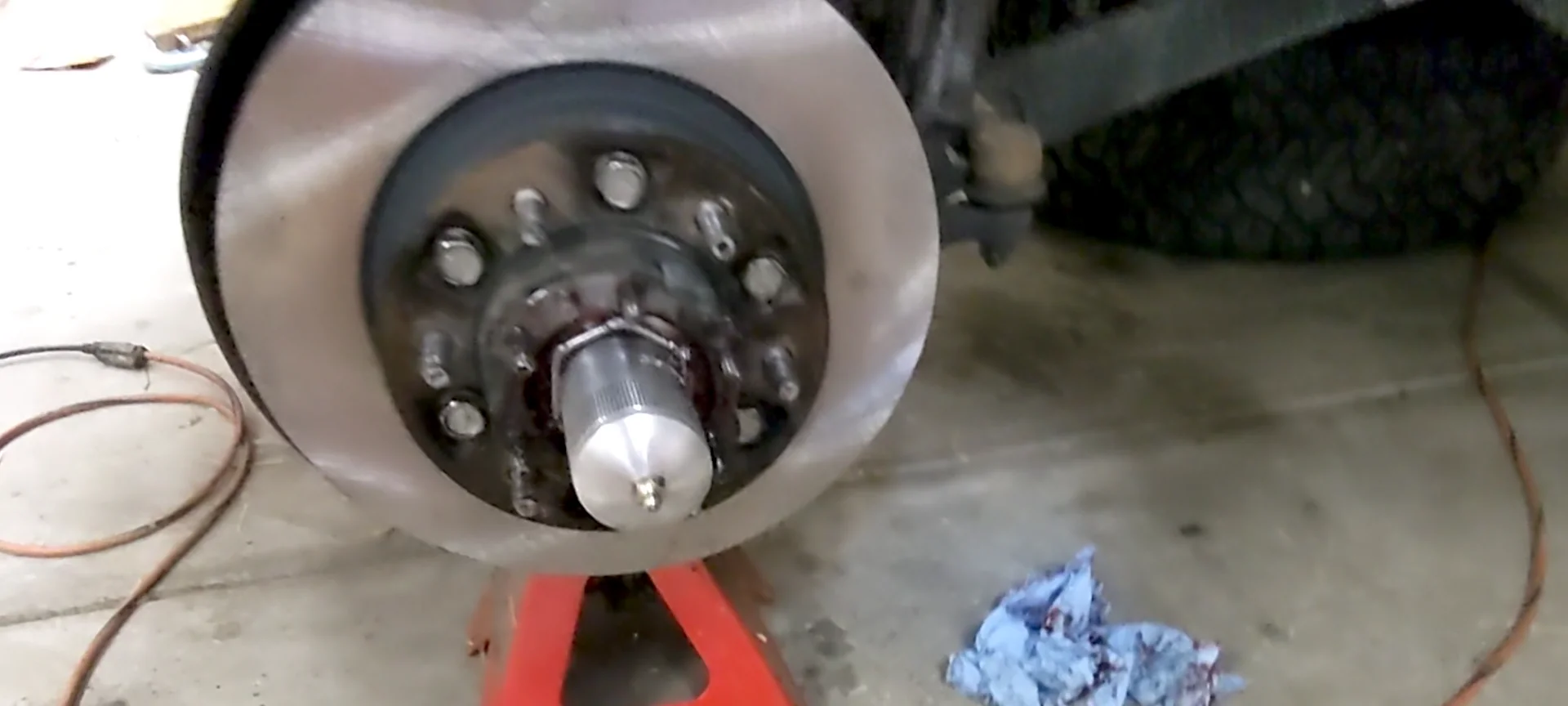

Used the new terrain tamer spindle / birf greaser on the recent 30k bearing repack break job.
Worked as advertised, though it was a cool piece of kit as it lubes the spindle, spindle needle bearings and refills the knuckle for the birf.
