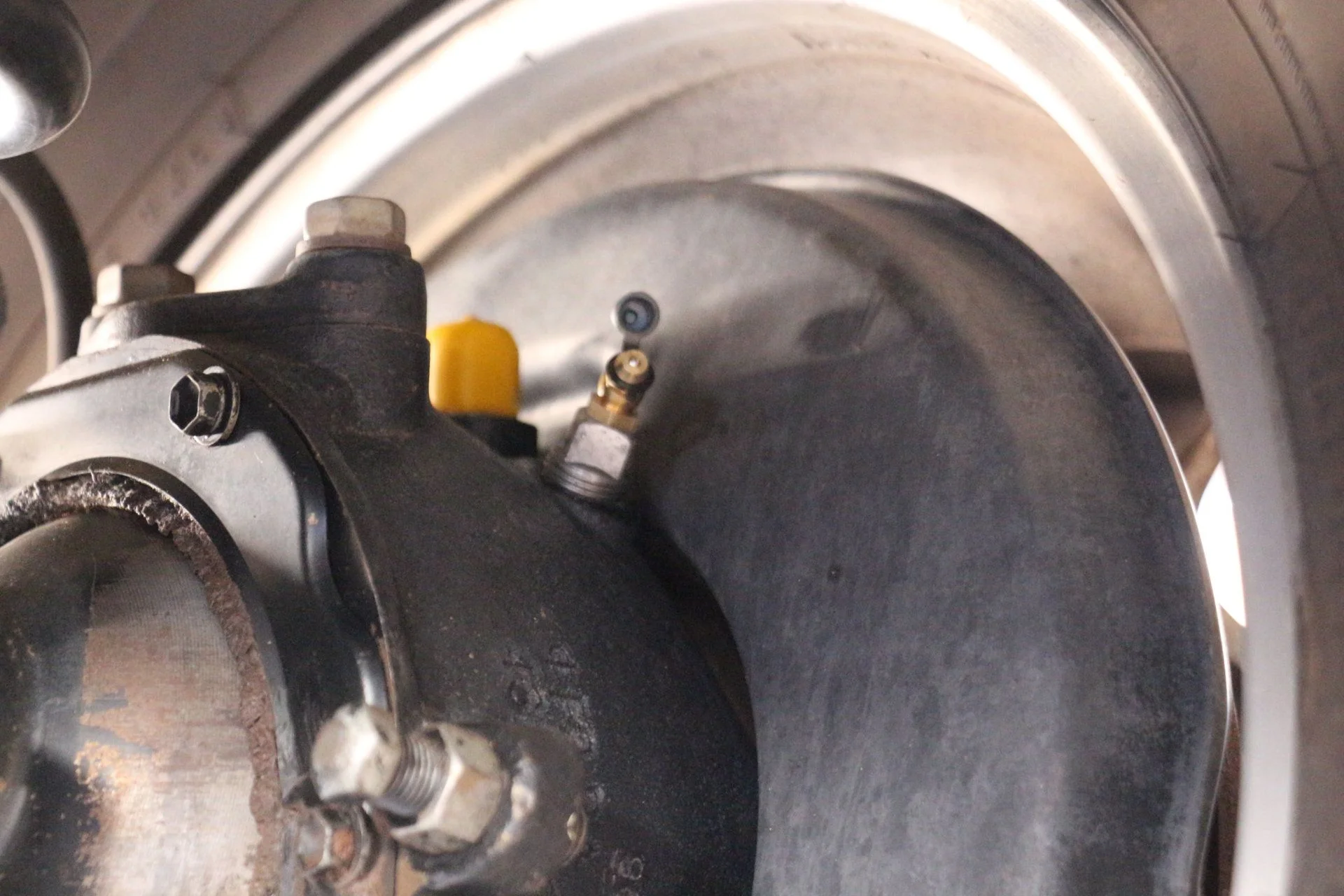

Phil, just in case you didn't know this already, the factory 3/8 plug uses a BSPT Whitworth thread, they are NOT a NTP pipe thread, those two types of threads are not interchangeable. Whitworth uses a 55 degree thread shape with a different thread count per inch (19 threads per inch) than the 3/8 inch NTP pipe does (18 threads per inch), NTP pipe also uses a 60 degree thread shape.
Than
Phil, just in case you didn't know this already, the factory 3/8 plug uses a BSPT Whitworth thread, they are NOT a NTP pipe thread, those two types of threads are not interchangeable. Whitworth uses a 55 degree thread shape with a different thread count per inch (19 threads per inch) then the 3/8 inch NTP pipe does (18 threads per inch), NTP pipe also uses a 60 degree thread shape.
Thanks We are using factory Toyota plugs and drilling and tapping
