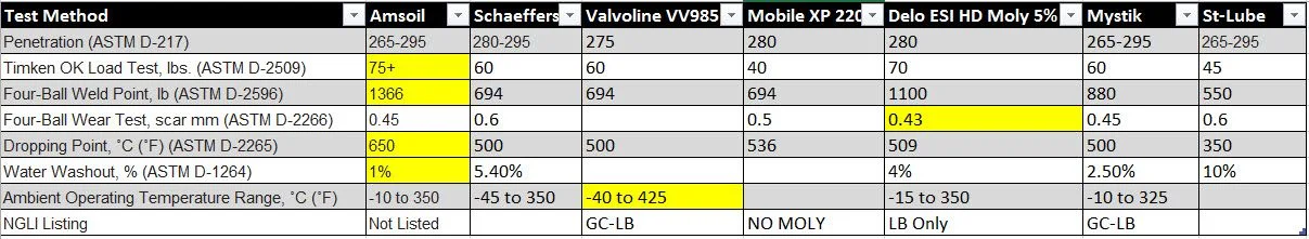

This is a great thread, thought I'd chime in after digging into this. I'm geeking out so hard only because I run 37s hard and after ~30k my trunnions have obvious false brinell and sticky movement which may or may not be contributing to my persistent and sometimes death-like wobble.
For the grease, % moly isn't as important as other performance characteristics--it's mainly important that it have it, period. Lithium vs. calcium base seems to be irrelevant to our application--and it's worth noting that this specification was written 30 years ago so following it exactly isn't necessarily state of the art anymore.
In terms of performance what we're mainly interested in for specs are the Timken OK load test and the Four-Ball Weld Test. Basically they load the grease in a test apparatus until the grease fails for Timken or balls weld together. Do a video search for the ASTM test numbers below if you want to geek out.
Amsoil blows everyone out of the water with Delo ESI HD coming a close second, winners in categories are highlighted in yellow:
If you are worried about low temps you can always drop to NLGI #1 instead of #2, e.g., Amsoil's NLGI #1 operates to -30. The NLGI number is literally derived from the penetration test results which are directly related to viscosity.....lower viscosity = more penetration = lower NLGI #.
All the info regarding temp ranges from the manufacturers usually relates to pumpability, specifically in automatic lubricating machines with long runs on big equipment. Or in very static exposed applications (e.g., semi 5th-wheel mount). This is an irrelevant concern for our use, a BIRF and/or knuckle will be at ambient temperature for not very long once the vehicle starts moving.
Mystik and Valvoline are the only moly-based greases that are GC-LB listed on the NLGI website. So if you're dead-set in running one grease in both knuckles and wheel bearings these are good choices. They aren't the absolute best in specs for trunnions/BIRF though.
