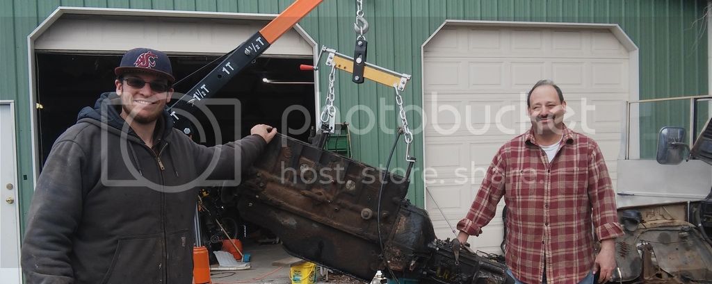

The mighty hunters gloat over the kill.
What a nightmare getting that out was. We had to bolt the transmission back up, drag it out and then use 3ft pry bars to get it off once we had it out, the input shaft had gotten in a serious bind.
Now, I have a problem. To take the bell housing off I need to remove the clutch and flywheel. But the engine is stuck, so I can't unbolt any of it.

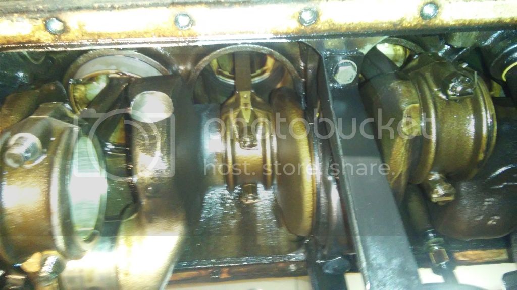

Got the engine pulled down.
It's a beauty.
No sludge.
Got the piston loose. Just going to hone it and put new rings in there. Might put up a wanted add for 1 set of STD rings, just for the bum cylinder. I check the others and they are all in spec, only worn a tiny bit.
With this rod unhooked I can spin the engine over. Feels perfect, bearings are exactly what you want to see, no cracks, no pits ore scoring. No thin spots or any damage of any kind.
