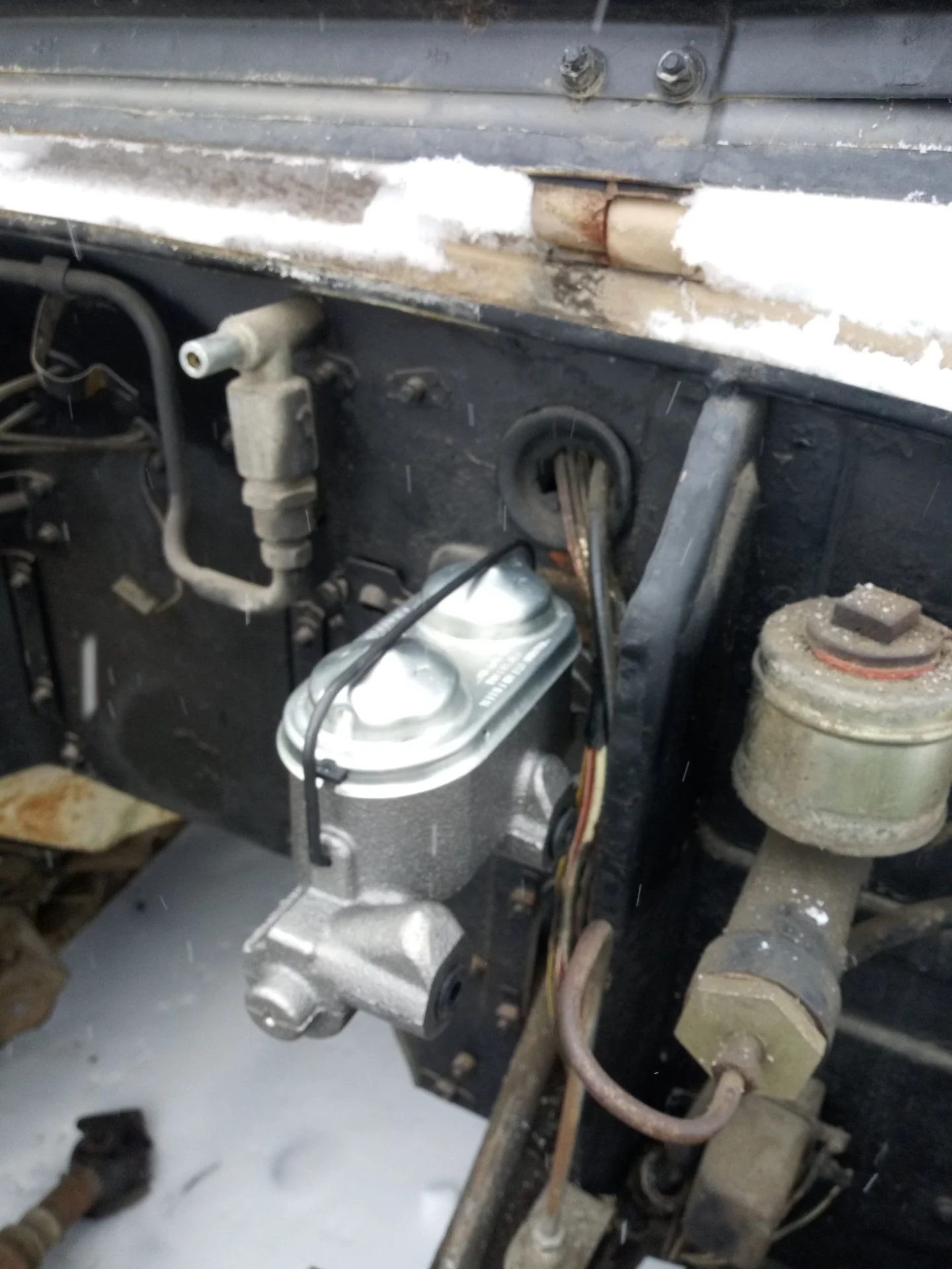

Picked up the master cylinder. Got one for a 1967 chevy nova with drums. 1" bore, fits the firewall, the toyota rod seems to fit fine. Going to make a adapter tonight. Not going to get much done for a few days otherwise, supposed to get 1.5ft of snow in the next few days.
A 1967 Chevy drum brake master cylinder fits up almost like it was made for this rig with a spacer plate made out of 1/4" aluminum and some 3/8" bolts.
The only complication is the rib on the inside of the firewall. A bit of time with a file and the bolts line up well enough. The Toyota push rod has plenty of adjustment to take up the slack and the boot fits the Chevy M/c perfectly.
