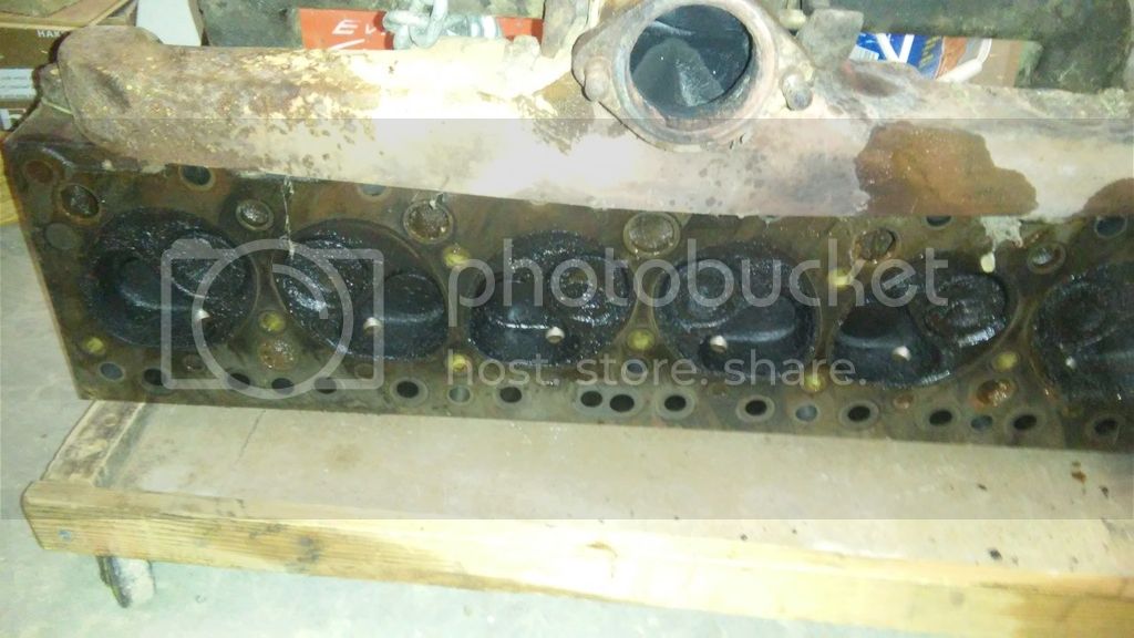

Really sucks, the other bores are in incredibly good shape for the mileage, small ridge at the top. I'm curious if I can save that last cylinder.
I've been having a good time tearing this down, so simple to work on. Those are some weird shaped combustion chambers. Practically a OHV head on a Flathead engine.

A few questions, what are the rubber caps on the valve springs for? Also, is the copper tube that feeds the rocker's special or could I just make a new one, as this one got all dinged up.

Does anyone know what the plastic caps on the valve springs are for? I've looked at specter, I can't find any listing of them.
Are they aftermarket? 2 are crumbling and split so I'm not sure I should leave the other in there.
Once you get it cleaned up you can see how deep the pitting is.
Looks like years of condensation ended up in the most downhill #6 cylinder.
I had one that was similar, one cylinder pitted and was able to hone it off.
The way I look at it, whether the motor is useable or not it needs to come out.
If you hone that last cylinder and get it turning, you can be sure that the rings are all packed in place with the same rusty gritty crud.
I'd want to know what the bottom end looked like before dumping $$ into it.
Engine out & pan off, it is really not that difficult to take out the pistons & connecting rods.
With any luck you will be able to stop there and put it back together with a new set of rings and a valve job.
