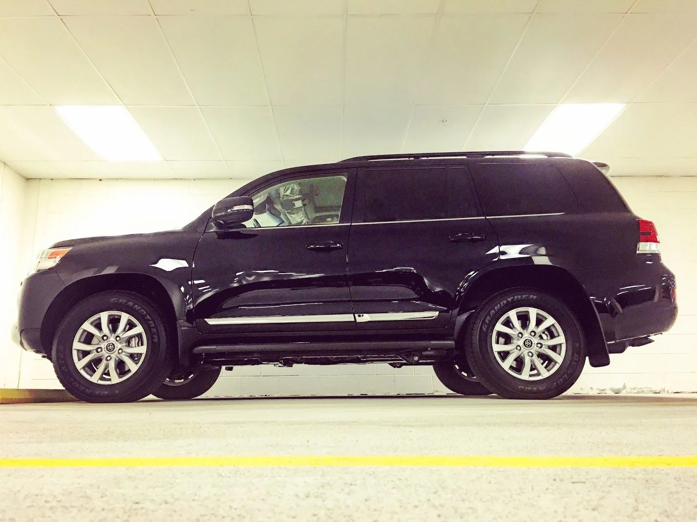

I just joined this forum. Here's my new 2017 with complete Suntek Ultra clear wrap and coated with Cquartz.
The results are fantastic.
Highly recommend it.
