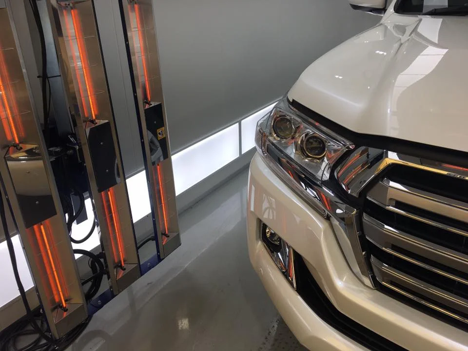

Had the LC detailed and coated in Ceramic Pro 9H. Should make it much easier to clean up after fun off road. Offers some scratch protection too.
Please educate me more about the ceremic coat, this is the first time I hear about this product. I checked online and all the video is pretty impressive. How much did it cost and where to get it done?
Coating was done here in Japan by a local well-known and reputable car detailing specialist. I've been using them for over 12 years and have been very satisfied with their work. The total cost was in Japanese Yen and included other detailing work too, but it turned out to be approximately $1,500 US. They "warrant" the coating for 5 years. Expensive, I know. This is the first time I've opted for the Pro 9H, but I've been very impressed with their "lesser coatings" over the years. Not having to wax any of my cars for over a decade now has been a real bonus! The cars are so much easier to clean, washing is much quicker and the dirt just doesn't seem to stick to the paint. Paint was much less likely to get swirl marks in it too.
Ceramic Pro 9H can be layered (I have three layers) for extra protection. It's pretty resilient, but it can be scratched if not looked after. I have a similar coating on my FJ and it has held up quite well on the narrow trails here.
Hope that helps!

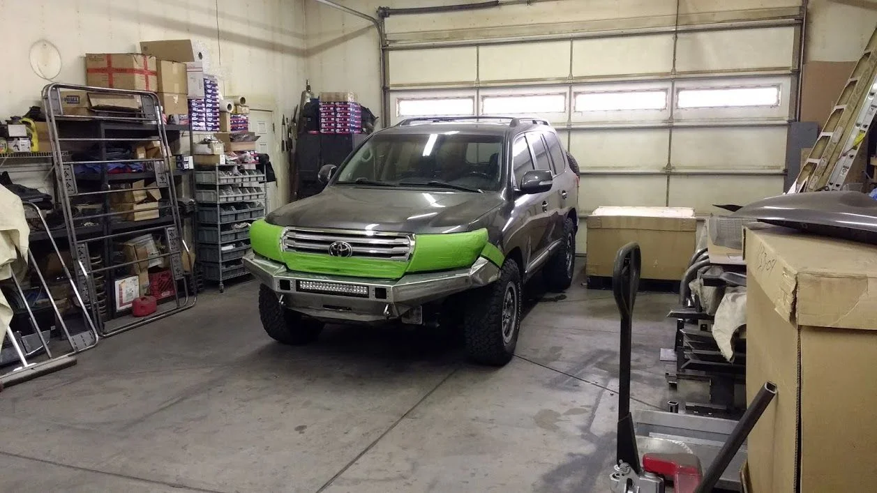

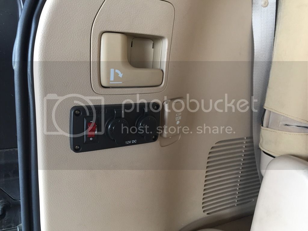

Thanks to @Lo2aY and his team, the following got done.
Blue Sea USB port and fuse block
Thanks @cruiseroutfit

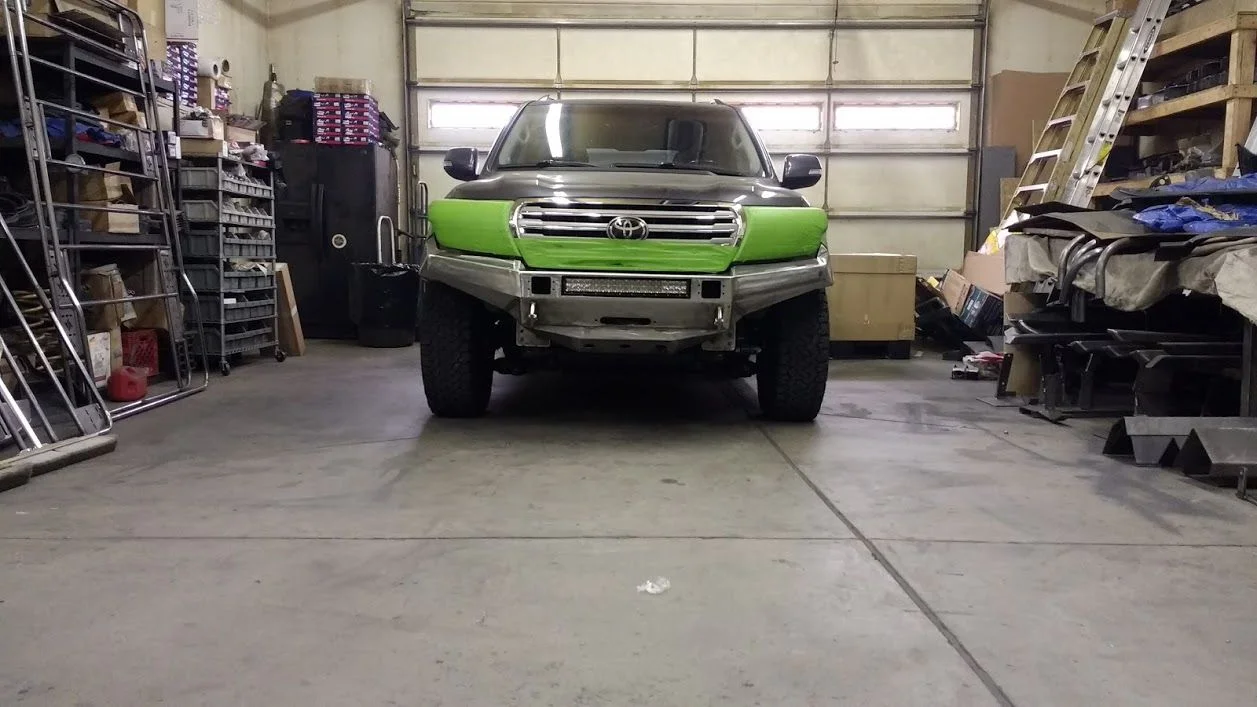

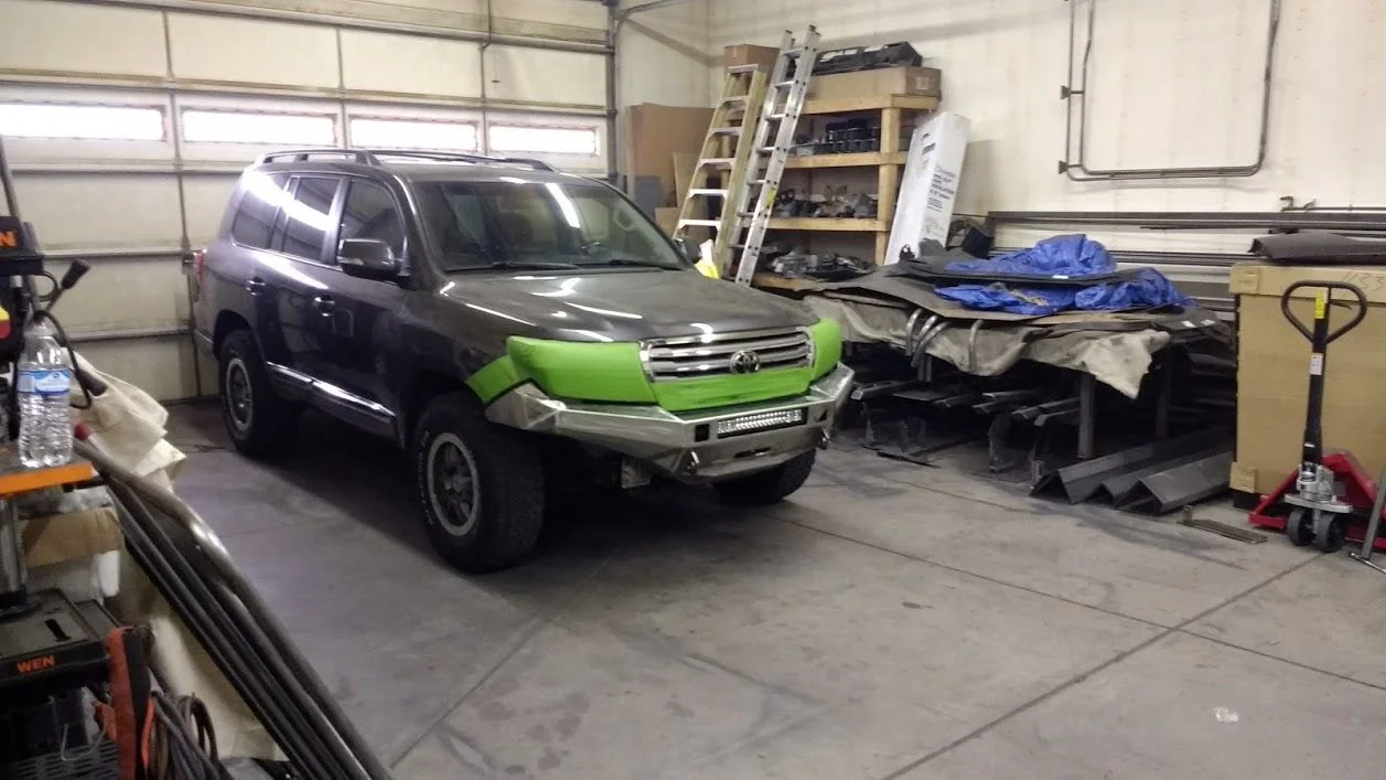

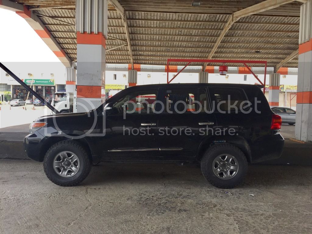

And some Kings 2.5". Front sits a touch lower than I like, and its set to the maximum height.
What spacers would work to level her?
Great looking truck, the Toyota factory 10mm spacer will probably level out the suspension. You could also use a modified tundra 20-25 mm spacer and back off the preload of the springs if you want to get a softer ride in the front.
Mscruiser added spacers to keep the lift tall and preload down. check out his build thread "fat amy"
Thank you sir! Will hit him up!

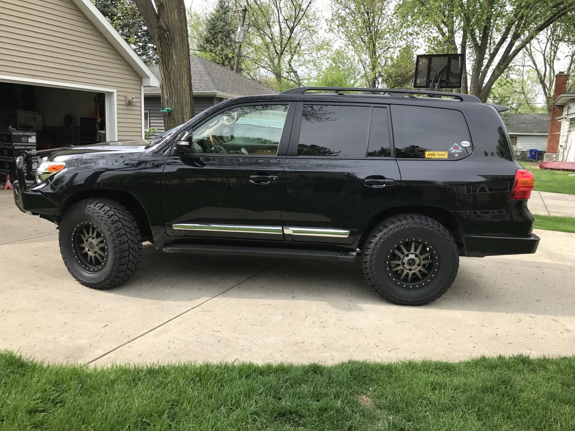

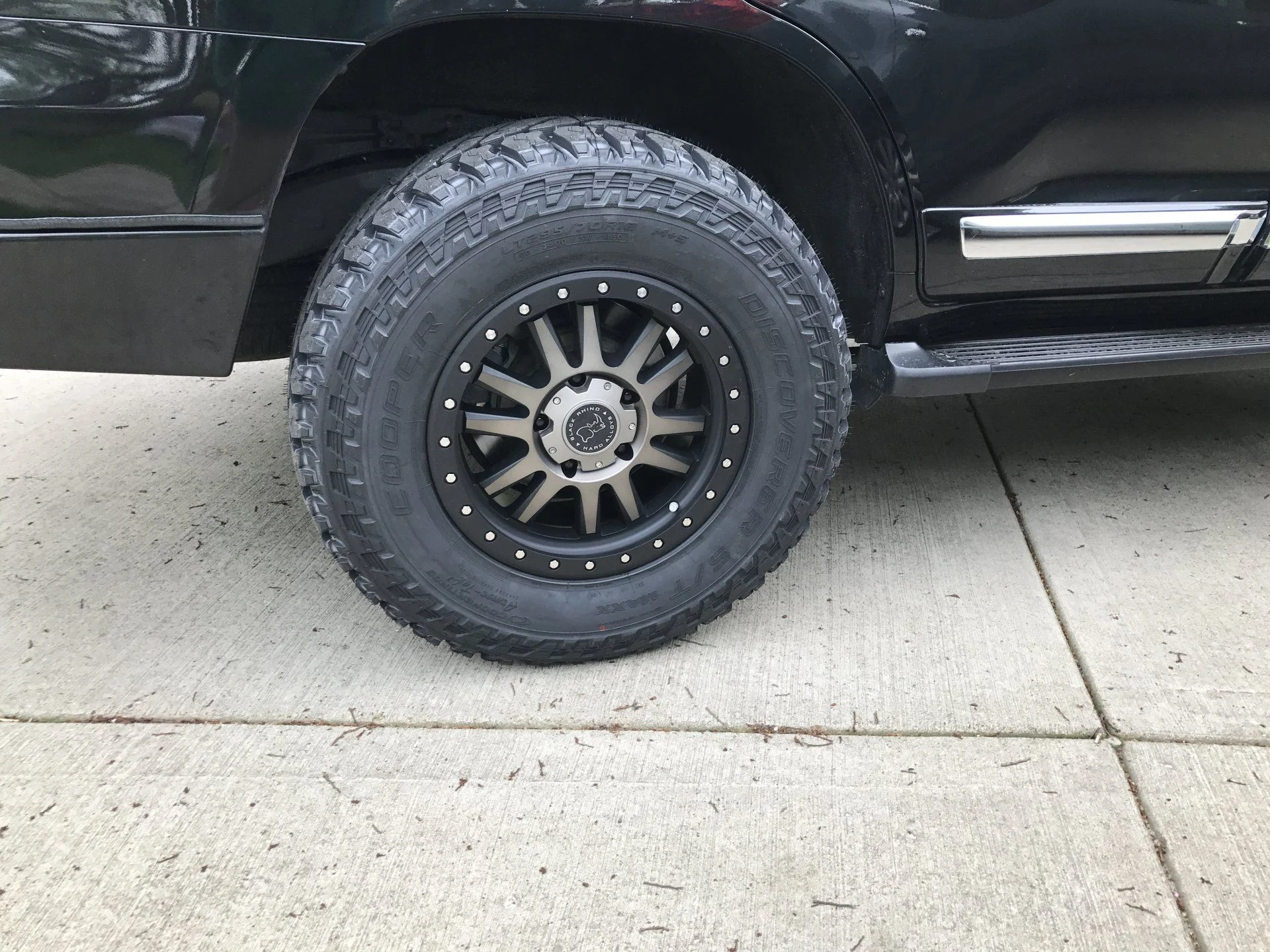

New shoes. Black Rhino Tanay wheels wrapped in Cooper S/T Max rubber. 285/70/18. There's a bit of rub on the KDSS sway bar attachment at full lock when backing up. ChiTown4X4 really hooked me up with the look I was after. If you're looking for Toyota parts be sure to check them out.
Damn those are sweet wheels. The gunmetal gray on black REALLY works!
Any idea the load rating on those?
