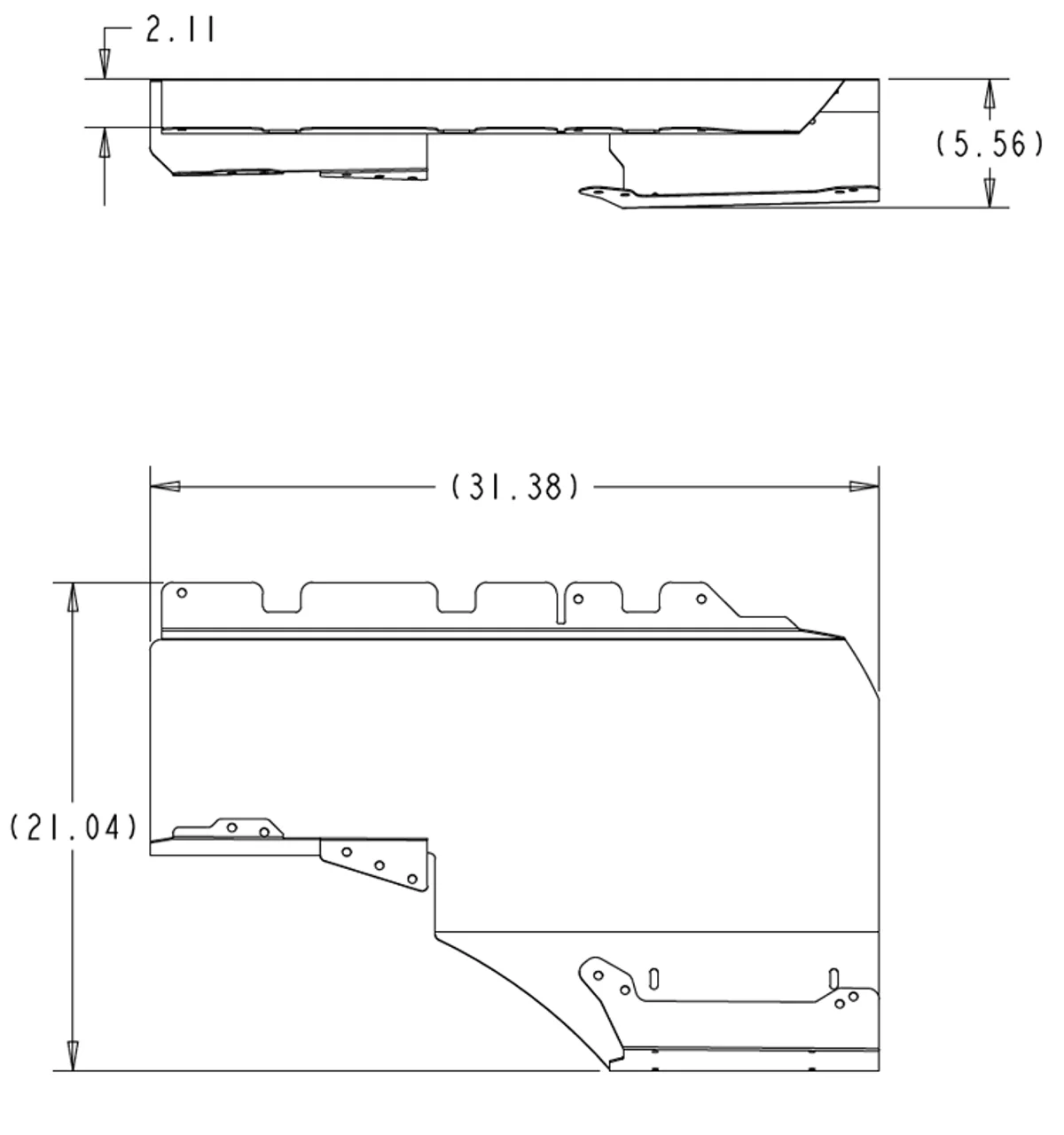

The QPM by Wits End is a great solution for mounting accessories in the rear quarter panel area. However, nobody has developed an alternative product that is actually available.
I’m starting this thread to keep people informed as I build a part in CAD that you will be able to send to a local fabrication shop for cutting and bending.

@KrOswalt received CAD file of the model I built.
@TRAIL TAILOR is manufacturing a batch (planned to be available end of May). You can DM him for more details.

In my mind, this part will be open-source and people can modify to fit their needs (much akin to the 3D printing community).

I don't quite follow you here. CJK states he's going to share a working drawing for the qpm that anyone can send out for fabrication.
That's a little different from what you are suggesting.
Sure, you can take that and modify it into whatever you like, but, IMO, if you can do that then you don't need any of this at all. You can just as easily design whatever you want from scratch.
correct sharing a working 3D drawing people can send out to get fabricated or...or....oooooorrrrrr hang with me here... people could even modify it to suit their needs and then send it out to get fabricated! I'm not telling CJK to go spend money to get a 3D scan but there are some mudders with scanners and it would be cool to have a scan to access to test interference while you tweak...not quite sure what the hang up is for you!
