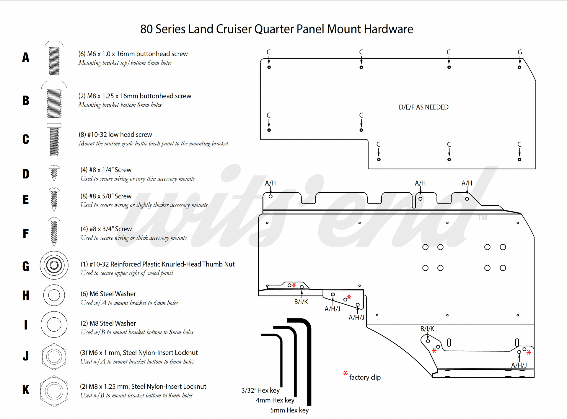

Good afternoon. While trying to get things setup for my Wits End QPM I tried locating the hardware kit that came with it but misplaced it.
Basically need to thread pitch for all hardware that came with the kit.
Thank you.
I was able to get the actual PDF from Joey at Wits End listing all the bolts and tools needed.
Would you mind posting that here? I would like to add it to my Land Cruiser files.
For people that were like me and miss placed the hardware I was able to replace it at a site called belmetric.com
