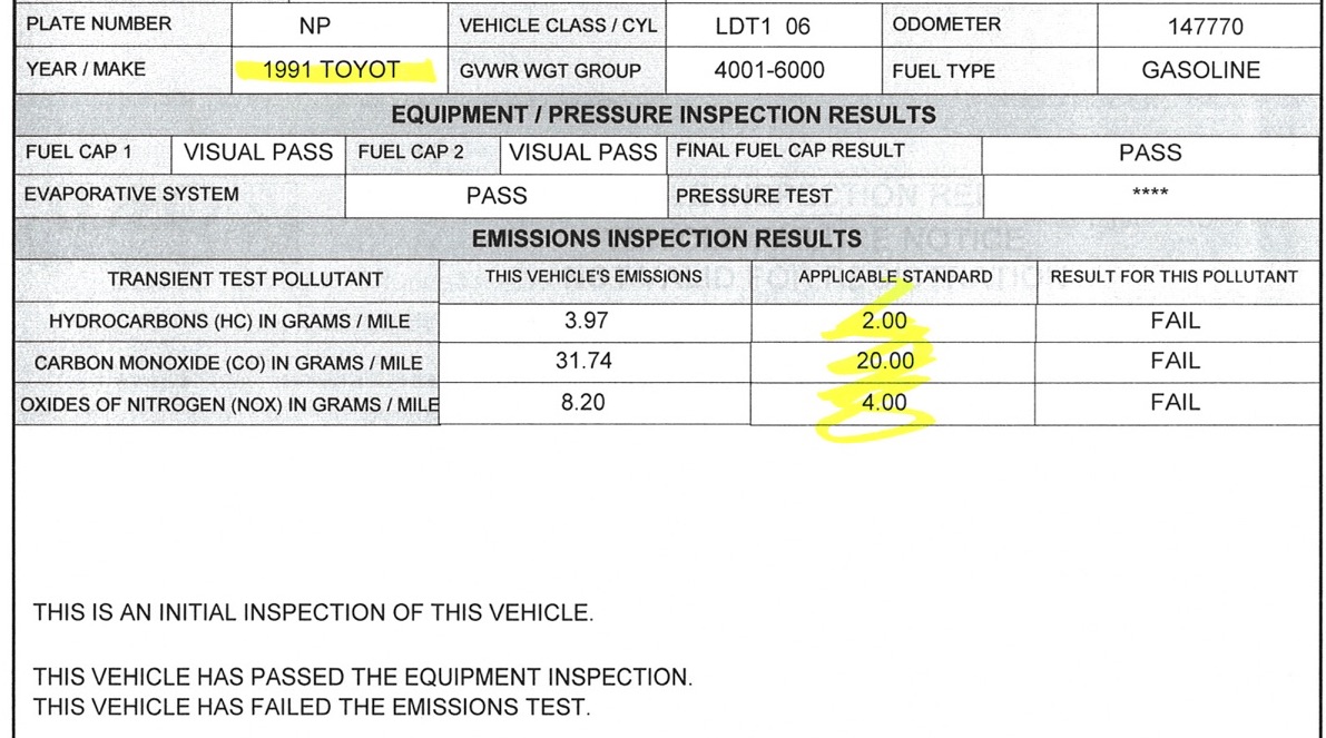

So I've imported an FJ75 from the Middle East and went for an emissions test today in the Phoenix area. I pretty much expected a fail. I don't have a catalytic converter (Gulf Spec in 1991 on these rigs didn't include that). I'm posting here because this forum has the most experience (other related threads) to my engine and emissions testing.
Here's my results:
Some of the known quantities when taking this test:
1. New plugs and cables, new condenser, new distributor points, new distributor cap. New air filter (only like 2000 kms on this filter).
2. Old gas. I didn't think of this until after the fact... but the fuel has been in the tank for 3 months since shipping from the UAE.
3. Engine was nice and warm when I arrived at the testing facility. Only waited about 30 minutes. Didn't let the truck idle much.
4. Both tanks hold pressure... it's a dual fuel tank rig.
5. I've got two charcoal canisters, one for each tank. I've got three VSV valves under the hood. One I know doesn't work and has been bypassed.
I'm looking for some guidance/advice. My current thoughts are to do two things:
1. Install a weld-in universal catalytic converter.
2. Adjust valves, adjust timing, and lean out the carb.
Other thoughts?
The cat will help with all of those...burns off excess NO, CO, and HC in the exhaust. If that doesn't get you passig numbers, along with tuning everything, maybe look into running a high percentage of ethanol (add a bottle of HEET to a mostly-empty tank?) for the test.
EDIT: those high nitrogen numbers are usually solved with EGR in a fully-smogged setup, to lower the combustion temperature. Leaning out your carb probably won't help get those lower, but I think the ethanol helps lower combustion temps, and the cat is supposed to burn off nitrogen compounds (the source of the original yellowish smog that they were invented to deal with) along with the incompletely burnt fuel and CO.
Yes, the CAT will help tremendously. Also, your local gas is probably 10% EtOH which will burn cleaner. You really need to do those things before any further baselining.
Valve adj and lean-drop carb adj will help too. Check timing, slightly retard it. Make sure Air filter is clean and oil is new.

A cat will help for a little while but if the exhaust isn't varying rich/lean then the cat will have issues of its own. Probably need the smog pump and EGR systems installed and corresponding carb. Given the cost of sourcing all those pieces this might be a great time to invest in something like a Holley Sniper TBI and install a new cat or two.
You should be able to lean it out enough to pass with just carb adjusting. Many years ago I went to a 3 day GM class on emissions we brought in my 390 powered Mercury and hooked it up to an emissions machine. We got it to pass for mid 90's with just carb tuning and no emissions devices on the engine. I would lean the tune, verify timing and freshen the gas up. Also make him test you as a truck. Trucks have higher standards than cars. You may also get help by claiming a higher GVW. In Georgia you become exempt from testing at 8500 pounds
I could be wrong be I don't think carbureted non USA 3Fs had an EGR system from the factory. Ditto for air injection. Without those systems it'll fail. Granted you could retard the hell out of the timing to reduce the combustion temps (if the tech turns a blind eye) but without extra oxygen somehow getting into the exhaust (via air injection) CO will usually be out of range (fail).

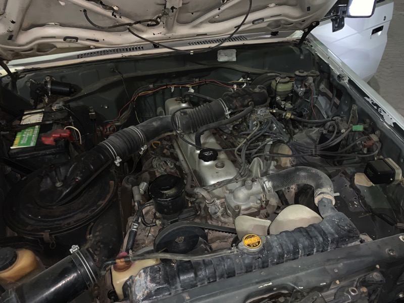

Can you post some pix of the engine, please ? Very interested in what she looks like :D

I'll get some engine pics for you, sure...
