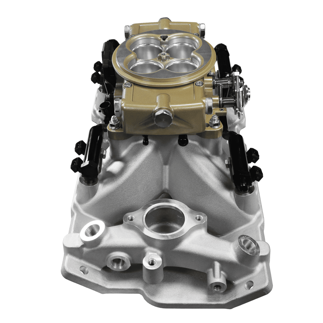

Any update on this, did you get it to pass? I don't need to meet emissions in NY with my 86 carb 3F but I am about to replace the exhaust and do want to make it as clean for the environment as possible. I am also about to rebuild the engine and swap carb for Holley Sniper, and add Pertronix and headers etc. What would you recommend?

Going to the Holley Sniper I think you'll be putting in two O2 sensors, right? I'd recommend you put in a catalytic converter at the same time.
