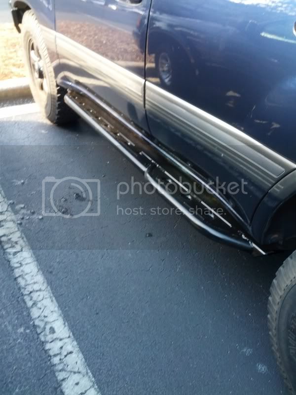

Got the crusin off road step style sliders. Cost with shipping to socal Came out to what a slee slider would cost without shipping. Ups didn't do a good job so I got some scrapes.
Tolerance is tight. I used some silicone spray to help slide the sliders up the frame while jacking it up(one man job). One of the supports on the driver side actually rubs the floor sheet metal. I resolved that by slightly bending it and adding a piece of rubber ( from a cut up inner tube). I'd buy again.
It was this or white knuckle and I decided step design for my kids.
All I can add is that if , I was doing sliders again ... I would go with a top plate. I car pool taking kids to school and no matter how many times I tell the neighbor's little booger slow down getting out of the truck , he doesn't listen well and his foot can fit right between the rails, backpack on falling forward. Yea .. not good. Older kids , no problems..

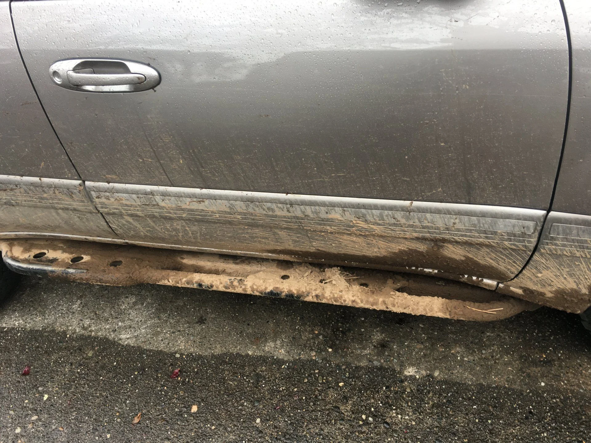

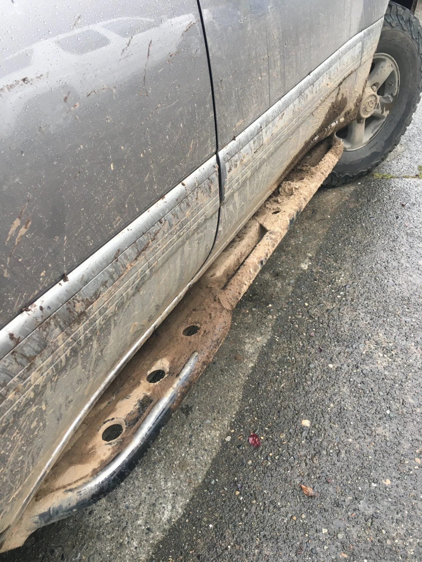

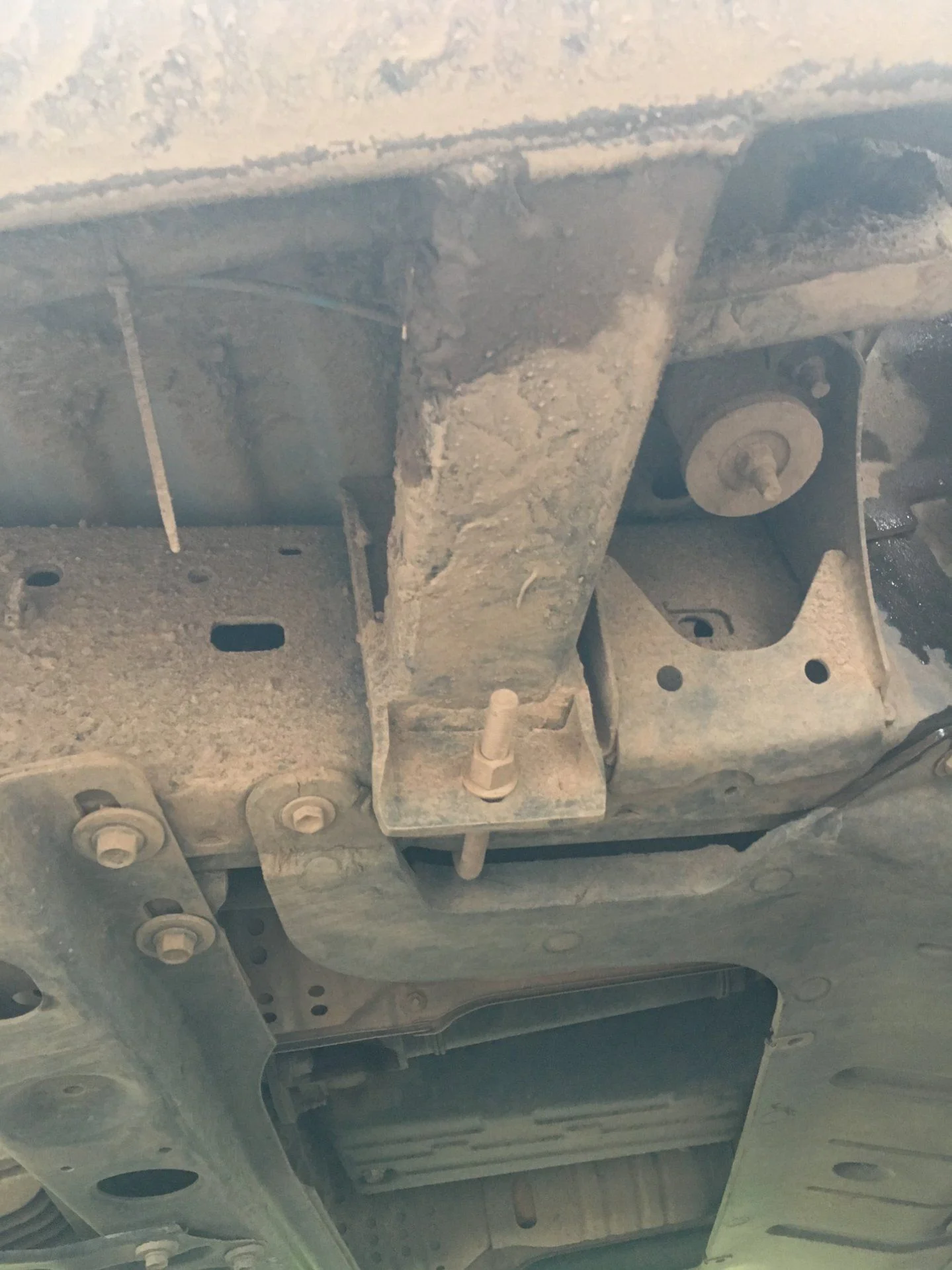

I have the OPOR sliders from Metaltech, which I got uncoated to paint myself. I have to say, I'm pretty confused about the differences between the OPOR branded and Metaltech branded sliders. They even use the same pictures on the website. It seems like OPOR is their slightly less nice house brand? For instance, the OPOR lower links don't have johnny joints, but the metaltech do. But I'm not sure of the differences with the sliders. When I bought earlier this year, the Metaltech weren't even available.
Anyway, onto the sliders. They look good, are heavily built, and well crafted. I like the kickout near the rear fender, and they are just enough to step on, without sticking out too much. My kids use them as steps, and I have no concerns of their feet slipping through. I've been wheeling a couple of times since they went on, and touched them down on the ground a couple of times, but on dirt, not hard rock. One worry is they are only connected with two arms, which I wasn't expecting, I'd hoped for 3 arms. I think they used to have 2 arm and 3 arm versions depending on whether you had AHC, but they just do the two arm version now. That said, the arms look beefier than pics I've seen of other brand sliders. I've used a high lift and jacked from the most remote (most leverage) part of the "step", and it lifts the truck fine without hitting the rocker panel, but if it dropped onto a rock from a couple of feet up, I'm not sure if it would deform enough to hit or not. In all, I'd buy again. they were a good deal, particularly since I was able to pick up and avoid $200 shipping.
Pics below. Excuse the mud, just went camping.

Interesting the pics from their website show three support arms vs the two you guys mention.
Can you run the OPOR with front mud flaps?
Yes, that's why I was disappointed and considered returning them. But they are so well made otherwise, and are the exact profile I wanted, and the arms do seem very beefy, that I decided to keep them. No regrets so far.
When I ordered them 3 years ago, they offered them as seperate models for AHC equipped vehicles (with 2 arms) and without (with 3) as well as several options for top plates and powdercoating. i think they just went with one model fitting all models so they could run large orders. I dropped the full weight of the truck on them and wouldn't think only having 2 arms would be detrimental to their purpose.
