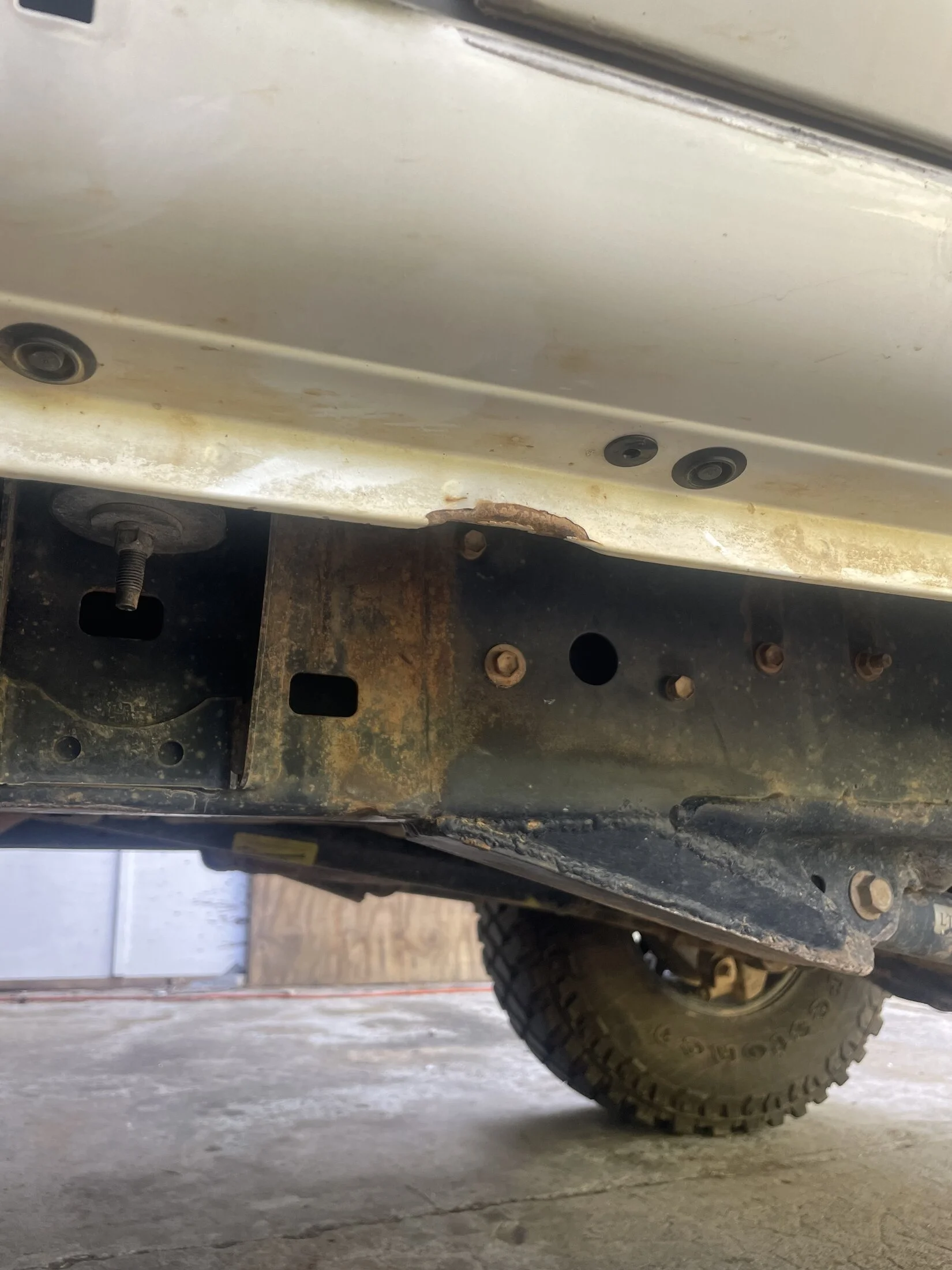

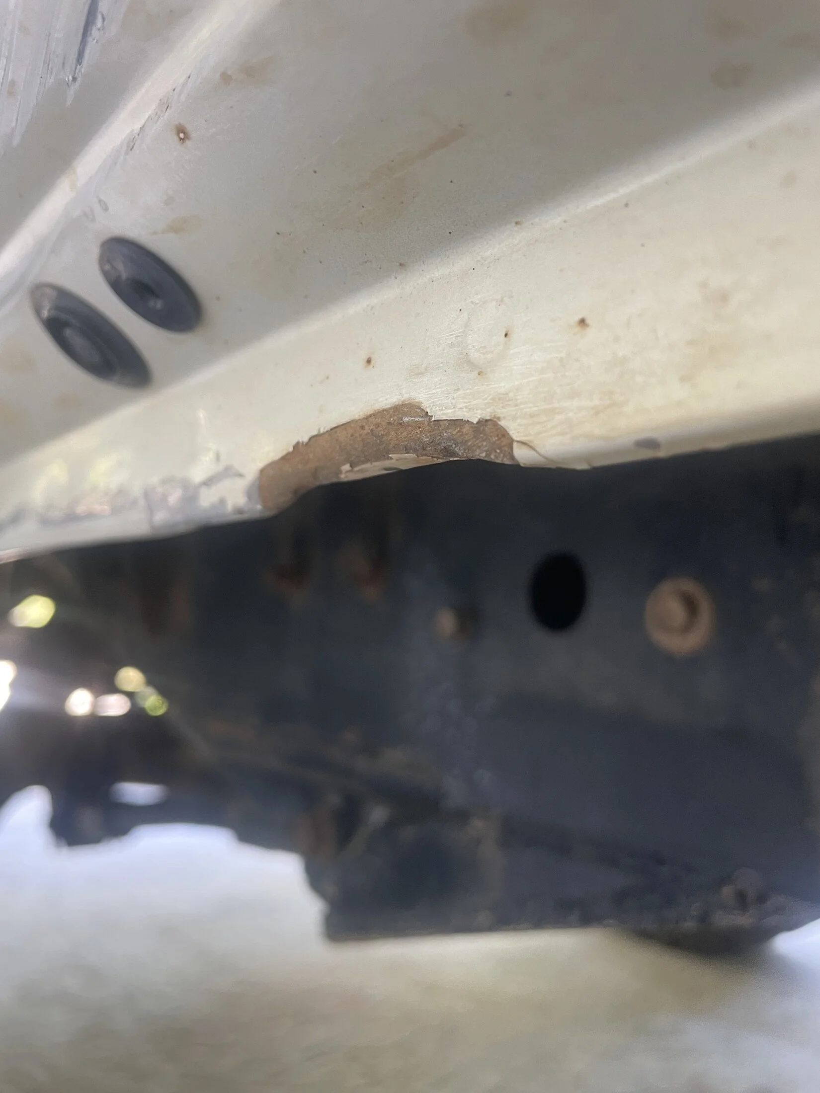

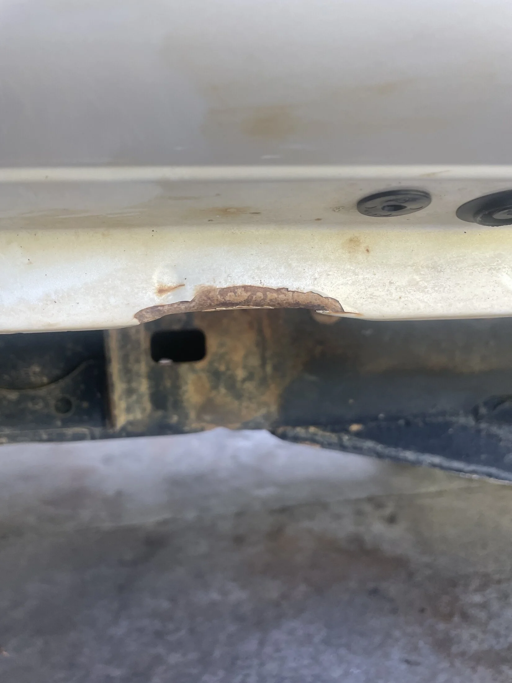

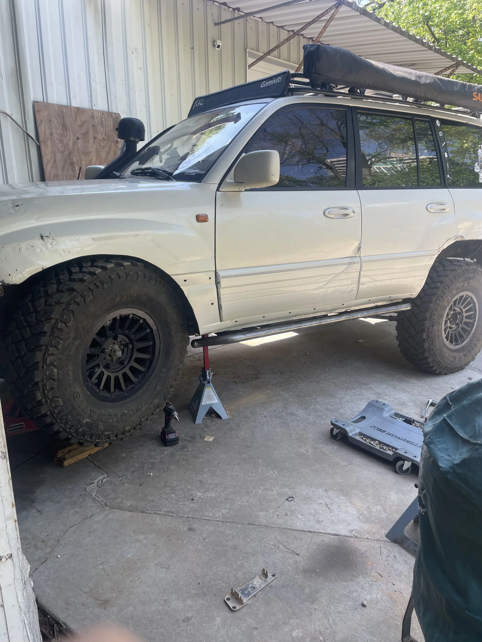

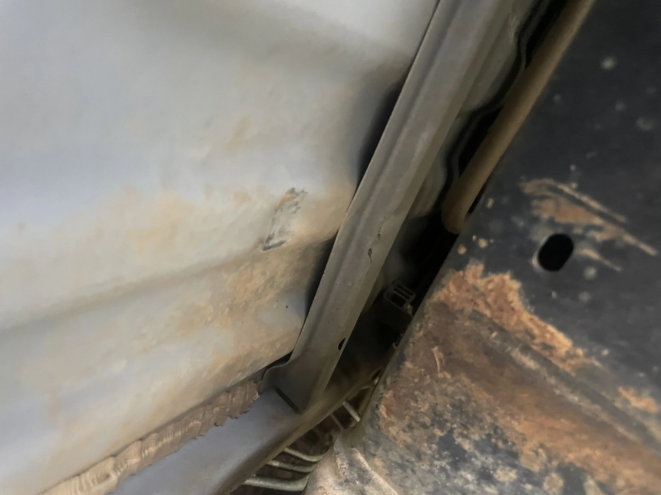

One of the first things I noticed with the white knuckles (after wheeling hard trails) was that the upper portion of the u-bolt mount actually contacted the body of my 100- it created a rather loud rumbling sound on some trails. As time passed the body of my truck bent up and out of the way, self-clearancing for the slider mounts.
Photo above (left): April 2025 showing the damage to the body from the white knuckle bracket (sliders removed)
Photo above (right): October 2022 the sliders stuck up far enough to contact the body in extreme conditions
As time progressed I learned to loosen the u-bolts and let the sliders drop down a bit- I would then tighten the u-bolts to reduce the banging sounds.

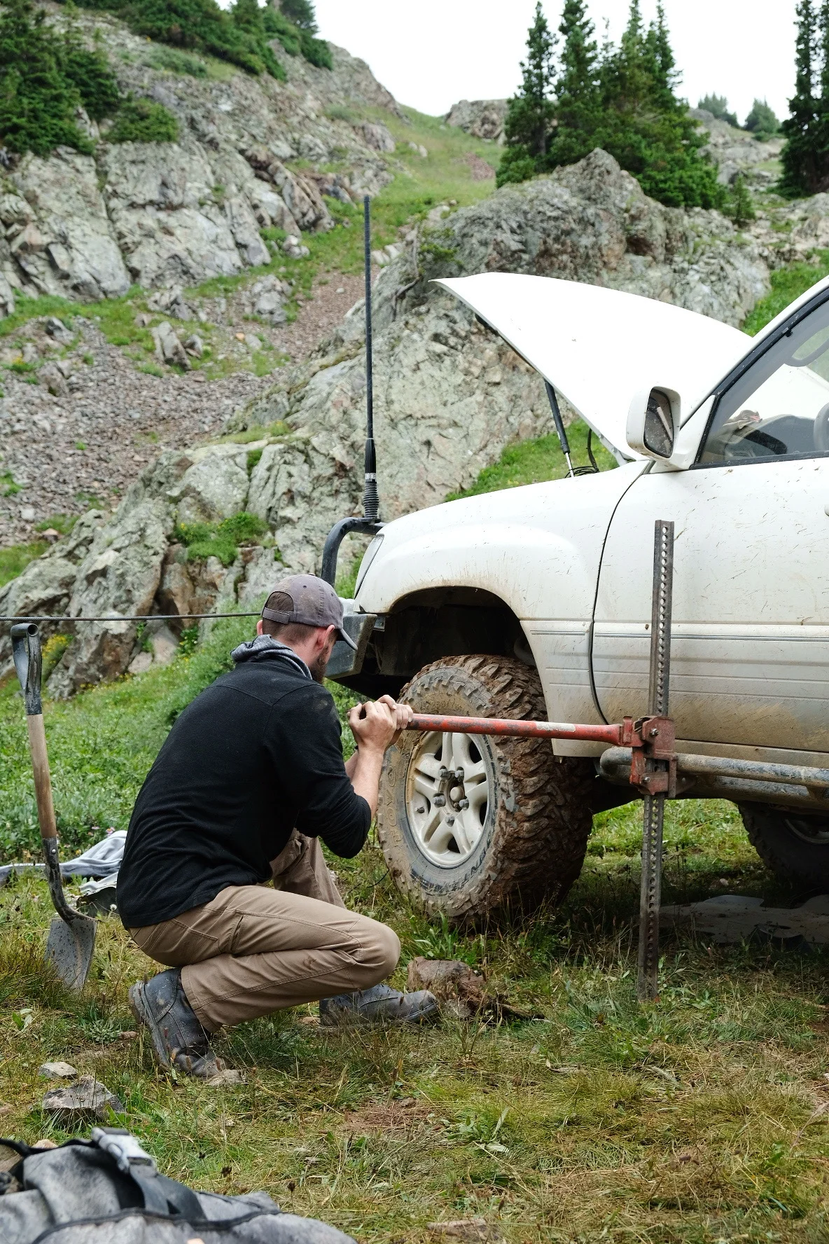

Early on in my adventures I used the sliders as a lifting point many times (I broke a lot of stuff).
Photo: July 2022 raising the vehicle so I could isolate the front diff post-failure at the Poughkeepsie wall

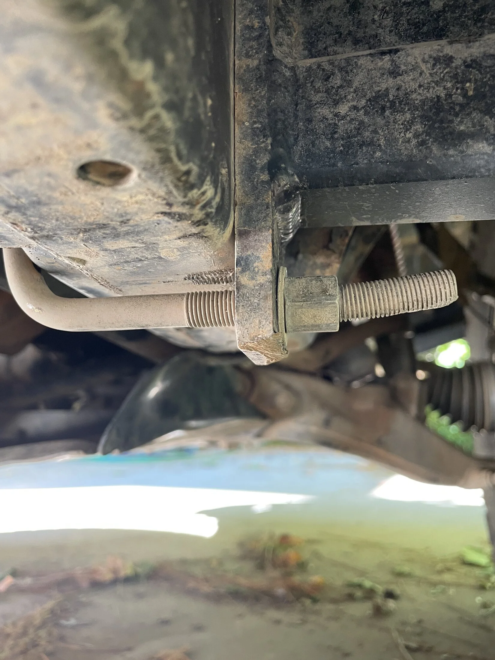

When I finally removed the sliders earlier this year I had to cut the u-bolts off with an angle grinder (see photo below). The threads were beyond FUBAR. There was no point in trying anything else. Multiple times while wheeling I would feel the vehicle getting caught on the slider bracket/leg since it stuck out below the frame rail...back up and bump it baby.
Photo: bent u-bolt with thread pattern indented into the bottom of the vehicle's frame rail

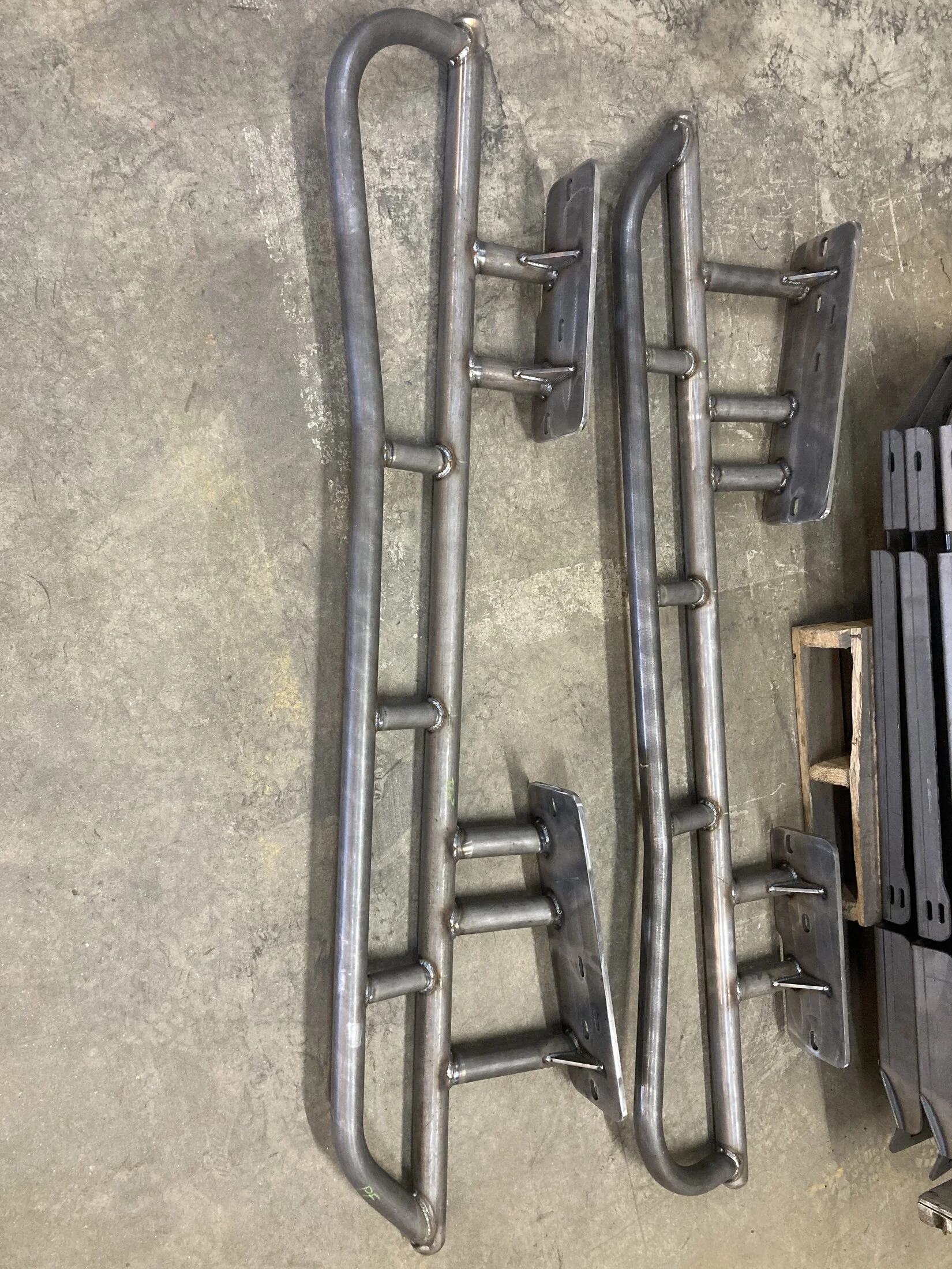

After a 1" body lift I doubt I'll have slider-to-body contact- especially with these new @BudBuilt sliders 👀
No other competitor comes close to the strength of mounting as BudBuilt IMO. After seeing Lee's on his 200 Series I knew I had to get some commissioned by Chip/Bud.

The two posts contacted the pinch weld on the rockers on both sides of my truck. I'll include a link to a YouTube clip showing the amount of flex in the slider in a rather low-stress hit on Wheeler Lake:
Again, not necessarily knocking the white knuckles (or any slider for that matter- some frame to body flex is inevitable with the stress I put the vehicle under). Just thought some folks might want to be aware of these things before they buy.

^^^^This. If wheeled hard, there isn't enough friction between the slider mount and the frame to prevent the slider from 'sliding' vertically on the frame. I've thought two serrated plate washers, one on the slider mount and one welded to the frame could alleviate the problem.... but I never tried it.
Steel Serrated Plate 1/8 Increment 2X6X1/2 With 1/2 Slot – Illium  Industries
My u-bolt sliders (not WKOR). Broke the U-bolt even.... and you can see the indentions on the frame when the slider rides up.
If you wheel "hard enough" you can break anything, including the frame. Having bolt on armor gives you planned failure points. I'd much rather have a broken U-bolt and even a bent/broken slider than a compromised frame!
True... but we haven't seen any/many folks damaging frame due to slider impact. So, I think the fuse is underrated. Plus the 100 frame is wider than any prior LC frame, therefore there is less leverage.
