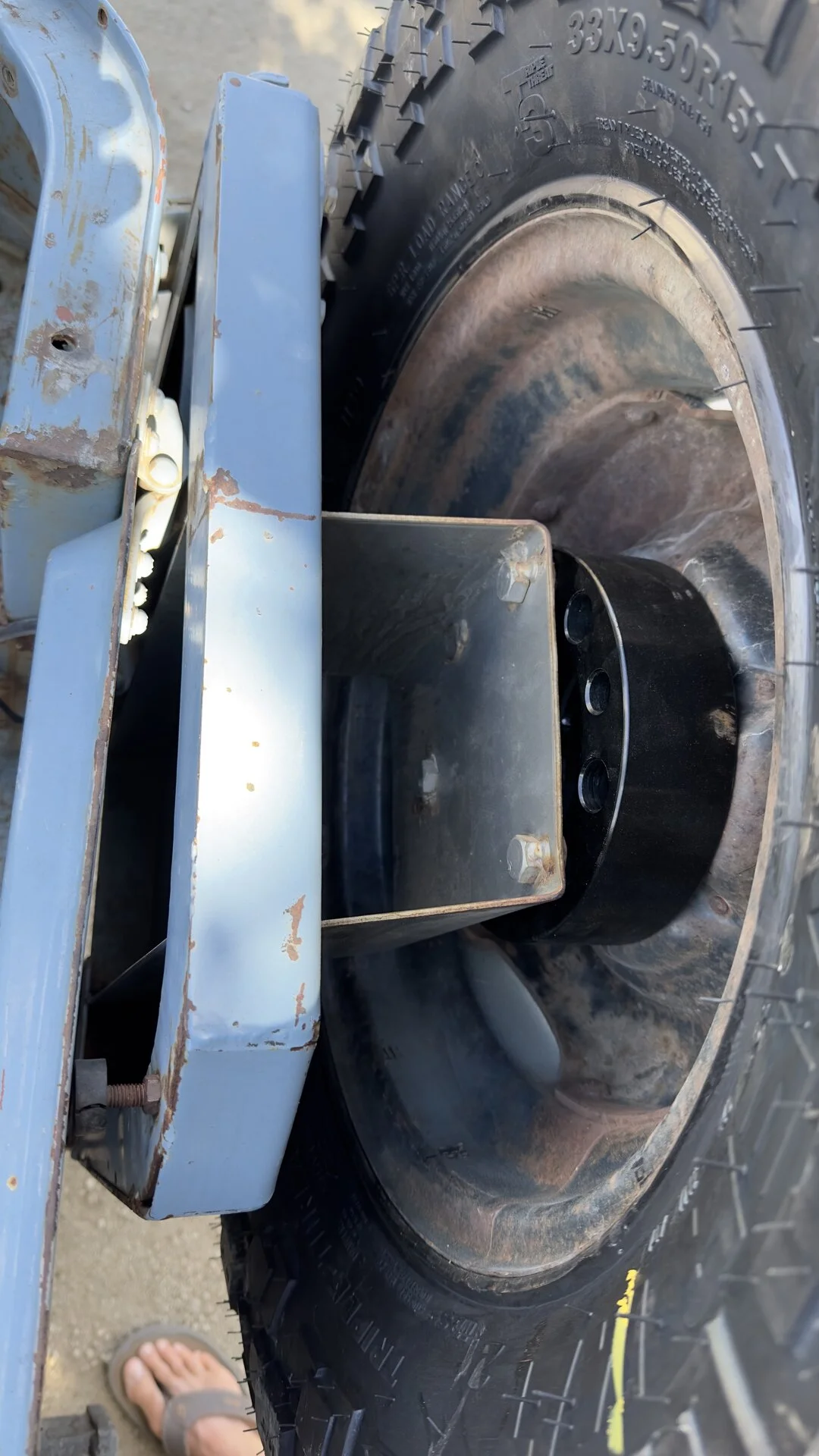

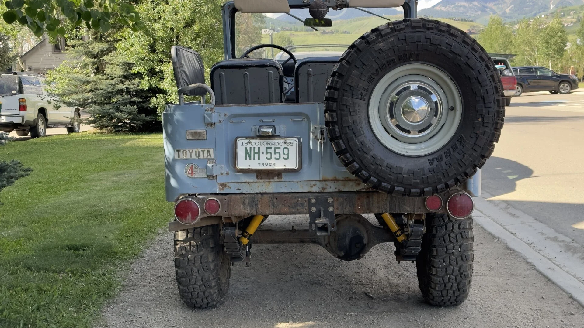

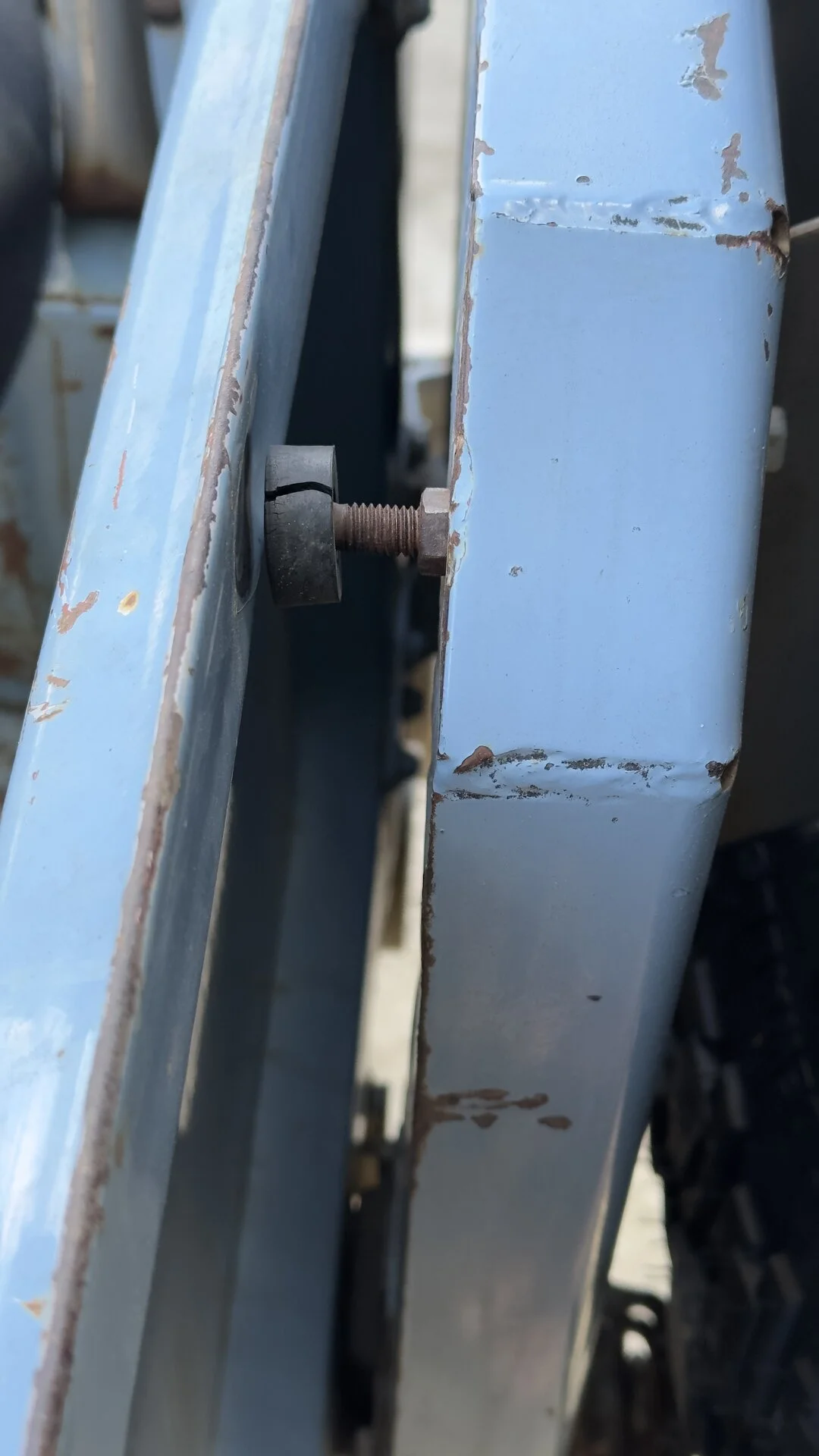

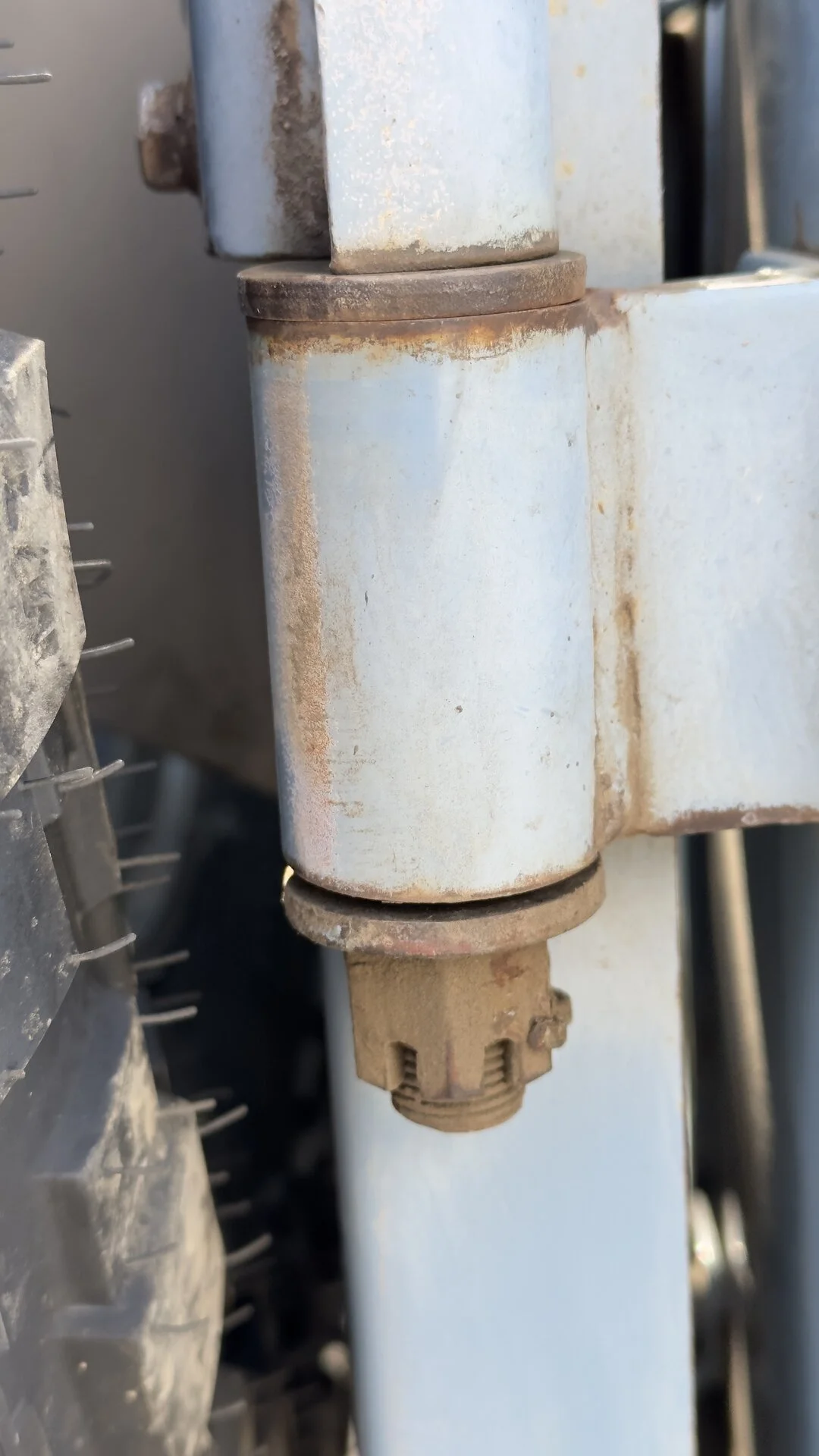

I just made the move from little old stock tires on my '70 FJ40 to 33" Kenda Klevers, and as soon as I put one on the spare carrier I questioned my sanity. First off, thanks to @zerotreedelta for the spacer- the tire is in the right place on both axes. It's just so damn heavy and there's a ton of play in the carrier (spacer is solid).
My question is: if the stock carrier is tightened up and the slop is removed, do you think it would be strong enough to hold this big tire (w/spacer adding leverage)? Or is it a doomed mission from the start?
Big tire:
Here's the spacer in place:
One point of weakness- this rubber grommet isn't touching. Will this add much stability if replaced?
Both hinges have play in them. Can they be refurbed/new gaskets?
I know it's hard to say, but that's a lot of work to put into the stock carrier (also needs a new stud to the spacer) and if it's a fool's errand to begin please tell me.
