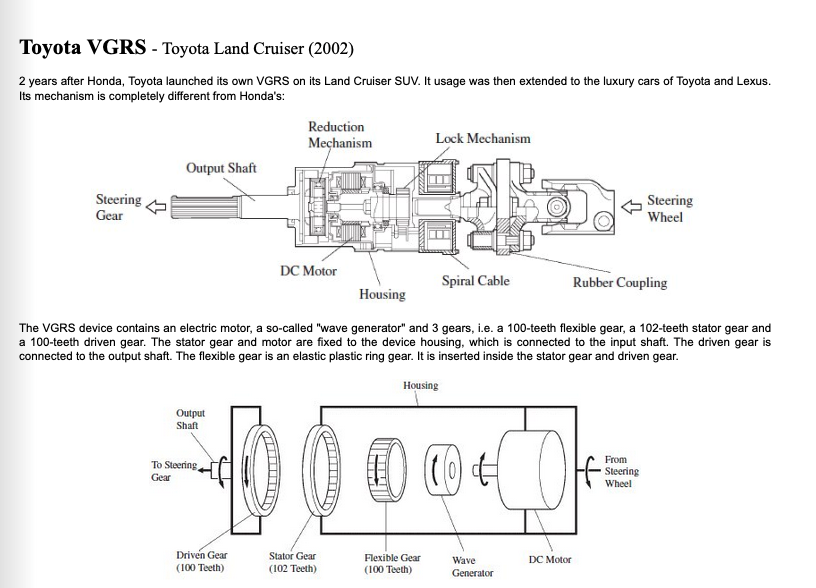

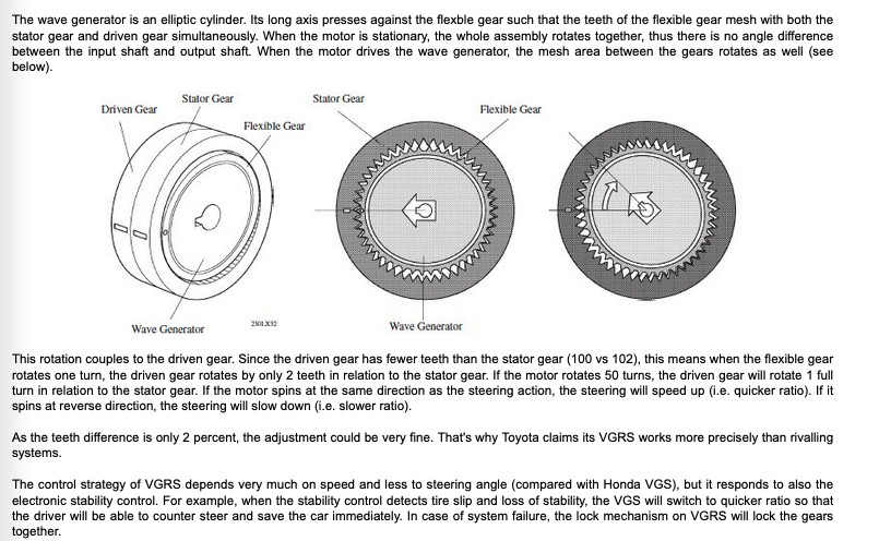

Does the VGRS motor act as a force contributor or simply a ratio multiplier? My understanding is the latter; assist is via the hydraulic pump and wheel:rack ratio by the VGRS. If this is the case, then a disabled VGRS motor (one that doesn't amplify steering inputs at low speed) should result in easier (lower effort) low speed steering as road wheel angle isn't being amplified by VGRS.
Sorry perhaps I need more coffee this morning. But I'm unclear on what you're saying:
"assist is via the hydraulic pump and wheel:rack ratio by the VGRS"?
"a disabled VGRS motor (one that doesn't amplify steering inputs at low speed) should result in easier (lower effort) low speed steering as road wheel angle isn't being amplified by VGRS." The Lexus VGRS while active, makes steering easier. So why would the system while off or in fail-safe result in steering easier?
The way I read it, the VGRS actuator does nothing to contribute to steering force. It only changes the ratio between the steering wheel and the rack. The hydraulic pump feeding the rack is where all of the assist comes from.
A functional VRGS increases rack movement at slow speed. At slow speeds, for every degree of steering wheel turn the road wheels turn a greater degree (vs non VRGS). So there is decreased leverage between the steering wheel and the rack. The decreased leverage should result in an increase in effort when VGRS is engaged. That is if the hydraulics can't keep up such as with a non-standard LC rack, oversized tires, etc.
VGRS doesn't make steering easier (less effort), it makes steering faster. The hydraulics are what reduces the effort.
So in the case of a failed VGRS, there would be no increase in slow speed steering and the ratio should stay static. Which is why I'm questioning the statement that a failed VGRS would result in increased steering effort.
Well written and a good point!
Perhaps I misreading the sells literature statement: "VGRS changes the gear ratio – not just the amount of power assistance – to an optimal level for all conditions."
