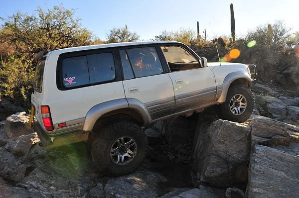

the color is white with the lower grey color.. has the sunroof and roof rack..
Wow, repaint, flare change or did you mean to say ghey color?:D I have only seen white LX's with that :princess: ugly gold color like mine?
