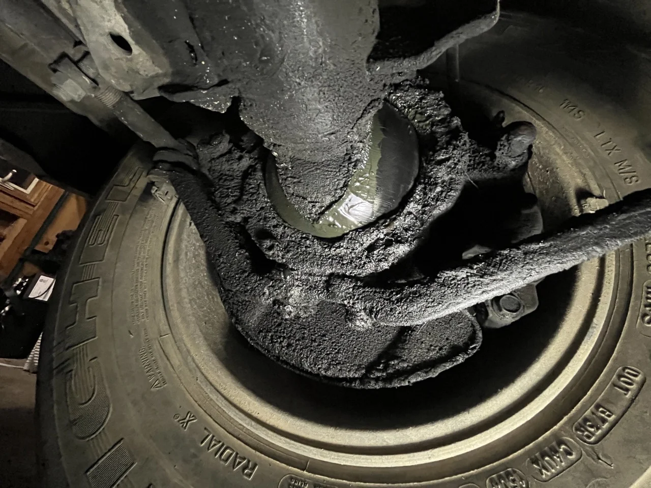

You got me curious so I went ahead and took some photos for all of you that love some trauma shots.
Heres the knuckle. The bolts seem snug but there is a serious play in the wheel when jacked. I am betting it needs replacing haha! I am supposed to get an alignment with my new tires tomorrow - probably worth saving the $90 until I get this taken care of, no? Will be calling around tomorrow for shops that can handle this. Anyone with shop recs in the central cali coast feel free to holler at me. I'm betting the bay area is likely to be my best bet, though its a couple hours north...

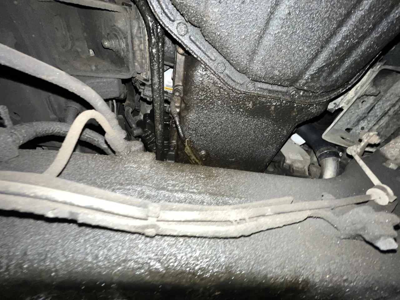

This is from under the front axle/ oil pan. Wishfully thinking its just old grease from the Valve cover job (10k miles ago) which was the 2nd in the past 50k or so - they must have not done a great job the first go around. However, I realize there could be more than one source.

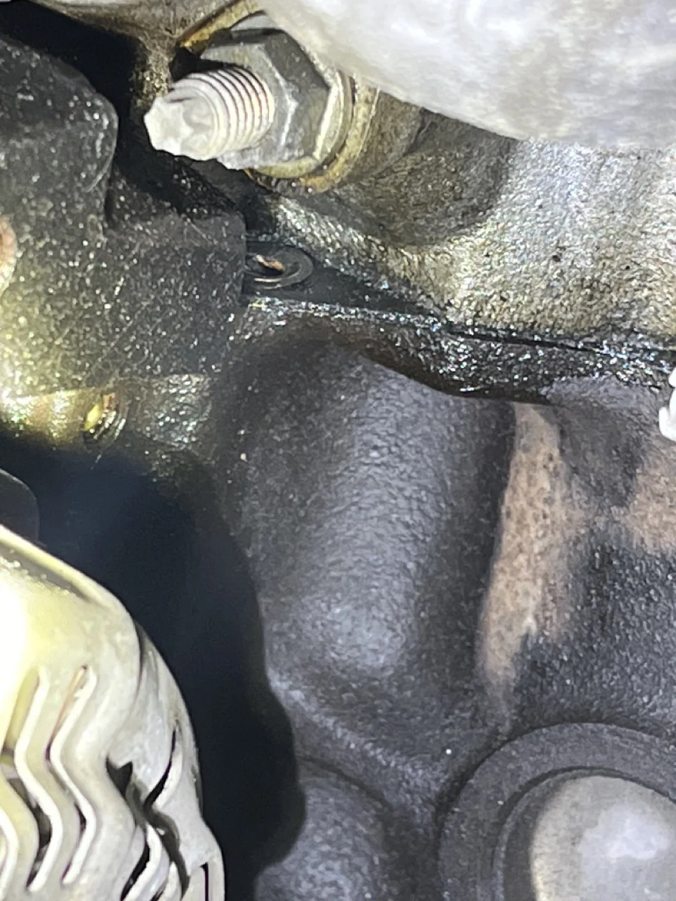

Currently, I've traced a potential culprit to this seep leak which looks like the head, its on the driver's side front corner of the block. Hard to tell in the photo but it looks like its most wet under that bolt in front of what looks like an empty fastener hole (something I should be concerned about?)

At any rate, there are definitely some problems that need solving here. I will give her a solid bath in the next few days and may put some leak detector in the oil to see if i have anything serious going on. Thoughts?
That knuckle is well due for a rebuild, I’d do them both. It’s going to be expensive for someone else to do them, sounds like you have the garage space so I’d say it’s time to get dirty; like real dirty. I wouldn’t be driving it with wheel play, is it 12 & 6 o’clock or 3 & 9 o’clock play. Odds are that you’re tearing up a spindle if it lose wheel bearings. A first timer can do it in a weekend assuming you have your parts and tools ready.
Its both, like more than a quarter of an inch in both directions. It does seem straight forward and I am about to rebuild a hub on a trooper, just trying to keep one car on 4 wheels 😂.
A picture from a bit further away would be nice to get an orientation of the photo you posted. On that side of the motor and if it is higher up there are really only two culprits (distributor o-ring or valve cover). Would concur about cleaning it, that way you ascertain where the leak is originating. Also, you will appreciate cleaning prior to the knuckle job since it is inherently a dirty job and removing some of the excess grease and road grime will just lend to a more efficient R&R.
Yeah - it was late and my better light was deep in the 4runner above the diff as i have the remnants of a seized abs sensor there 😂. Will work to get some better shots.

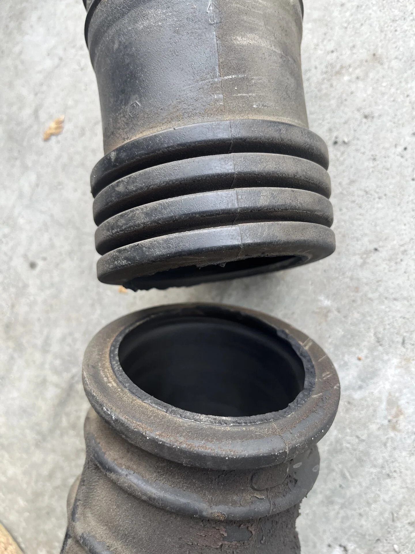

Anyone have advice on intake hoses? I went to pull mine to do my Spark Plugs and it was solidly seized on there. Went to pull it and it just ripped right in the center of the hose. Time for a replacement! Where's the best value/deal?

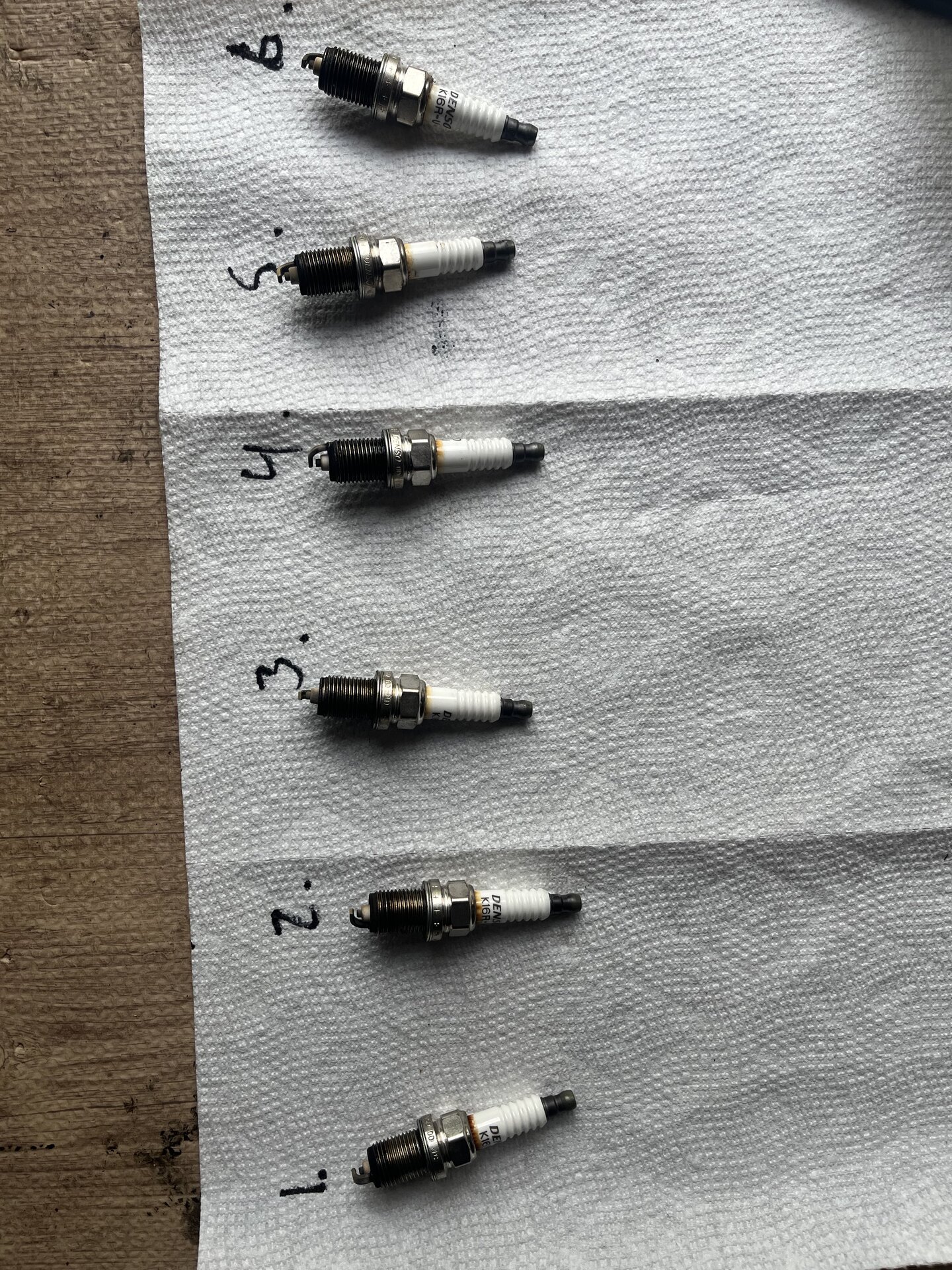

On the Spark Plugs - went with the Denso Iridium 16's. Still new to analyzing plugs. Any thoughts on spark plug wires? Stupidly didn't buy them when I bought the plugs.

Any dealer can get you a new intake hose. I ordered mine off an ebay seller in Japan for a good discount.
Toyota plugs are gawdawful inexpensive and work well.
Any metric bolt will work fine for your abs sensor. I stock a variety of jis flange bolts for occasions like that.
The oem spark plug wire set is worth paying for. I'm running some densos that work fine, but they're not as perfect lenght as the originals and don't come with any of the cable management bits the oem ones have.
